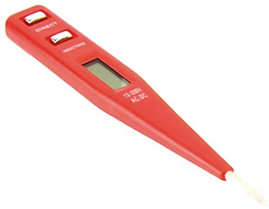

Volt pens aren’t the most reliable. I once isolated a circuit, proved dead properly, used a volt pen and it lit up like it was live - I’d double check it, if I were you. £30 for a pcb - eBay by any chance?
sorry its not a volt pen. its a Preptec AC DC 12-250V Voltage Tester Detector. it detects the volage, 240v etc....
i just used a multimeter and it shows over 200v

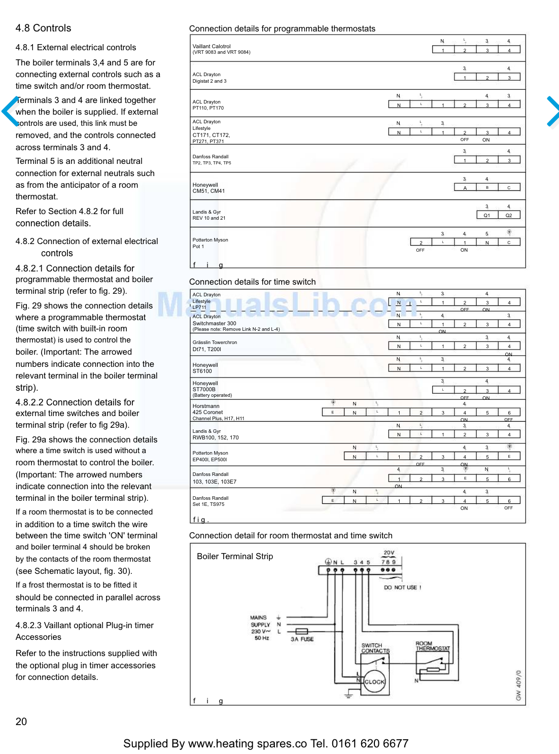

I really did the wiring correctly as posted yesterday. I tested it with my meter. 3 and 4 to new stats... every thing perfect as what we said...
the setup i did for the new thermostat supposes to have worked and didn't... i really think there were problems with the PCB neutral terminals and switch terminal 4...
Hi
Just found the manual online...
Looks like we got the wiring correct.

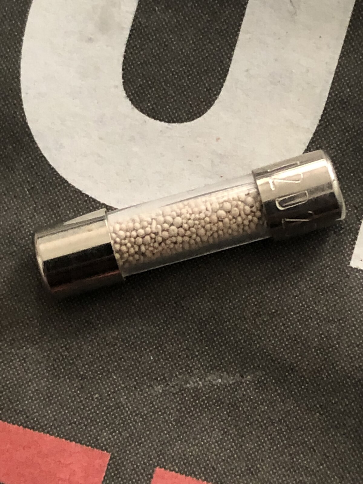

I went back to my Dads to check the PCB fuses.... i used my multimeter and one was blown.. but didn't look like it... also, before, i changed all fuses with the spare fuses that were plugged onto the casing.... so i must have switch the blown fuse with spare blown fuse!
Some idiot 10 years ago connects live to neutral!!! see pic below! why!!!
I fixed the wiring and works...
Cancelled the PCB purchase, all works..... connected my thermostat, all works!.
Thanks everyone.
The question, whats the name of these fuses and which amp? they look different...
see pics..

Hi, i have just bought a similar thermostat please confirm that it works with
Boiler 3 (L) to New Stat 4
Boiler 5 (N) to New Stat 3
New Stat 4 (L) connect to New Stat 1
Boiler 4 (SL) to New Stat 2
