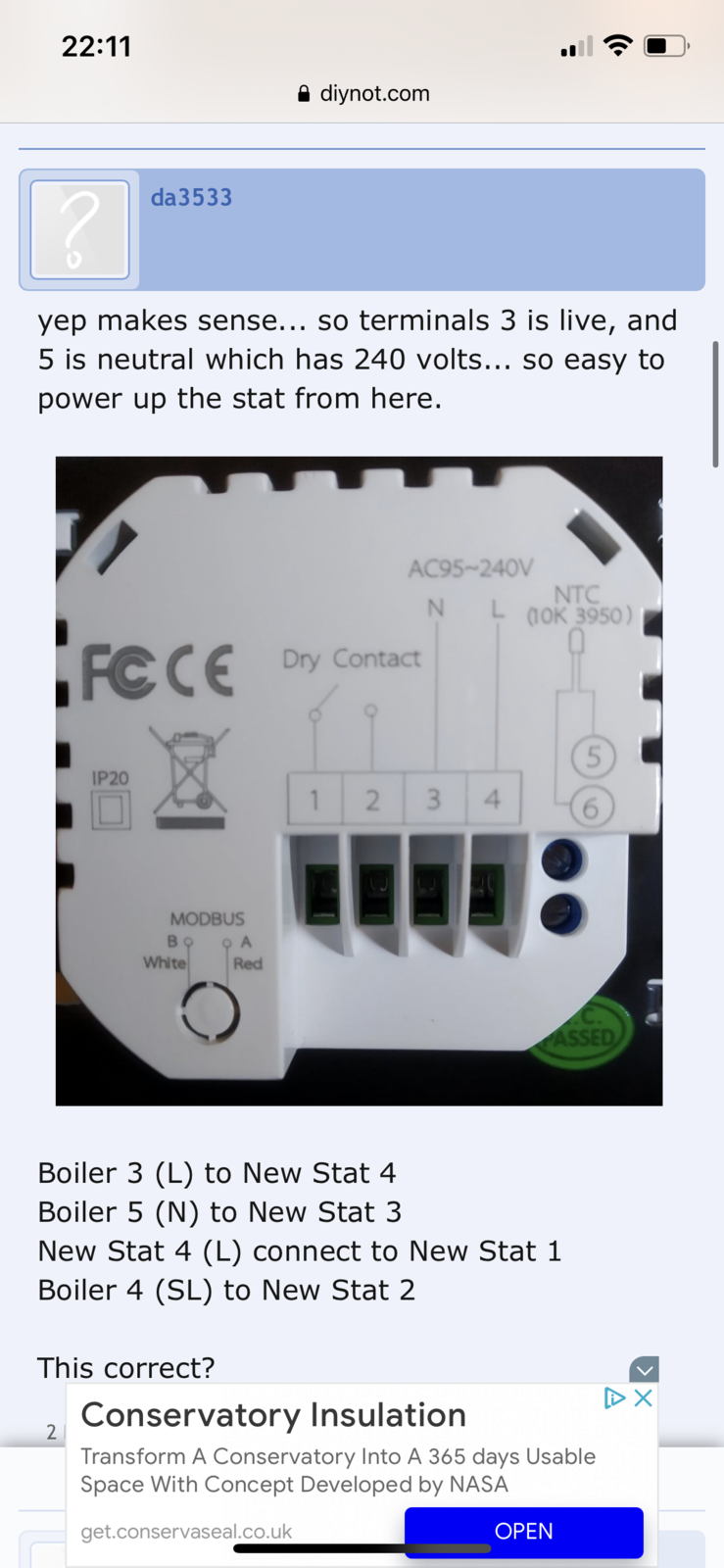

my set up is exactly the same as the op, i just wanted to confirm that in the end this worked for him?
Boiler 3 (L) to New Stat 4
Boiler 5 (N) to New Stat 3
New Stat 4 (L) connect to New Stat 1
Boiler 4 (SL) to New Stat 2

You dont understand , the origional OP didnt, he had origional installation issues, , but if you dont want the correct advice then that is fine, some people cant be advised
The op did find the answer didn’t he? I have attached the bit where it worked i just wanted him to confirm!
