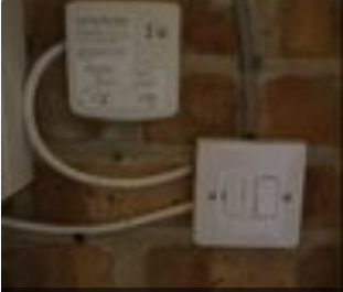

There are two switches in your post #8 pic: a button-operated one on the wireless receiver (top left) and one on the FCU (bottom right). Which one do you mean?
Have you paired your thermostat with the receiver?
Do you have a remote control for the boiler?
The fcu one won't switch, I can't pair anything to the boiler if no power is going to it and there is a remote for it in the living room I have no idea what the previous owner did all the wiring seem fine.
But no current is going through
Sounds like a broken switch and the FCU needs to be replaced.

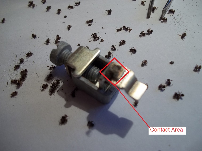

This was a contact in the RCD that supplied power to the village Christmas Tree and Santa's Grotto. The RCD was full of ants.
The supply was OK when tested the day before the offical switch ON but was less than 50 volts when the Grotto was connected and the RCD was switched ON The RCD did not trip OFF. The ants that had been between the closing contacts were squashed and cremated and created a resistive path between the contacts.

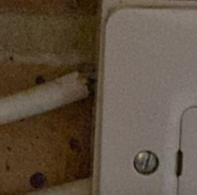

I look at this
and alarm bells ring. Not saying that is the problem, but if the installer is so shoddy with their workmanship that they don't use cable clamps to secure the cable where it can be seen, what is it going to be like where you can't see it?
