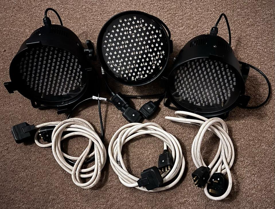

On Ebay right now
E bay came back and said it's not in violation of our policies so we will do nothing despite me appealling the first decision. So I can only assume that who ever looked at the ad also couldnt see a problem despite me pointing out exactly what the problem was....

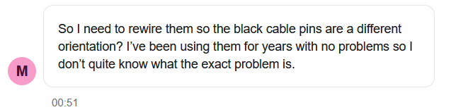

I also messaged the seller advising him of the dangers and this is his reply (after pulling the ad).
Ahhh so I need to swap the plugs over. That’s cool cheers for the info and I’ll get right on that. I had no idea as I I’ve been using them for years as they are with no problems. So basically I don’t need the white cables? Just use the 3pin plugs from them and put them onto the black cables? Cheers
So he clearly does not understand electrics at all.

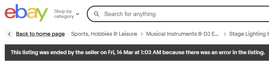

However the ad is removed for now.
I have explained how to swap the connectors over, whether he does it right or not is another matter.

We'll find out when they are relisted
