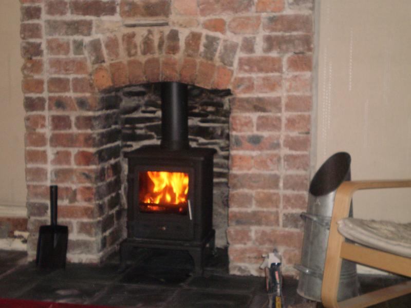

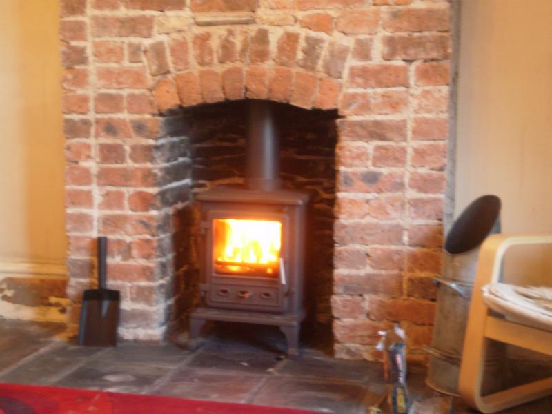

I've been thinking about this for a while, and today at 1pm I decided to rip out our ugly fireplace ot make way for a MF stove. I want the chimney breast to be exposed brick, so there was a lot of grinding / chipping of the plaster off the wall.
Before
After a bit of crow bar action
After tile surround removal
Then the boring plaster stripping process
I used a grinder with a wire brush attachment to bring off the main plaster remnants.
I just need to work out what else I can do to 'liven up' the look of the bricks
The stove has been ordered and should arrive this week. I have decided to make my own register plate as they are bloody expensive!!
EDIT: And I also decided to rip up the carpet and found perfect condition wooden floorboards, so they will be getting a sanding as well :D
Are you installing a flue liner ?
Still deciding to be honest. The chimney is sound, but I know for a fact that it will run more effiecently with a liner. I dont know whether to just try it without at first and see how I get on. The stove arrives tommorow , so I'l set it in place and see what solid flue length etc I need and take it from there.
Cheers
I asked because I've been thinking about one myself and most of what I've read states that they burn a whole lot hotter (forget numbers but something like 2 to 3 times) than an open fire. So a chimney that is OK with an open fire, may not be with these very hot gases, could lead to leaks and worst of all fires. So not sure if your 'try it and see' strategy is best..
From what I have read you have it back to front Bathjobby. Stoves send 80 % of the heat out into the room, whereas open fires send 80% up the chimney. Its the cooler chimney which causes tar build ups apparently. These tar build ups are more likely to appear with a stove/no liner setup.
On saying all of that there are people all over the net (and some on this site) that have used a stove without a liner for donkeys years!
CO KILLS carbon monoxide is the silent killer
i would recomend you use a liner!
if not
Why not get advice first from the shop where you buy the stove or a registered HETAS installer.
As for size of your opening hope this helps
1) Register plate must be 1.5mm steel and needs to be sealed so that it is airtight so no smoke can come back into the room
2) you must have a gap of 150mm each side of stove to non combustable sides
3) You must have 230mm above the stove to non combustable (460 above the stove for combustable i.e. wood)
4) You must position stove 50mm from back wall
5) your hearth must extend at least 225mm in front of stove
6) if your stove has a grater output than 5kw you must have air ventilation in the room venting out to external source
Hope this helps a little but its your safety
regards jay

Hi Marshman,
Initially no, but I didnt have a plate sealing off the cminey around teh flue , so essentially , as with an open fire, the heat was screaming up teh chimney instead of into the room. Plate fitted and yes it is much better than the open fire that went before it. Well worth the £300 !
Thanks for that :)
Still some pointing to be done, new wallpaper either side of the breast, sand and stain the wooden floor and finish stripping the 12 inch high skirting boards!
The property is about 150-160 years old so it seems in keeping, rather than the 60's - 70's fireplace that was in there beforehand :confused:
