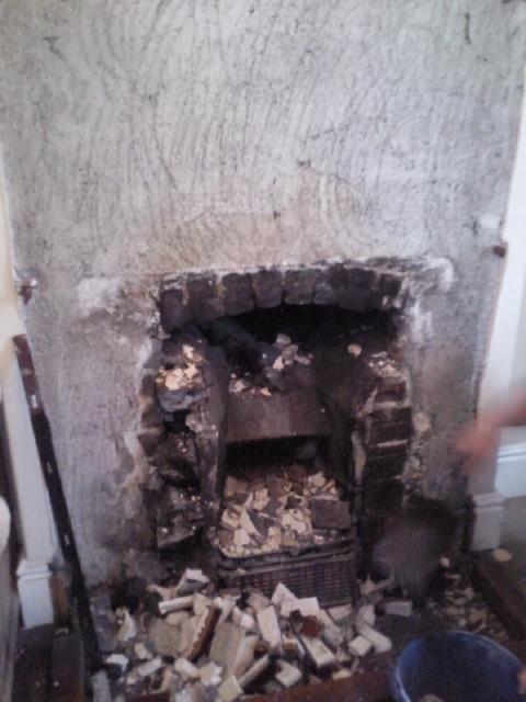

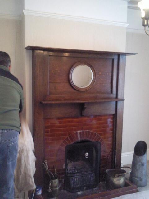

I've been thinking about this for a while, and today at 1pm I decided to rip out our ugly fireplace ot make way for a MF stove. I want the chimney breast to be exposed brick, so there was a lot of grinding / chipping of the plaster off the wall.
Before

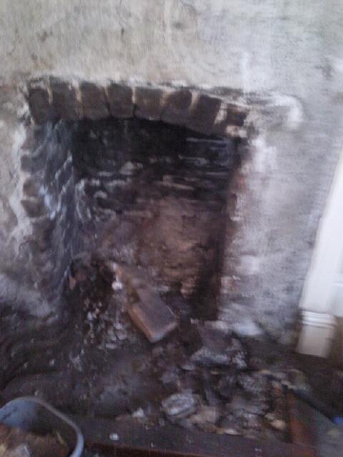

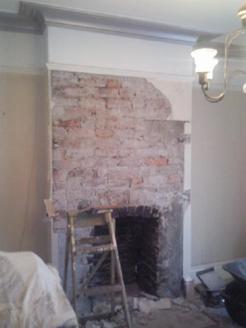

After a bit of crow bar action

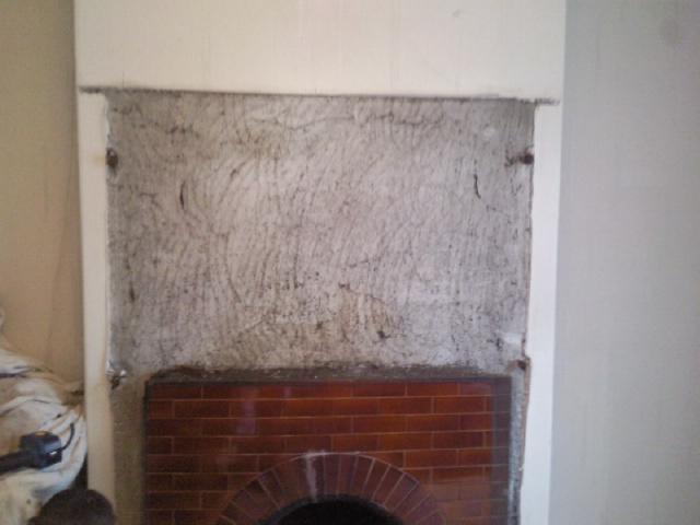

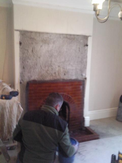

After tile surround removal

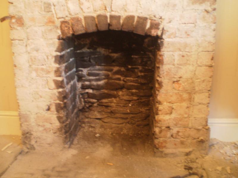

Then the boring plaster stripping process
I used a grinder with a wire brush attachment to bring off the main plaster remnants.

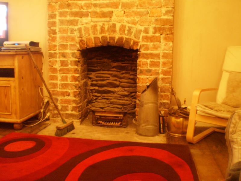

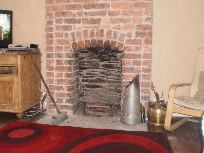

I just need to work out what else I can do to 'liven up' the look of the bricks
The stove has been ordered and should arrive this week. I have decided to make my own register plate as they are b****y expensive!!
EDIT: And I also decided to rip up the carpet and found perfect condition wooden floorboards, so they will be getting a sanding as well :D
