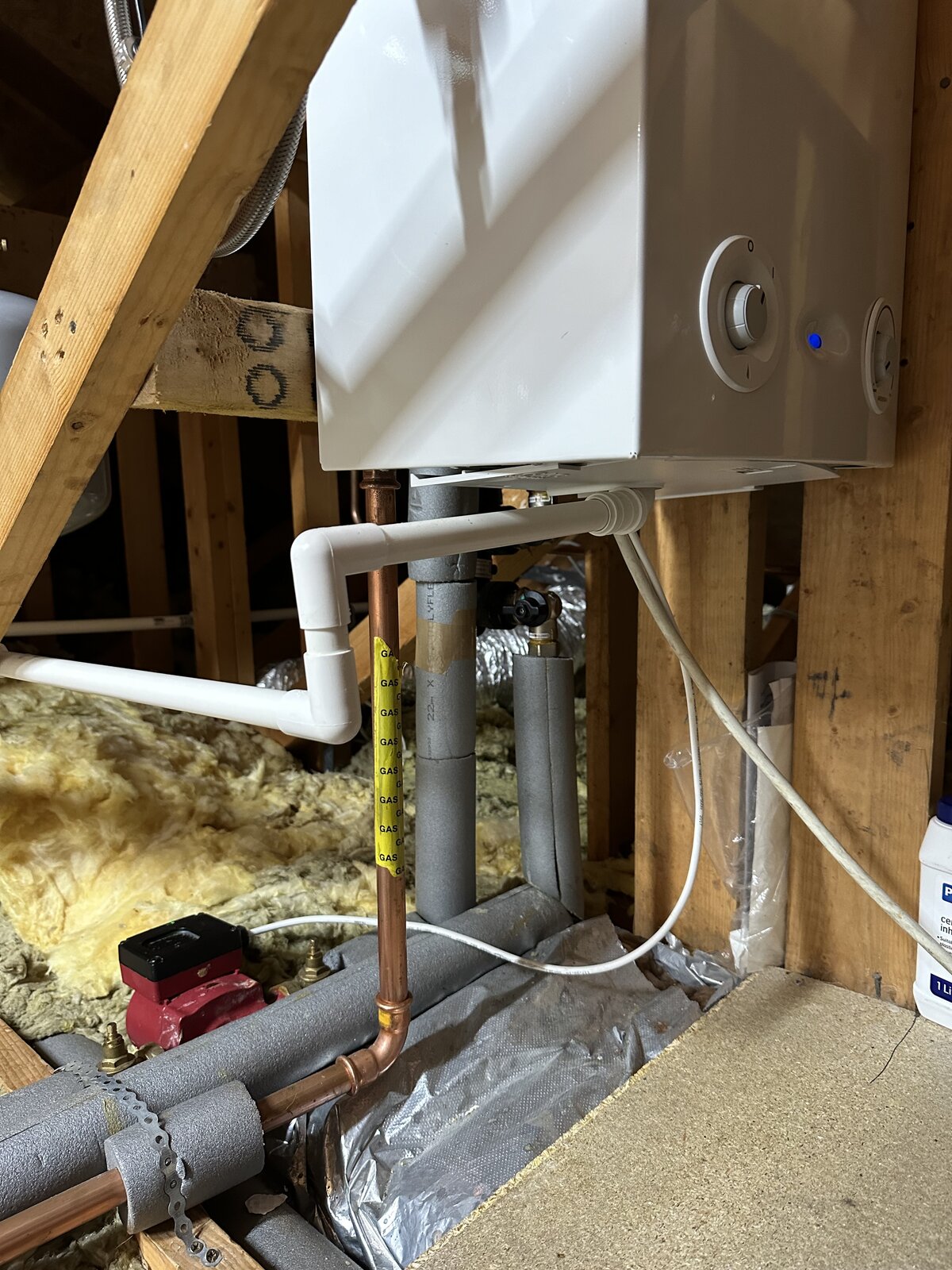

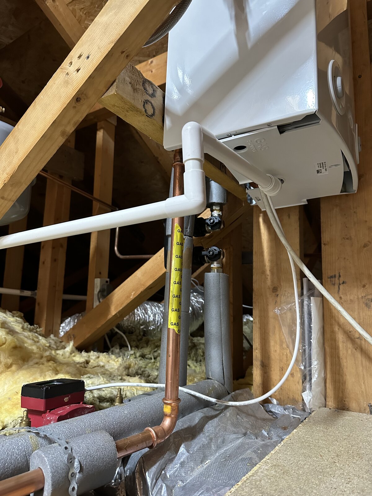

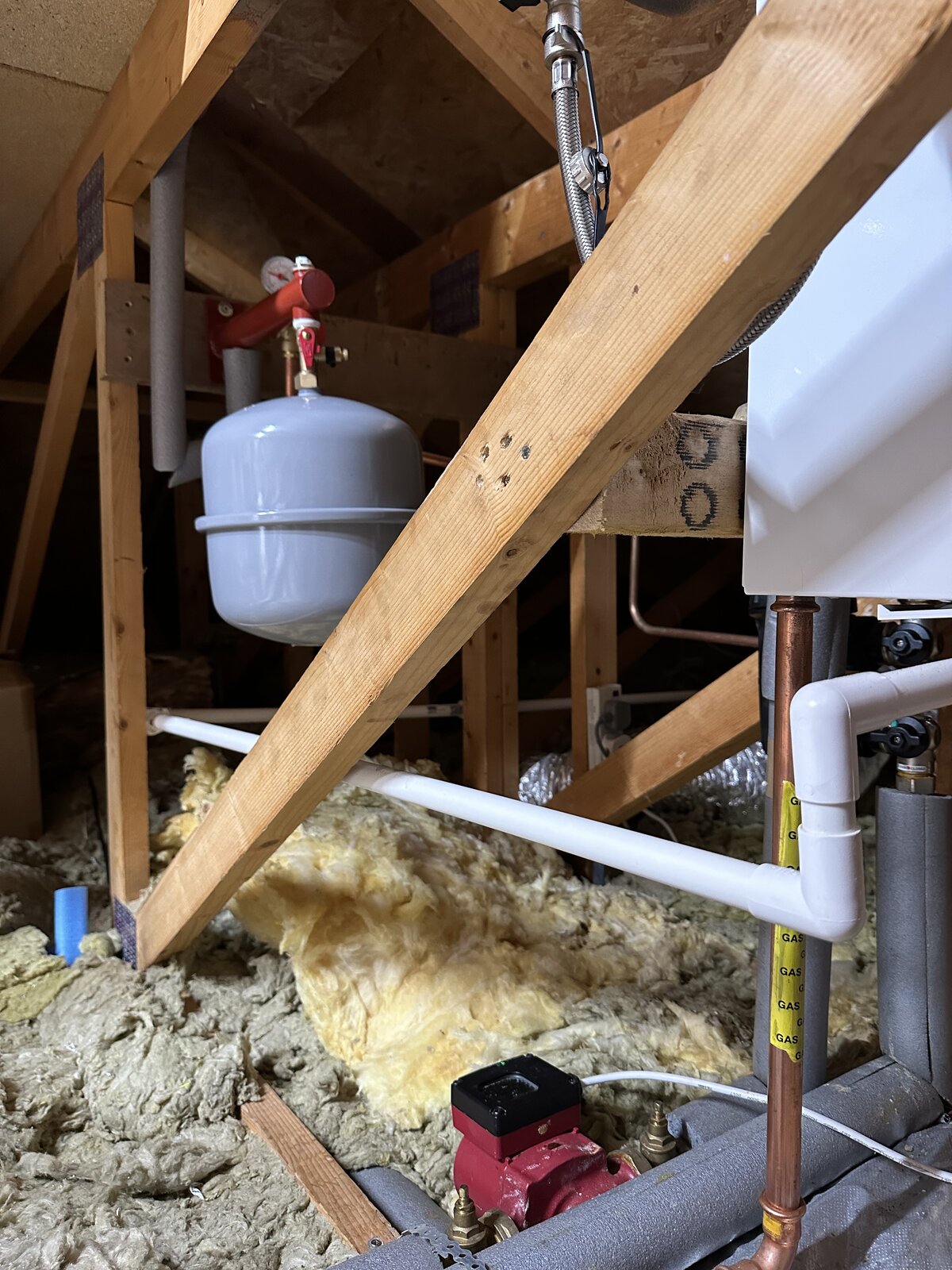

Some photos attached if it helps? I can always take other pics if required.

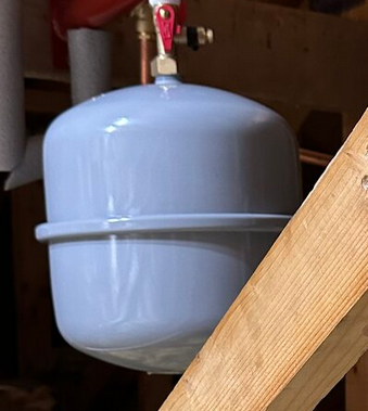

I see the EV water end is on top, have you tried cracking open the drain to check for air, the EV may not have been filled properly on installation although one would think all the air would have been removed by now with all that venting. Do you have to top up each time you vent the rads? Also check that the pump inlet and outlet connections are tightened adequately. Check that the EV is teed in before the pump inlet.
What model Grundfos and what is its mode and setting?, ensure its pumping in the right direction.

If the diaphragm has failed View attachment 350375 you will never win. As to how to test, sorry, not a clue.
It was only fitted around 6 months ago - my problems exist before and after fitting. The system holds pressure - the only time pressure is lost is when I vent the system - I then have to refill it.

Is the pump on the boiler flow?.
Also tighten up the pump isol. valve gland nuts.

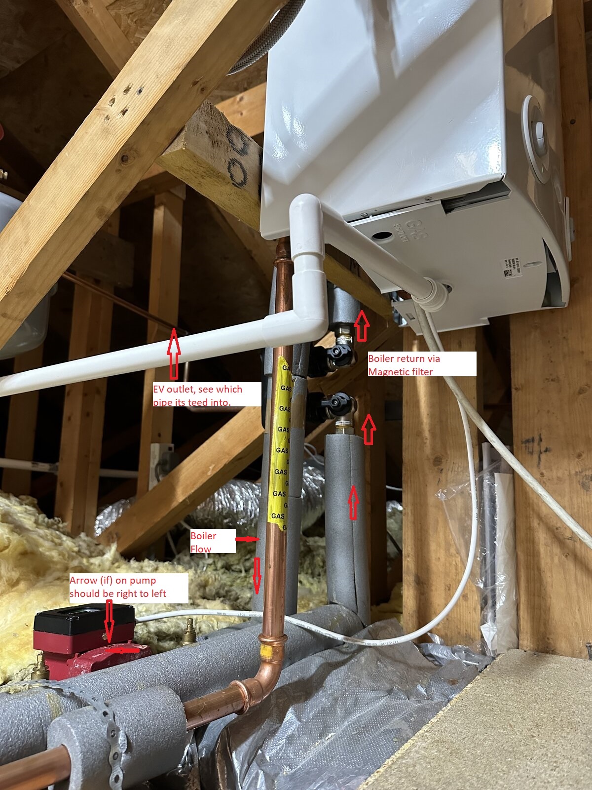

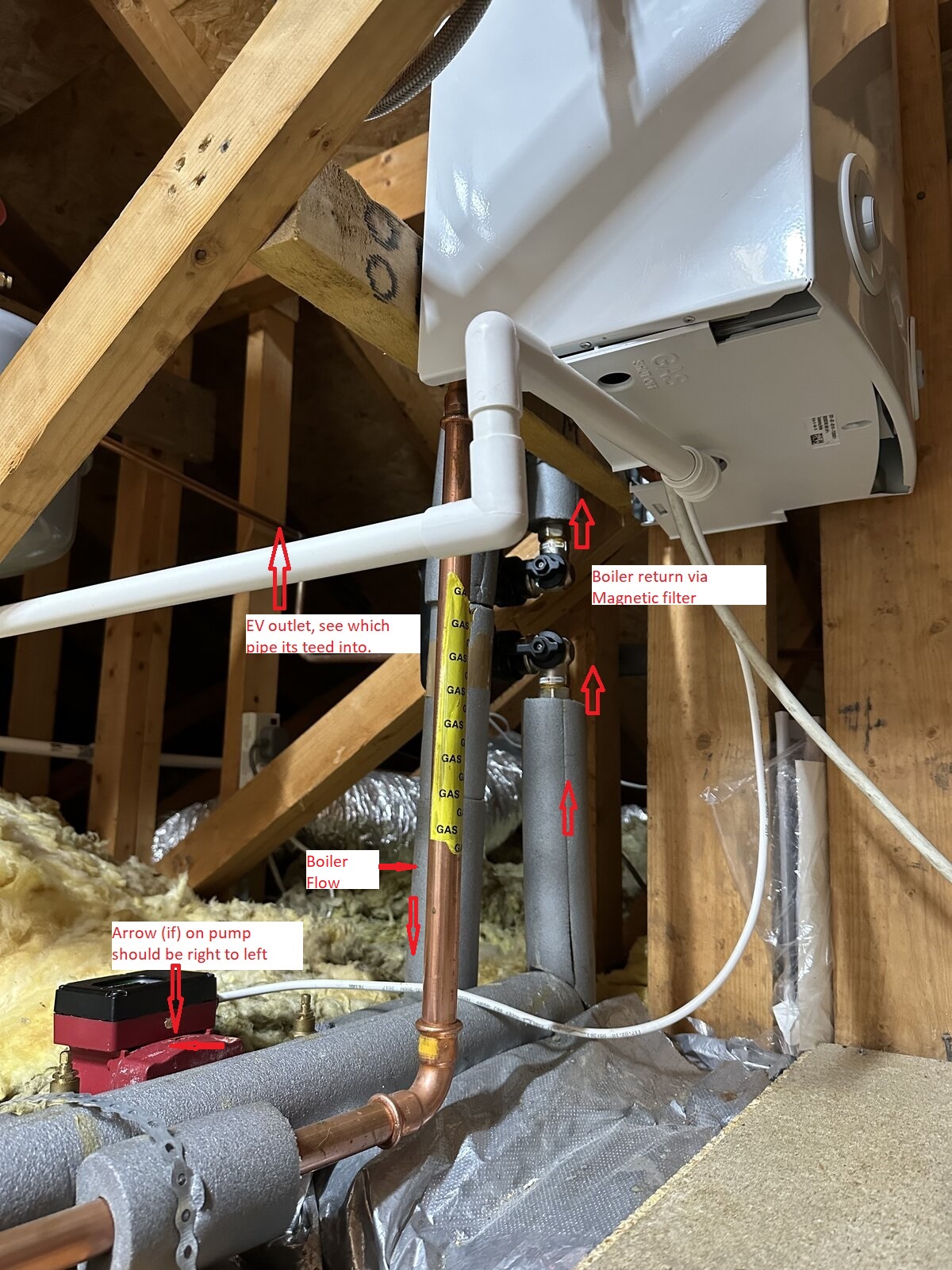

Follow the pump inlet back to the boiler your manual wll then show which is the boiler flow/return.
Edit: Its on the flow because I can see a magnetic (isolating valves) filter on the other pipe under the boiler, the flow pipe should be the hottest pipe, check for a arrow on the pump body pointing from right to left and check that the EV outlet is teed into the pump inlet, ie, somewhere on the right hand of the pump.

More food for thought.

Can you do a rough sketch of the layout, with levels? Maybe there is negative pressure at some point, sucking air in.

John,
Thanks again thats really helpful.
I will check the pump and EV later.
I did see that other post about air ingress but disregarded it as I have a magnaclean. However, I will check it - It did come with spare O Rings….maybe time to replace them just in case…
