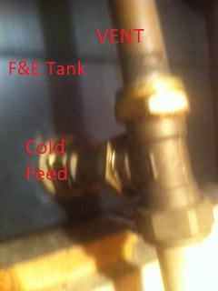

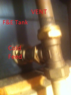

But the sealed system is only installed 6 months!, still ample time one would think for any air to disperse, its a pity (or maybe you did) read some of my posts before you went sealed, re OV systems, I have a OV system installed over 50 years ago with some rads over 40 years old, it has a combined vent&cold feed and gets the (very) odd drop of inhibitor, not a single problem, some who had problems even with the much praised VCP system converted to mine, no more problems.

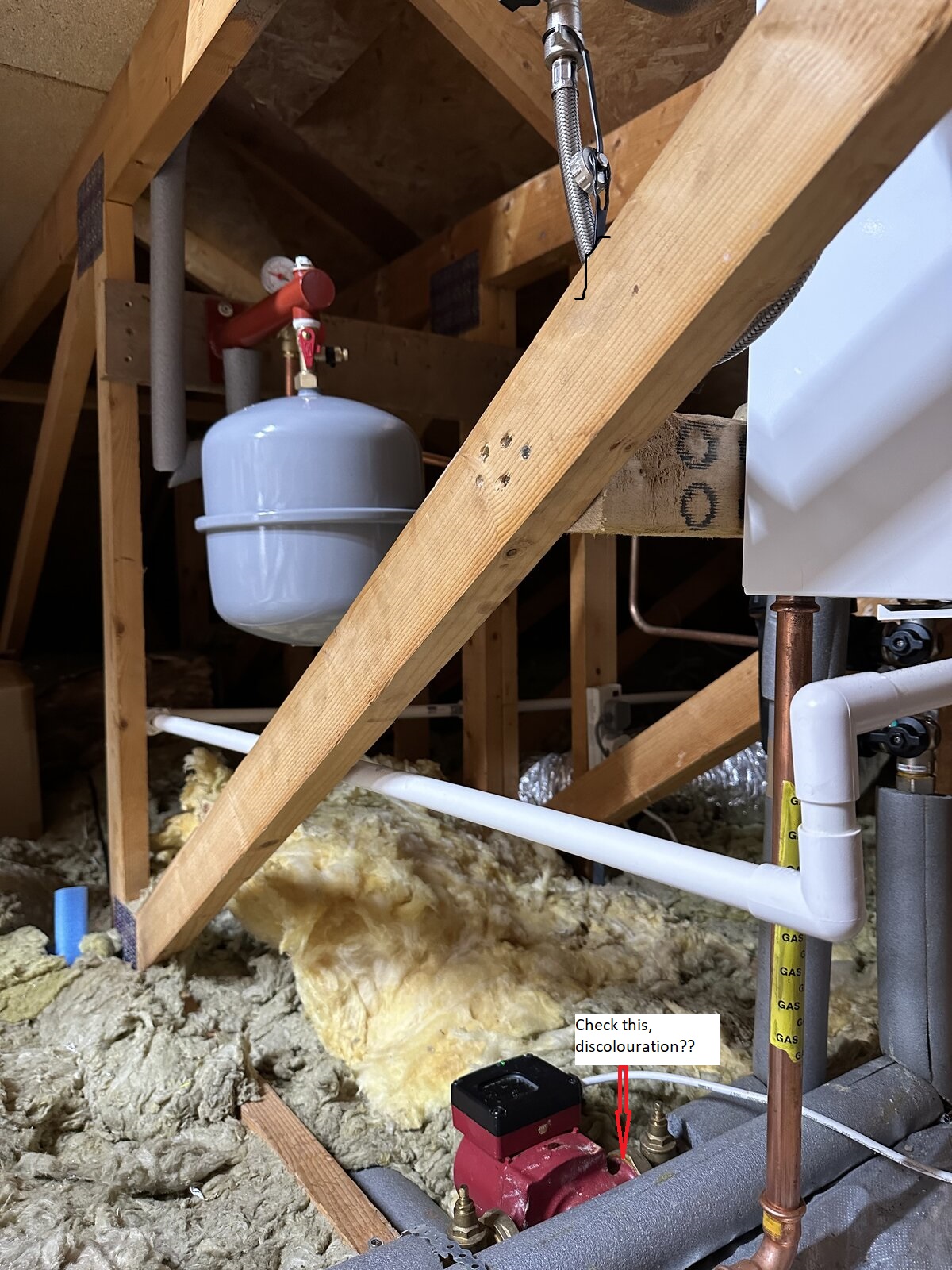

Anyhow, back at the ranch, check your MIs that the boiler flow is on the far left as you look at the boiler, (where your pump is pumping from?), there seems to be slight staining at the inlet connection?, wonder if rubber gaskets were used on installation? which are the best.
Also don't forget to check out where the EV outlet tees in, its surprising, in view of the restricted space, that a heat only boiler was choosen, a system boiler, with integral pump and EV would have been neater, if nothing else.

Also looks like staining near the filter
Not sure how to tell if the pump is on the boiler flow?
Follow the flow (outlet) pipe from the boiler. Does it go to the pump first (with the EV connection in between) then the diverter valve and rads/HW cylinder, or the rads first then the pump?

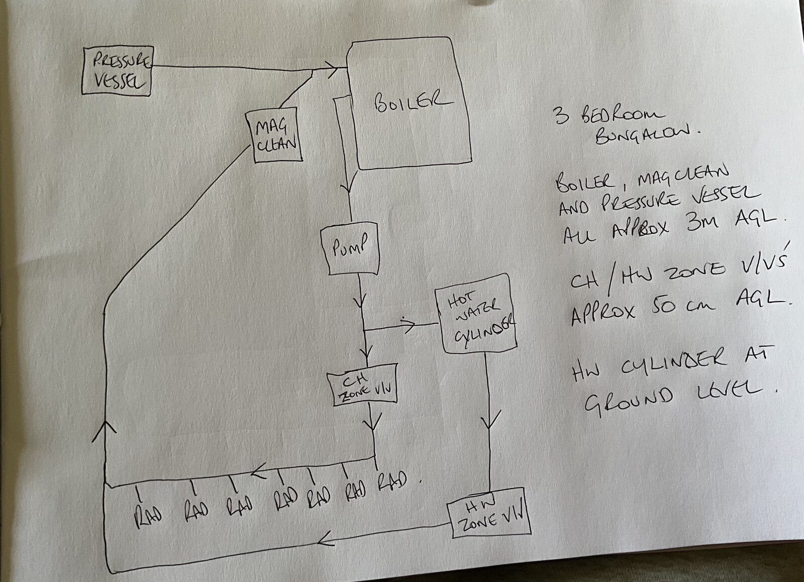

Just for curiosity, how high was the F/E tank before it was removed?
System sketch?
Hi all,
Ok, heres a system sketch from what I can see.
Hope it makes sense, Im no Picasso!
The boiler, magnaclean and PV are all in the loft, approx 3M above ground level.
The pump is a Grundfoss UPS2. Ive checked the compression fittings, all are good and tight. Pump flow is pointing the correct way.
The cold water feed tank was literally 20cm higher than the boiler when removed and pressurising the system.
