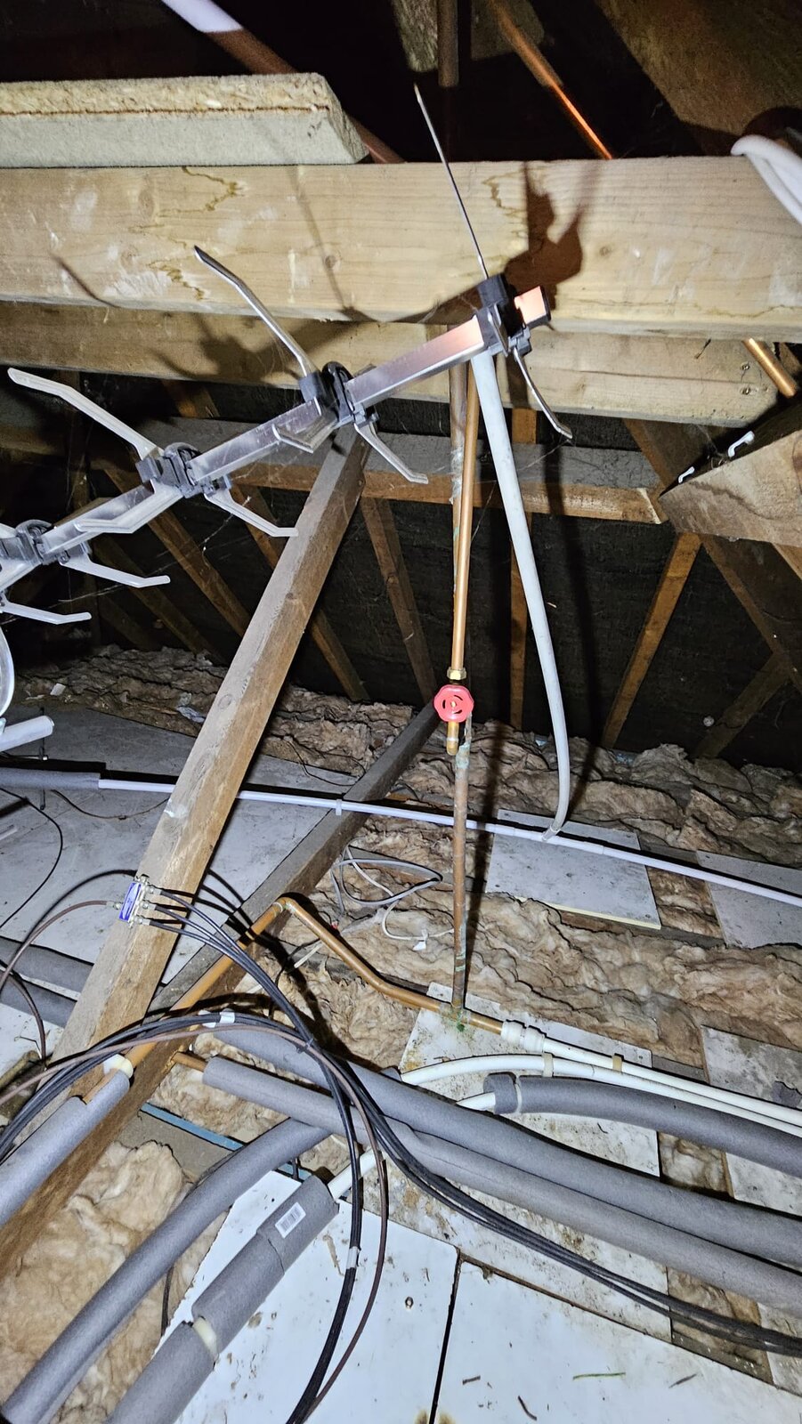

Can you post a photo of this vent?,
I see you have a OV. system, how is the vent and cold feed done, are they on the boiler flow where from the boiler you gave vent then cold feed then pump?

See the vent photo attached with the F&E tank in the background.

Might be worth removing that thumb vent and replace it with a manual isol lever valve and a automatic vent valve (AAV), it can then be easily isolated if it start dribbling, should be easy enough to fit with minimal cistern drain down, it might even be higher than the water level in the cistern?.

The vent pipe is too low, it should be brought in closer to the cistern if possible then extended upwards nearly to the roof top and just turned down like a walking stick handle.
One of the main places where a blockage may occur is where the cold feed is teed into the system, if you follow the pipe back from the pump inlet (towards the cistern) you should come to the cold feed and no more than 150mm further back, the vent pipe, test around these two pipe tees etc with the magnet.

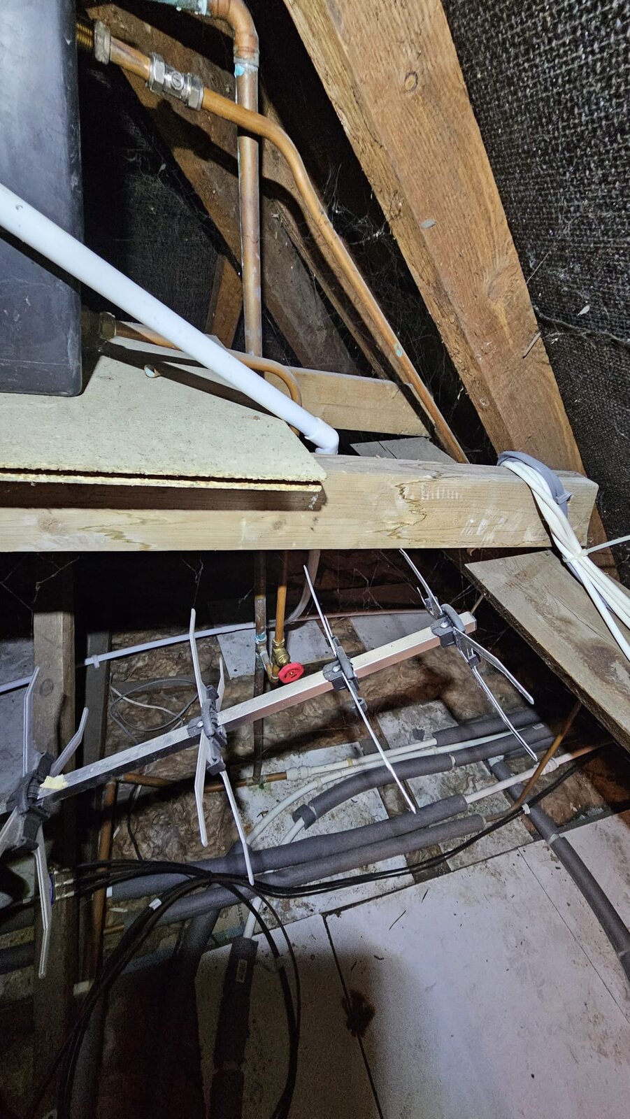

Was that in post 39?? Can you just follow the pipe back from the pump inlet until you come to the cold feed and the vent and post a photo, I cant figure it out from the other photos.

Not my finest portrait but......you can zoom in on it when you open the attachment and get the gist of the VCP system.

See some photos attached.
Let me know it makes sense now.

You will have to look at it really yourself, I'm looking for something like the shetch I posted but it might be some form of combined vent and cold feed like in the attached??
  • Vent & Cold Feed rev2.zip
Yes that is exactly what it is with your descriptions there.
It looks like a combined vent and cold feed.
