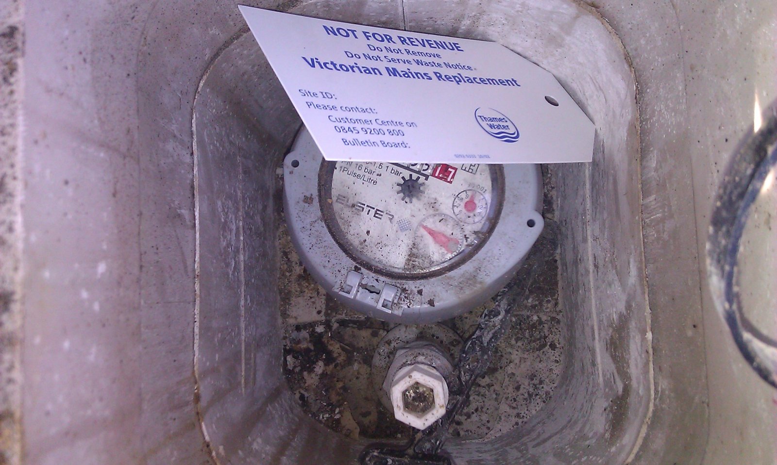

Hi All,
I am trying to open my water meter stop cock, its thesame as the one pictured. Does anyone know how I can open it, I have tried the following to no avail.
Multi stopcock opener Rothenberger Universal Stop cock opener
10mm hex key
The 10mm hey key just turns the top where the screw is, more like its removing the head rather then opening the stopcock.

That hex cap usually unscrews and then a key is inserted to turn the supply off. Give Thames water a call on the number on the tag to confirm before doing anything.

Ahh. so we have been trying to turn the wrong stuff. From what you are saying, the first step is to unscrew that hex stuff, which should then reveal a head that a key plugs into ? Is that correct ?

With some types then yes that small white cover unscrews revealing the tap head below. Always give your water authority a call to check first though as there are different types coming out all the time and they keep changing them.
On checking further on newer models that hex is the tap itself. That should screw down to turn off and screw up to turn on and there should be a black plastic T bar in the chamber to do that but again check with the Thames first.
When i have tried to turn the hex plastic stuff, I noticed that still no water, instead the hex was becoming loose and the screw becoming loose, and everytime that happens I screw it back in to make it tight and not make the hex fall off. So from your first explanation, then it appears that by screwing it back in tight, I am not making any progress, instead going backwards. Also, I have turned the hex with a socket, still nothing happens water wise, so its time to take a plunge and take off the screw/hex head.
It should be a similar hex key fitting below but again, please give Thames water a quick call - it's an 0845 number so will only be pennies, that way they can confirm the procedure to you. With me being back up north now, water meters are rarer, so tend not to see lots of new ones so not familiar with all the newer types hence the recommendation for you to phone Thames to confirm.
If you look there's a black key with a tee head that's the key to put into the White hex then turn it clockwise for off and anticlockwise for on.Bob

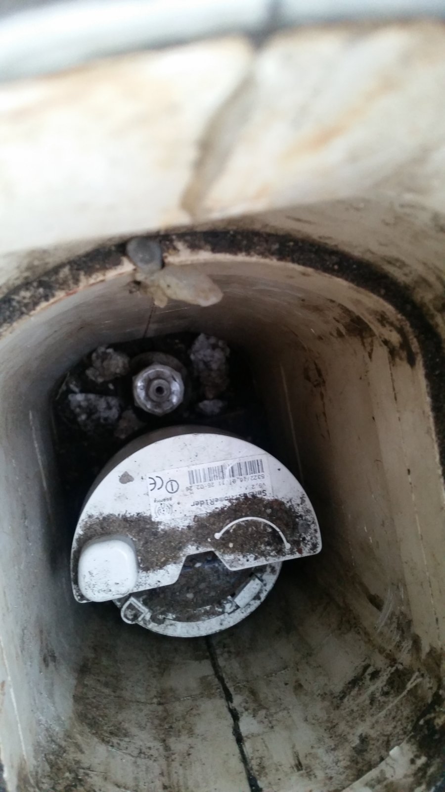

I unscrewed the cap today and did not see a place to put a key. Please see picture. Neighbours don't have same meter and some don't have a key.
