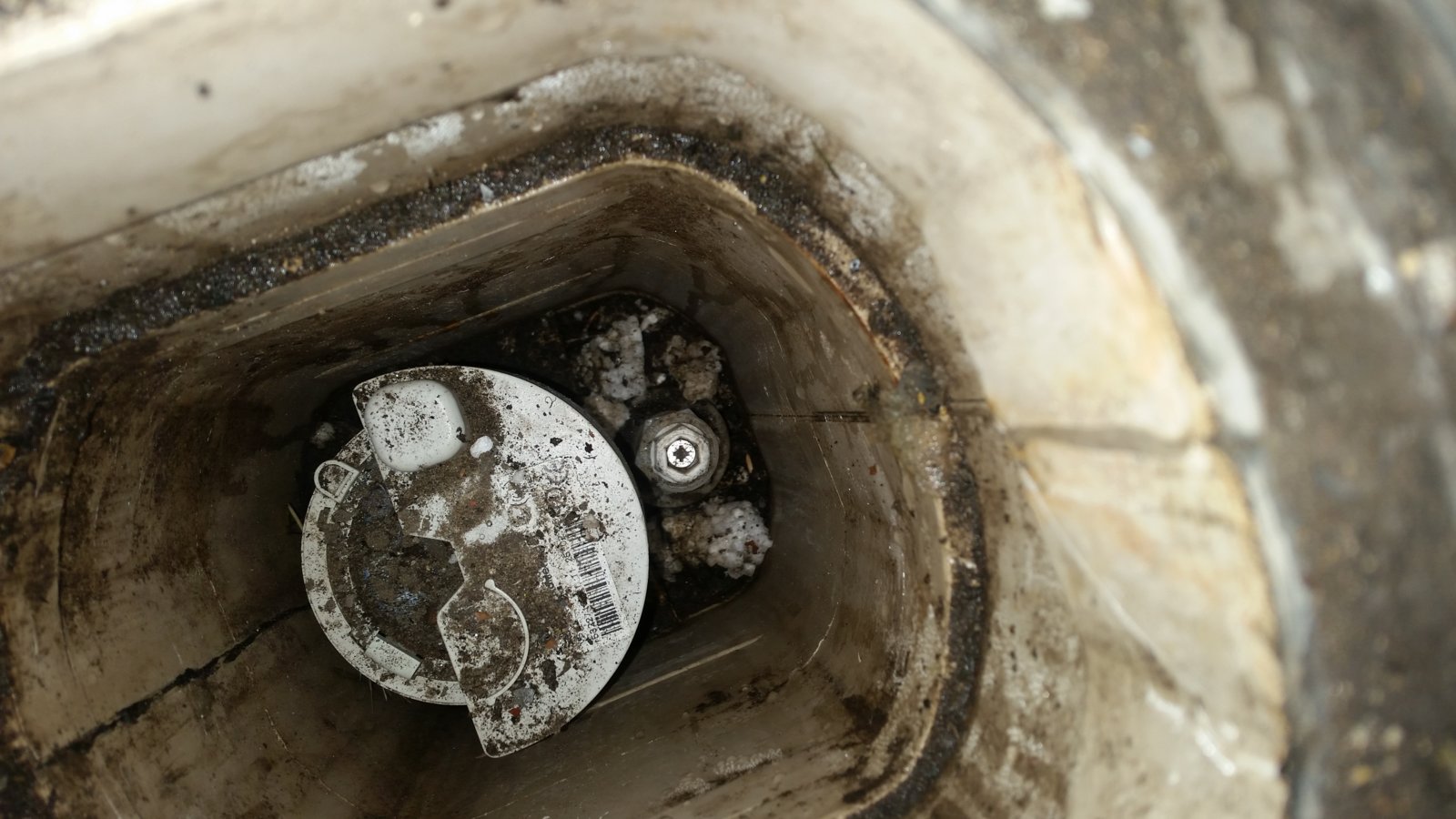

Sorry guys. The picture is not mine. It's the same though. I used the pic as it was much clearer.
I unscrewed the cap today and did not see a place to put a key. Please see picture. Neighbours don't have same meter and some don't have a key.
you don't unscrew the hex fitting , the key thats suppose to be there fits inside that hex fitting to turn on/off ,

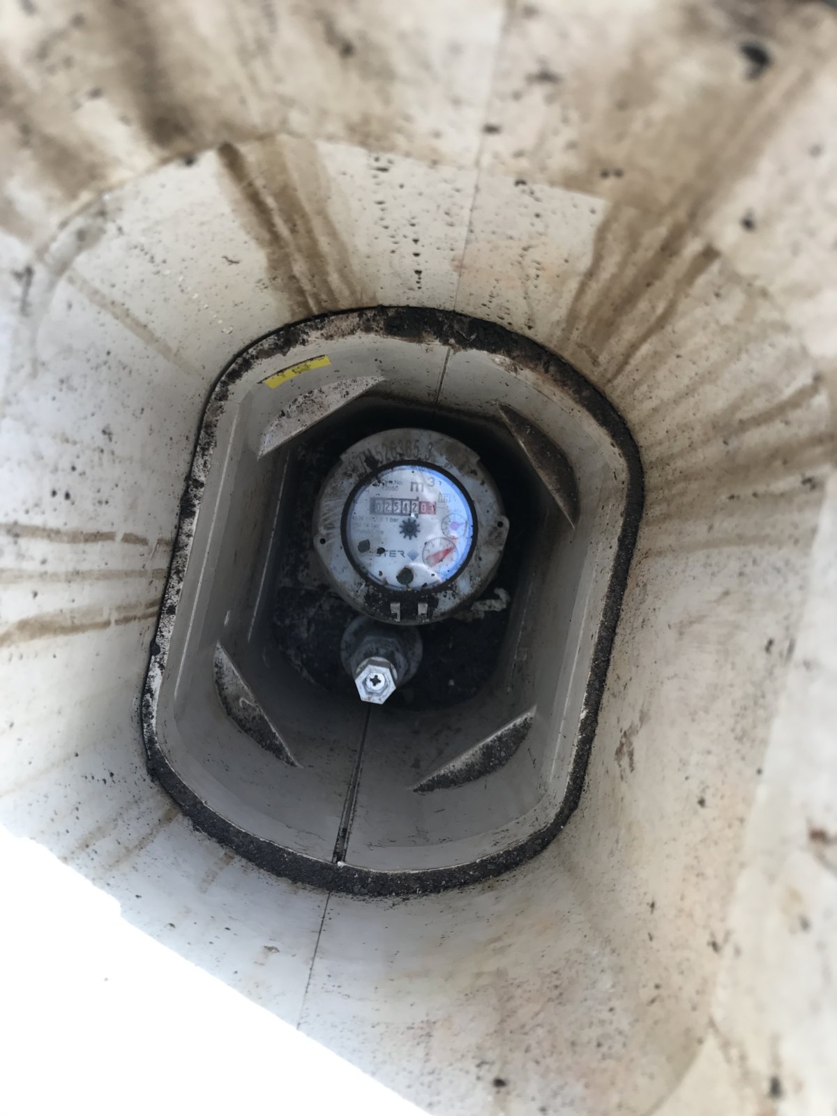

its very common for people to over tighten the hexagon fitting thus fooking it up . you will know if your turning it on / off or not . so why go checking other valves when all you could be doing is fooking something else up .

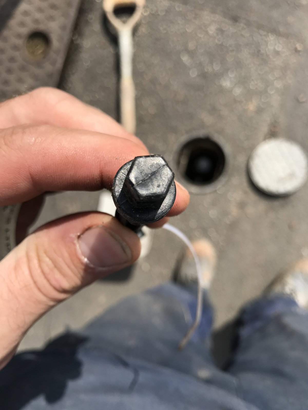

On checking further on newer models that hex is the tap itself. That should screw down to turn off and screw up to turn on and there should be a black plastic T bar in the chamber to do that but again check with the Thames first.

Just don't know what to do. This is mine.

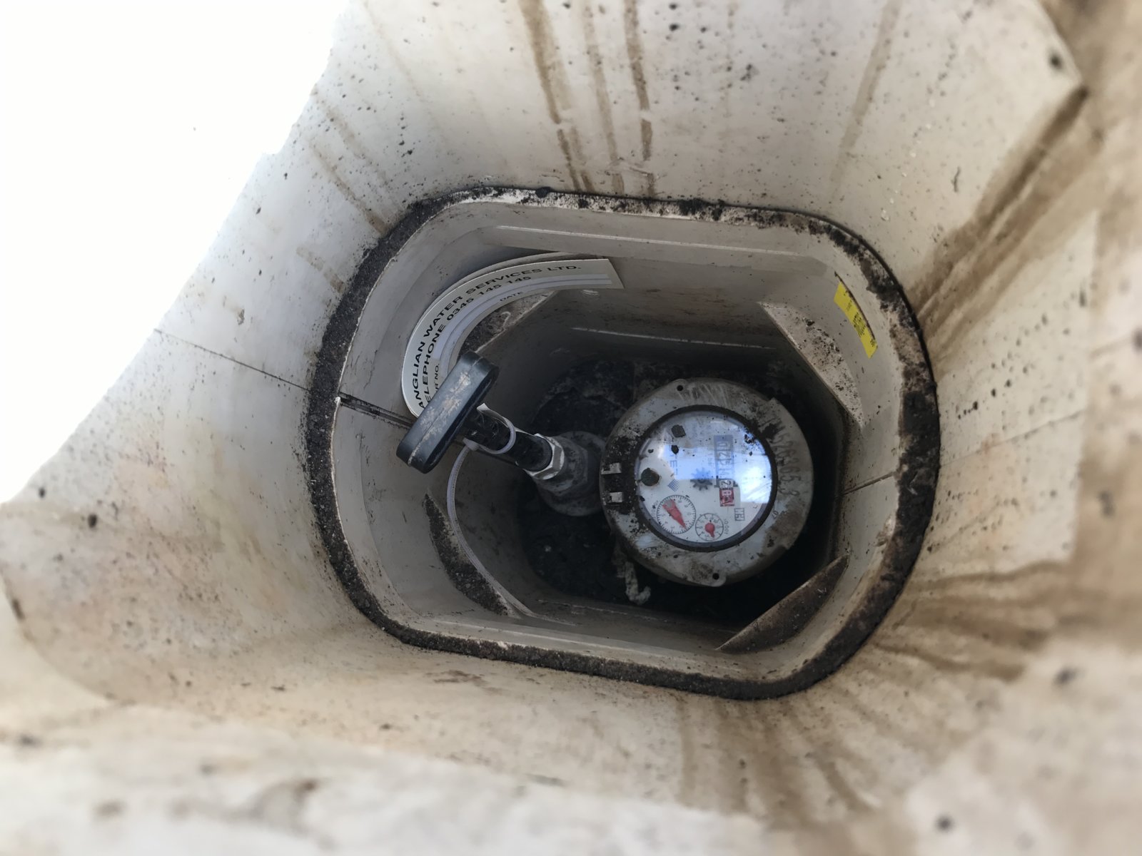

Thanks to everyone who tried to help me out. So what happened was that I called thames water out. When the engineer came out, he first unscrewed the white plastic thing on the stop cock.

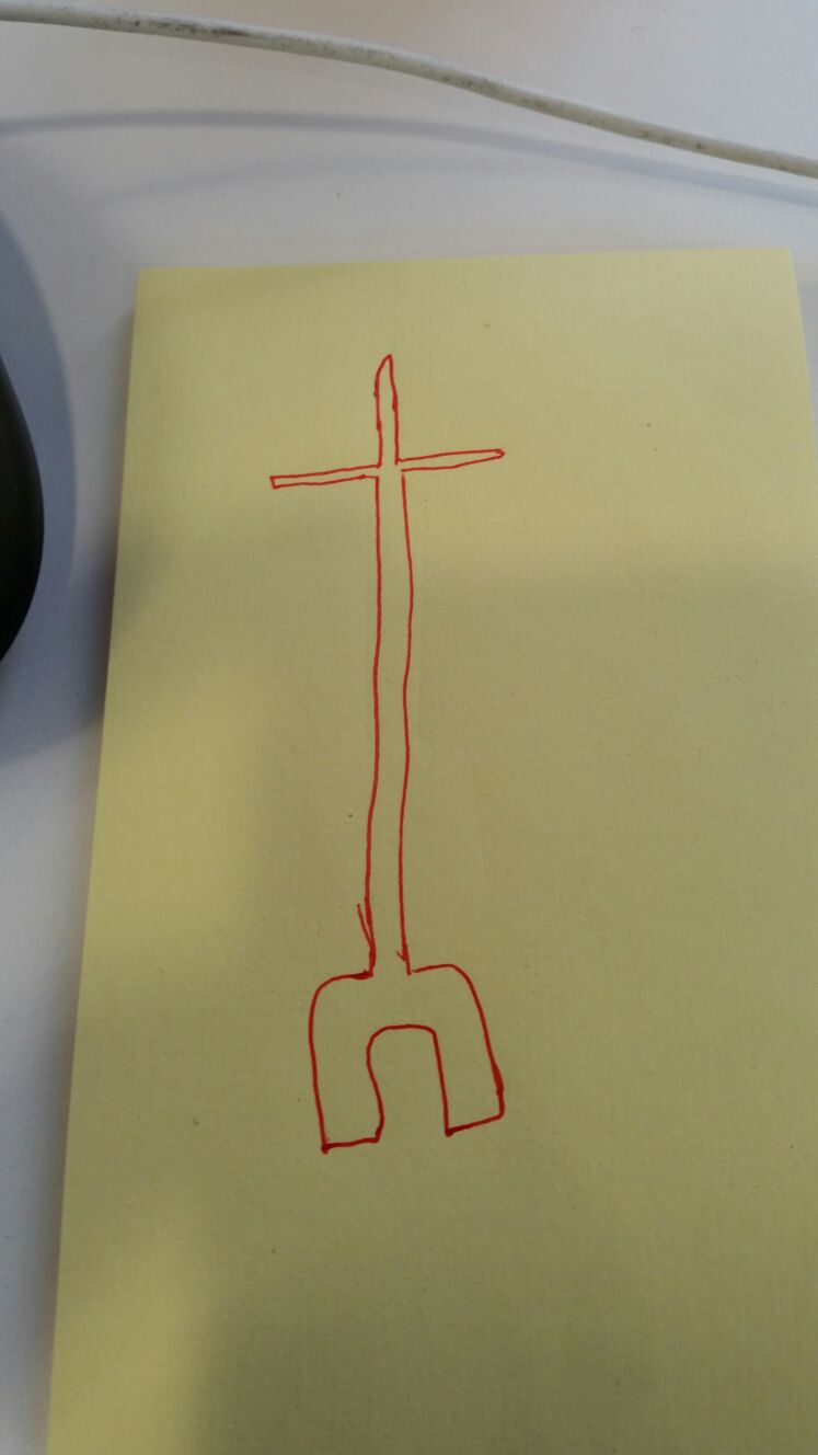

After that he brought a meter long T bar with a shape similar to the one pictured, when i asked him what that thing is called so that I could go buy one or perhaps for me to see what it looked like, he kept saying it wasn't any good to me and that he would get me a key and drop it in the chamber, last time I checked he has not yet done that. He said the metal stuff is no good for me, but the key is what I need.

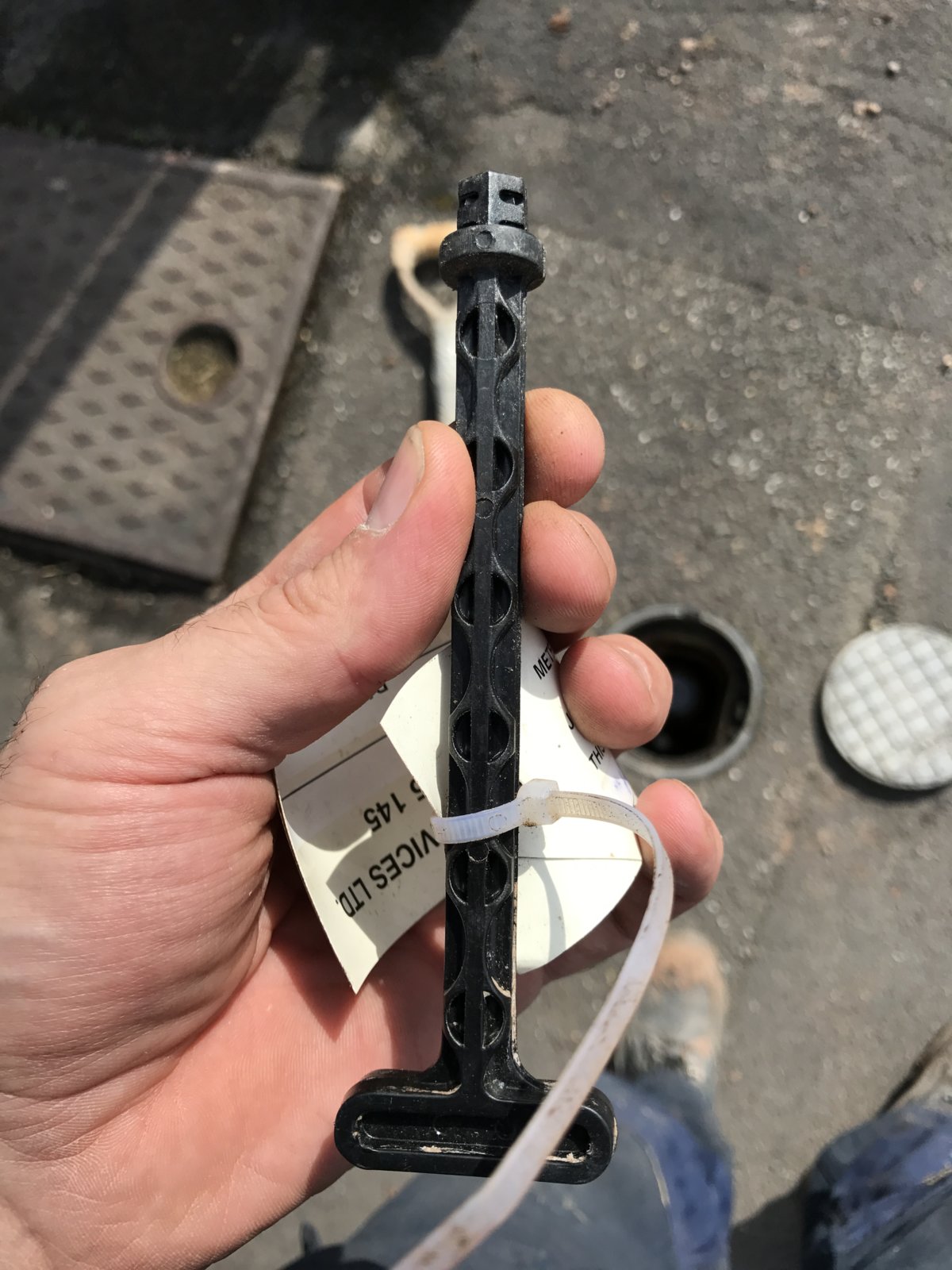

This is what you need:
The thing you have drawn is a generic stop tap key that old men use to save them bending over to reach the little black key.
