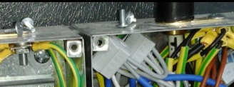

And he also posted the pictures in the first place. Now call me daft to think this but I can't think of a reason to post pics if you don't think there's an issue.
Only he could (and hopefully will!) tell us his view.
His only actual initial comment related to the number of lugs on the one bolt - and he has so far not mentioned another way he would have preferred it to be done, nor has he commented on whether banjos, when used, should be inside or outside of a metal box.
Rocky ??

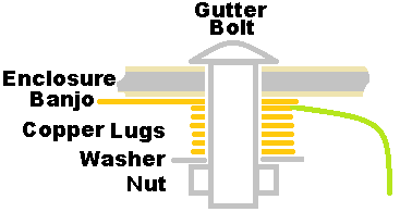

Simply moving the Banjo inside the enclosure gives this:
upload_2021-3-27_21-42-30-png.228380
And all of a sudden there is no steel within the electrical path. What is so dificult about that?
I would expect to have the bolt by some means, firmly fixed in the box - a nut tightened under the point marked 'Banjo' in the above, with a star washer. You cannot always guarantee access to both faces of a box, to hold the 'Gutter bolt'..
If using loose bolts and you can get the bolt into position then you have access to its head. Surely a hex head would be much superior to a domed screw-slot head (where you might have insufficient access for a screwdriver) as you can then ensure correct torquing of the connection.
Of course a hex head is best but may I respecfully point you towards an extremely common situation:
The 2 banjos in the image are very clearly seen to be bolted with gutter bolts.
Cor blimey, star washer. not your average sparks then? I find it unbelievable sometimes how so many electricians never even use the washers supplied, let alone any special type.
Our technique does not usually include fixing the bolt to the enclosure as it has been found the bolt could turn while the second nut is tightened resulting in the bolt being lose. On panel back plates we drill and tap the plate, using a copper plated star washer screw the bolt in and tighten to the plate then another star washer and nut tightened. However this cannot be done with a panel enclosure or adaptable box.
