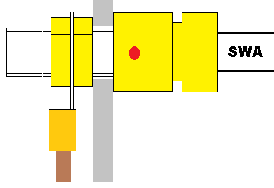

So, as predicted, you have pre-empted my question but I'll ask it anyway. When that bolt is actually the thread on the gland and the thread passes unhindered through the wall of an enclosure, let's say it's plastic as I believe you understand that concept, may I also assume you accept this arrangement is electrically, but not mechanically, sound? The lug is of course now replaced with the banjo.
Same answer as above. Obviously not mechanically sound in terms of mechanical attachment of the gland to the enclosure but, electrically speaking, the same as above - i.e. electrically sound so long as the two nuts remain 'locked together (this time through the banjo innards of the 'sandwich'), but will cease to be a 'sound electrical connection' if the nuts 'come loose'. Again, if the inner nut were tightened up to the uinside of the enclosure, then the risk of that 'coming loose' would probably be reduced.
So if I understand correctly, in your opinion this is a good design?
with the first nut tightened for mechanical stability then the second nut for electrical.

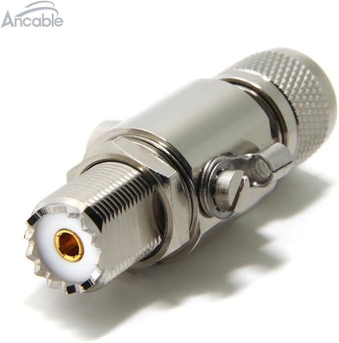

In the side of the gland, there used to be either a flat or a lump with flat top drilled and tapped and usually supplied a 2 or 0BA slotted roundhead screw. The position crudely shown in red above.
This is a completely unrelated product but it gives an idea
Pretty 'good :) It would certainly be my opinion that it would be less likely (than your previous drawing) to suffer from a subsequent deterioration of the required electrical continuity between banjo and gland (due to 'coming loose').
... with the first nut tightened for mechanical stability then the second nut for electrical.
Not really for that reason, as you have stated it. Rather, with the first night tightened against something rigid so that tightening of the second nut against it (with intervening banjo) would produce a more 'reliable' (likely to last) adequate electrical connection between banjo and gland body.
...In the side of the gland, there used to be either a flat or a lump with flat top drilled and tapped and usually supplied a 2 or 0BA slotted roundhead screw. The position crudely shown in red above. ... This is a completely unrelated product but it gives an idea ...
Ah, right. I've seen such things on products such as you illustrate but never, that I can recall, on an SWA gland.
socket version of the PL259

OK so my reading of this is you are generally happy with '2 nuts' approach and from previous posts a hesitancy with the single nut version, in other words you prefer the older system of installing the gland.

As I've said, the '2 nuts' approach is what I've always used with plastic boxes, primarily because I'm more confident of the 'longevity of tightness' when the banjo is between two metal nuts that have been 'tightened together' than when there is just a single nut with plastic as one of the materials that has been 'tightened onto' by a single nut.
As for metal boxes, I have never used a banjo, because I don't see the need. In fact, given that you have agreed that the material (brass or steel) is not an issue, I'm a little surprised that you see a need, either ...
... with a metal box, with or without a banjo the earth path is essentially the same (other than for the material). In both cases, the gland is clamped to 'a piece of metal' (by a locknut) and the CPC lug is bolted (with a nut and bolt) to another place on that 'piece of metal' - that 'piece of metal' forming part of the earth path. The only difference is that in one case the 'piece of metal' is a brass banjo and in the other case it is part of the steel box. So, if you don't think the material is, in itself, an issue, I don't really understand why you think it is 'better' with a banjo.
To take an extreme case, what if it were a brass box? Would you still feel it 'best' to bolt a brass banjo onto that brass box (ussing the gland's locknut and a nut/bolt) - and, if so, what would you believe it was achieving? If you wouldn't, then it would seem that, despite what you've said, your concern about a steel box without a banjo must relate to the (steel) material, mustn't it?
