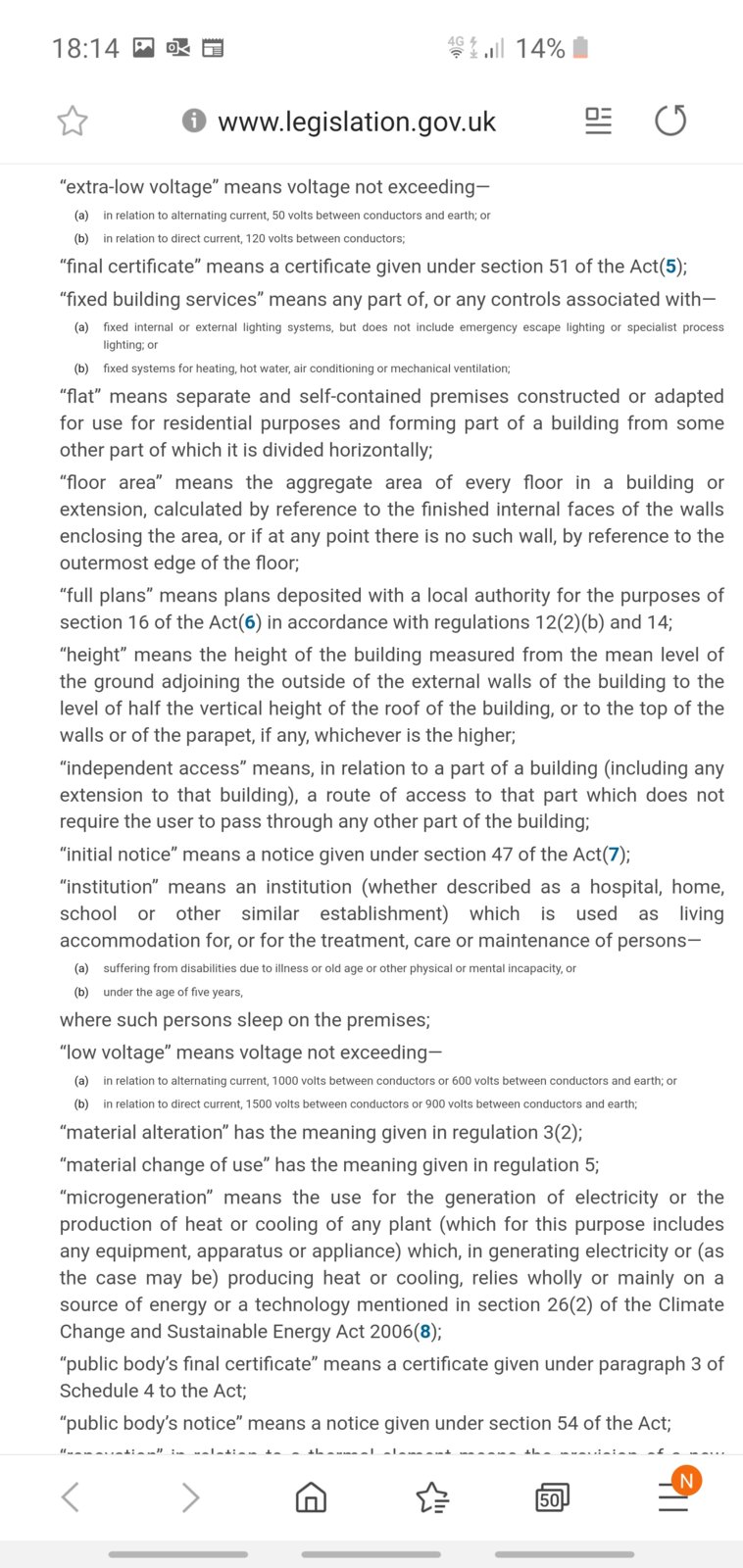

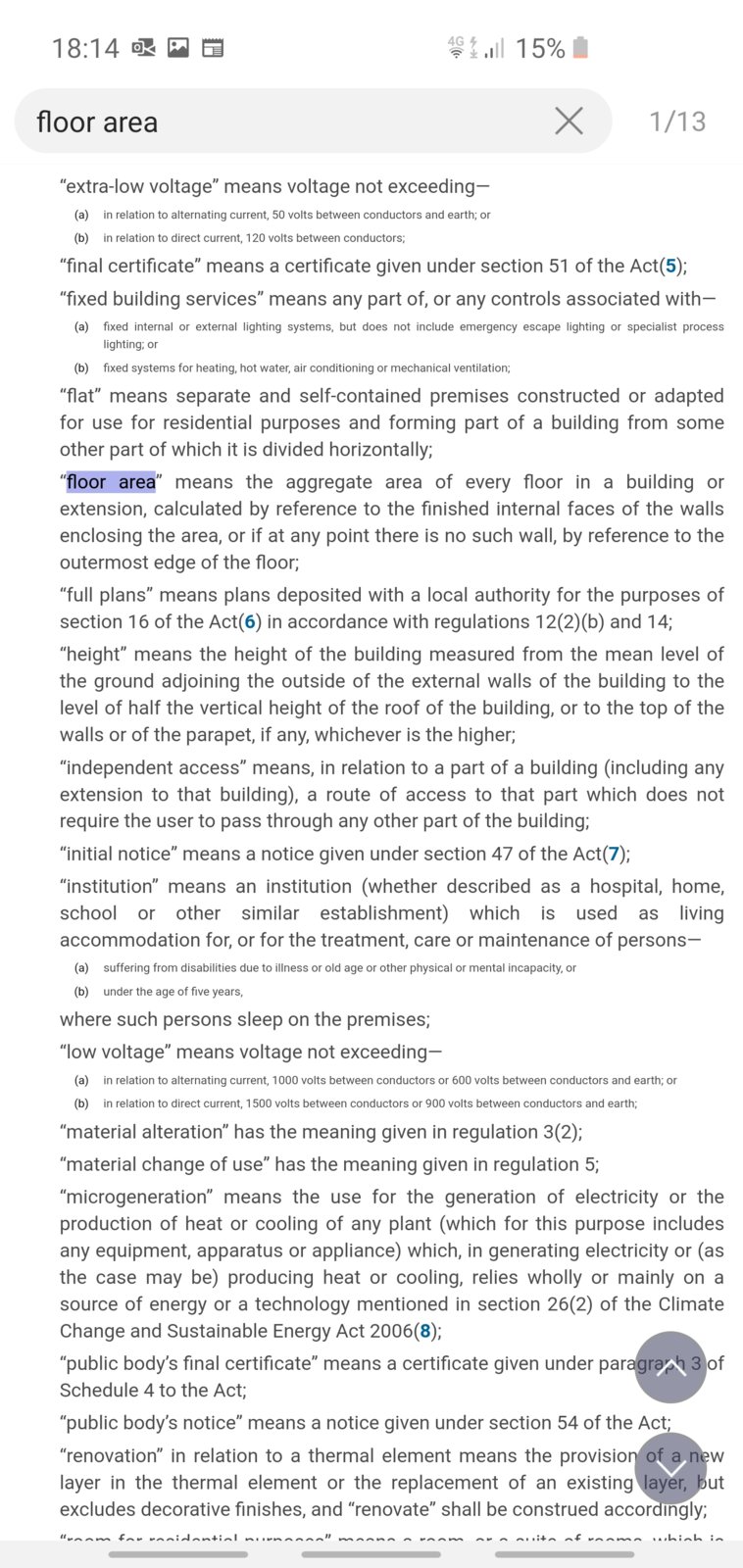

Hi would you mind just saying whereabouts that is stated in the text - I can only see this is schedule 2, which confusingly doesnt explain what floor area means:

With all this confusion I have just called complete building control Birmingham and managed to get the mobile numbers of two of their building control officers who cover my local area. I was told it is 30m2 internal. I actually called both lol and its deffinatly internal floor area for those who are under the assumption that its external. Thank you to all you guys who have responded! I've always browse this site for information but never actually put up a post. Think I will be using it more often!
It's very near the beginning of that link to the Statutory Instrument:
Part 1 (General) - 2 Interpretation - "floor area" is about 16th item in the list.
