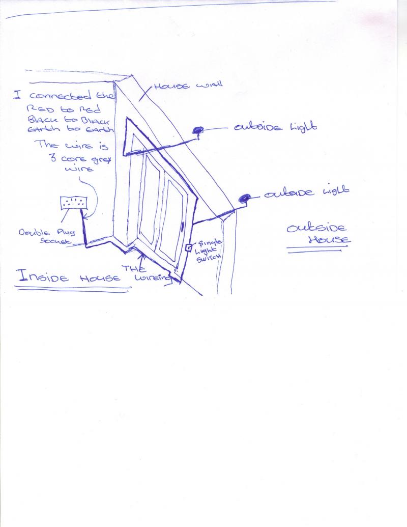

i have 2 out side lights at each side of my patio doors wich i wired up myself. i,ve been using the lights for about 3 yrs now but the builbs seem 2 blow every other month or so. i,m not sure if it because how i,ve wired them up. i,ve uploaded a diagram of how i,ve wired them up , if this is incorrect would someone please tell me the correct way. many thanks.
You should have connected them to a LIGHTING circuit, or if connecting them to a socket circuit like you have done, you should have incorporated a Fused Connection Unit somewhere.
For example, if you had used 2.5mm cable from the socket to the switch at the door, and then 1.0 or 1.5mm from the switch to the light, you could have placed a SWITCHED fused connection unit at the siwtch location, and used it as the light switch.
If you have used 1.0mm or 1.5mm for the entire run, then you would need to place the fused connection unit adjacent the socket, and use a small piece of 2.5mm to link from the socket to the FCU.
What size cables have you used?
Are your cables clipped direct or in trunking? Have you buried them?
In saying all the above, this gives no clue as to why your lamps are blowing early.
What type of lamp are they? What wattage? What type of light fitting? Max wattage for the fitting?

thanks for all the advise. all i know is the wire is grey with a red , black and earth wire, when i bought the wire it was on a large reel and its berried under the plaster. sorry i cant be more helpful, its that long since i installed them. the lights outside r white lantern style and there max builbs r 60 watt. hope this helps. thanks
As others have pointed out if there is a fault and it sounds like they might be your lightts are protected only by a 30/32 amp fuse/mcb :(.

Far too many people will always come back saying "but it has worked fine for years". It doesn't mean it has worked safely.
Electricity sits and does its job until one day when, for what ever reason, the fuse on the circuit needs to operate to clear a fault. A poorly selected cable and fuse could then result in fire. It may have worked just fine for the 3 years previously.
The other issue I was concerned with was the cables buried in the wall. These need to be run in 'safe zones', where people would expect the cable to be. It appears as if yours are not.
As for the lights blowing bulbs constantly, I would hazard a very honed guess towards the use of cheap supermarket lamp bulbs rather than a 'wiring fault'.
Or possibly corroded contacts in the lamp holders, causing the bulb filaments to cycle. I've had similar with an outside lamp at my home (on a lighting circuit and RCD protected) and I'm so fed up of the short bulb life it's for the chop, when I get round to it. The contacts are quite flimsy plated affairs and quite simply I wish I'd spent more money on the fitting and bought a better quality product.
Tozza, in the house I converted to a surgery, I discovered lights in the conservatory, just as you have wired them, off the back of a socket from a consumer unit ("fuse box") with no RCD protection. Quite simply it was potentially lethal although it did "work". The only protection was the wire fuse and touching that switch with wet hands could well mean death. The first thing I did when I bought the house was to link everything to the appropriate fuse and write it all down and when I found the lights to be on a power circuit without a fused spur, they were switched off, the switch taped over and a notice put up to prevent anyone from touching them until the conservatory was removed and the house rewired for the conversion.
