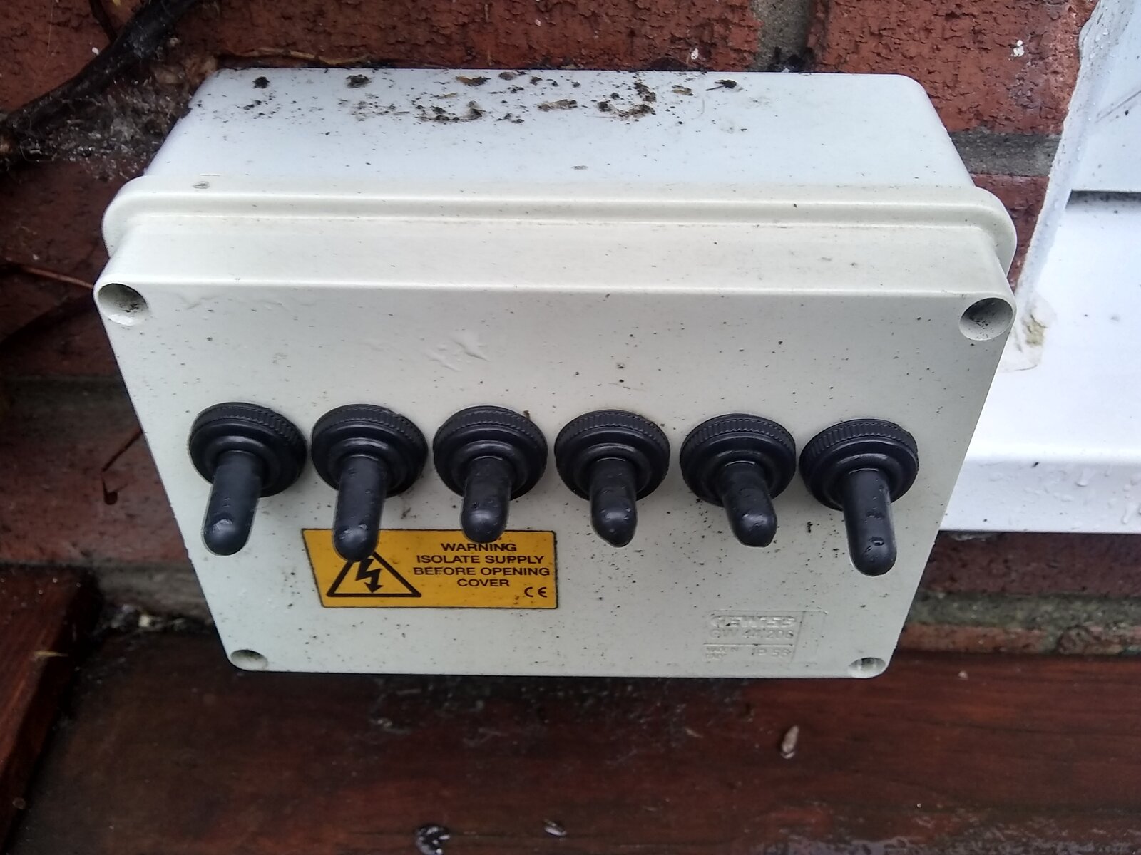

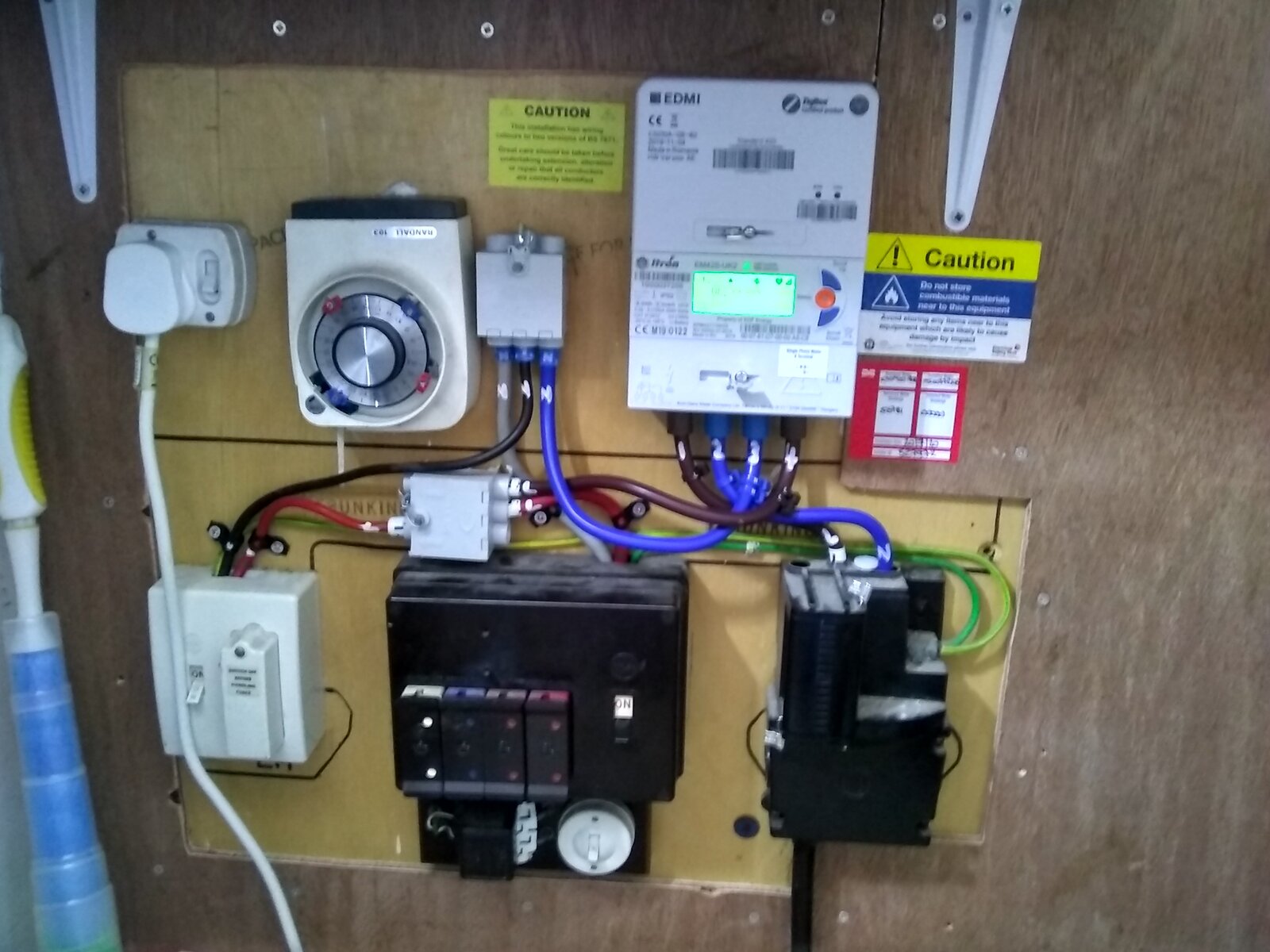

The pumps and lighting run through a fused switch box and then into the RCD socket . At the supply end I have an old fashioned consumer unit and fuse box .

hope this helps . Forgot to mention , we had a smart meter installed recently , and part of the old consumer unit was replaced .
Wanted to see if you had any RCD protection at all.
If you haven't, it's best to use an RCD socket.
But is the socket faulty, or the supply to it?
Have you proved the supply?
The RCD is a spur from an indoor socket . The parent socket is working , but I'll check the wiring at the weekend .
