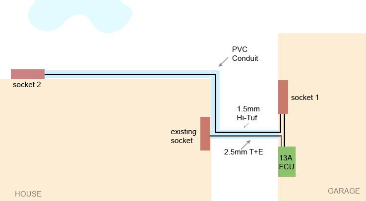

Why not go indoor socket > 2.5mm T+E > FCU supply > FCU load > 1.5mm HiTuf > garage socket > 1.5mm HiTuf > Pond socket, thus alleviating the need for a JB?
Is the pic below is how you recommend?
by the way, I'll need to use conduit because the 2.5mm T+E needs to go underground (down, under, up, in), so may as well use conduit to pond socket,
sorry mistake in pic, from FCU to socket 1, I'll also use 2.5mm T+E
If 'existing socket' is the existing indoor socket on the ring final, the layout presented in your drawing appears to be correct. However, it would make more sense for the FCU to be located in the same place as the existing socket, thus limiting the length of the unfused spur.
As already mentioned, you can't use T+E underground, nor HiTuf. You would either need to use SWA or earthed metal conduit, but I couldn't really recommend either of these to someone who's never used them before, as they take time and practice to terminate correctly.
Hi mate, thanks again for all the help,
I know what your saying about limiting the length, it will be about 2 metres before it reaches the FCU in the garage, is this way too much?
If you say yes, then the only other option I have is just use this existing socket to supply just one socket in the garage or fit the FCU indoors.
There are also 2 single sockets on the back wall, both on spurs, I know these aren't suitable to add a socket directly too, but can you add a FCU to one of these and trail a socket outside? I guess the answer is no, but it's worth a shot!
Thanks again for the help, you've been really helpfull ;)
There is no problem with the short unfused spur, it just makes more sense to avoid it given the chance.
Unfortunately you cannot feed your FCU from the two sockets you mention that are already unfused spurs from the ring, as an unfused spur is only permitted to feed one accessory.

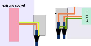

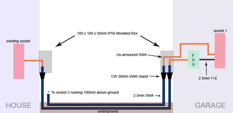

Am I ok to go ahead with the below drawing? Can you see any problems with it?
The drawing is illustrated as it will be ie the cw glands on the bottom of the boxes.
Also will be using another IP56 moulded box for socket 2 (with the swa cable and glands, unarmoured inside to connect to socket terminals).
All boxes gunned around back with silcone as Chri5 suggested.
Many thanks for the help
Erm, why not just mount the FCU inside the house next to the existing socket?
This would allow you to use 1.5mm SWA, and only need one run of it.
Yes, the glands MUST be earthed. Use an earth banjo or piranha nut inside the boxes and connect it to the CPC.

Hi mate, thanks for the advice :)
Yes, it would make life easier, but I don't want a FCU in sight indoors, plus with the existing socket there is two beams running either side of socket, sort of sandwiched in :LOL: I just think it will be too difficult and will be easier having it in the garage.
Cheers for the earthing tip as well, piranha nuts i'll use then. Thanks for the kind comments too!! All the best
What's wrong with an FCU in sight? We're talking something like this...
Not something like this...
With it inside, make it a double pole FCU and you can easily isolate the external installation if, say, a fault occurs (eg water ingress) that trips the RCD on your socket circuit and doesn't let you reset it. Surely putting the FCU inside is less more difficult than all the extra external wiring with the FCU in the garage?
