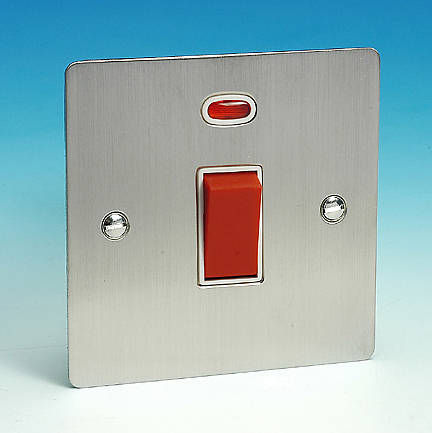

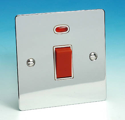

As these can easily be isolated at the MCB is there still a requirement for each to have an isolator switch close nearby? ... Protection is nice but these are pretty ugly switches and, unlikely, to get used I think.
Isolators should be fitted near to the ovens and be easily identified as being for them, so they can be quickly and easily switched in the case of a fire, should be to the side of the cooker though, so you don't have to lean across flames to switch them

"Ugly" is of course in the eye of the beholder, but given that kitchens are primarily places of work, and will have pots, pans, kettles, toasters, food processors, utensil jars, knife blocks/racks etc scattered about the place, I always feel that people sometimes overestimate the visual horror of cooker control units.
Firstly, they aren't all lumping great things:
Secondly, if you're using metal accessories, there are some quite neat ones around:
And lastly, of course, in your case you only need 20A switches:
Thanks ban I didn't even think that I would only need 2 20A switches now and I agree that they are far more pleasing to the eye.
