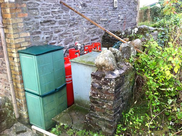

Here are some photos of the outside area of the back of our house.
Where the calor bottles and coal box are is a possible location for an outside boiler or ASHP. With a bit of clearing out and knocking out of a ledge.
Is there a way I could build an under cover area for a biomas boiler here that doesnt need planning. We have a highway both sides so planning will be needed. Maybe if it had a low roof that didnt connect to the house?
It's a semi, so the white vent on the wall is where the neighbours house is.
How water tight would the outbuilding need to be for one of those multi fuel boilers?

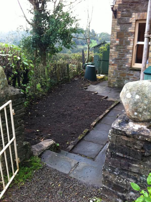

Here's another image of the gable end where I was thinking an outdoor pellet boiler would go. Just before the green shed kind of where the cylindrical compost bin is. There's a road to the left of the shed.
Any thoughts?
