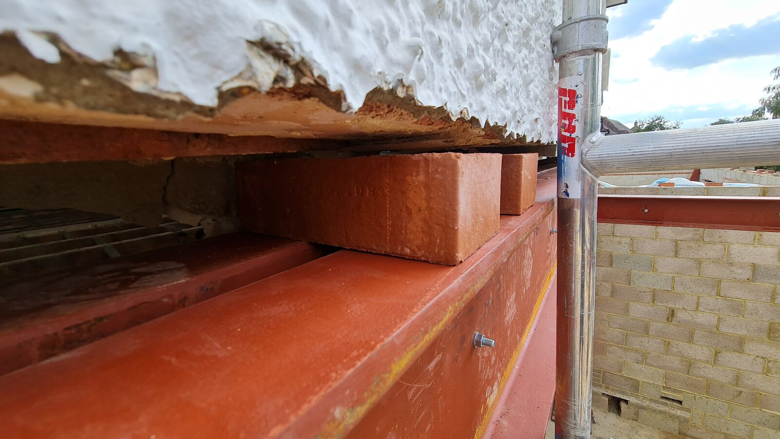

Steel is now in and the gap is a brick laid flat plus 20mm max.
Shall I lay a row of bricks on a thin bed then pack the top 10-15mm when gone off?

Yes a brick plus a joint either side.

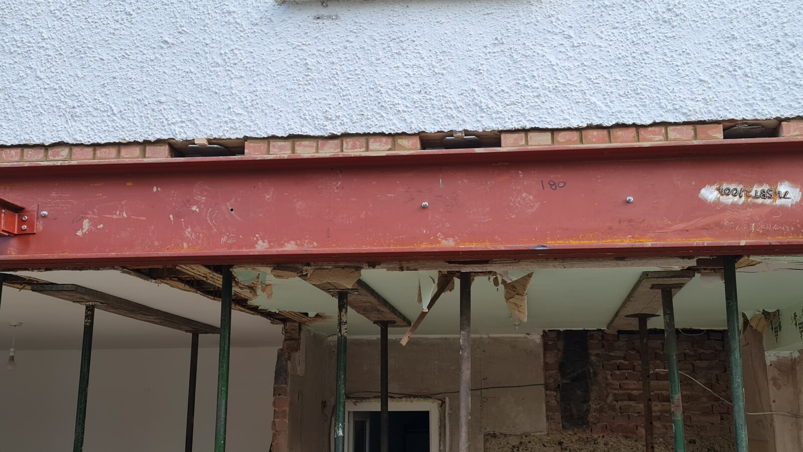

So I have bricked up between the strong boys as below. 5mm ish bed between brick and steel and 10mm ish between brick and original brick.
No way of knowing if the joint is fully filled as I can't see it but the tool sends the muck out at quite a pressure so I think that with a push in with the finger trowel and a further shot and I should be covered.

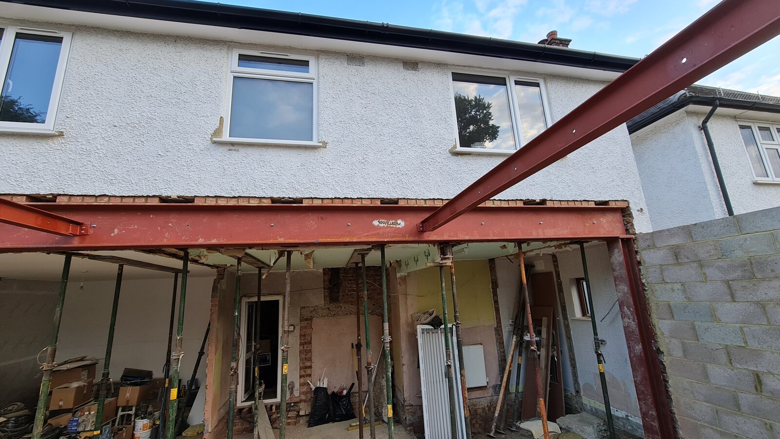

How long should I leave it before I remove the strong boys and infill where they were. Can they all be removed together? Realistically is there anything that can go wrong with the process I have followed?
Is 1 day enough to dry out sufficiently to remove the props or should I leave longer
