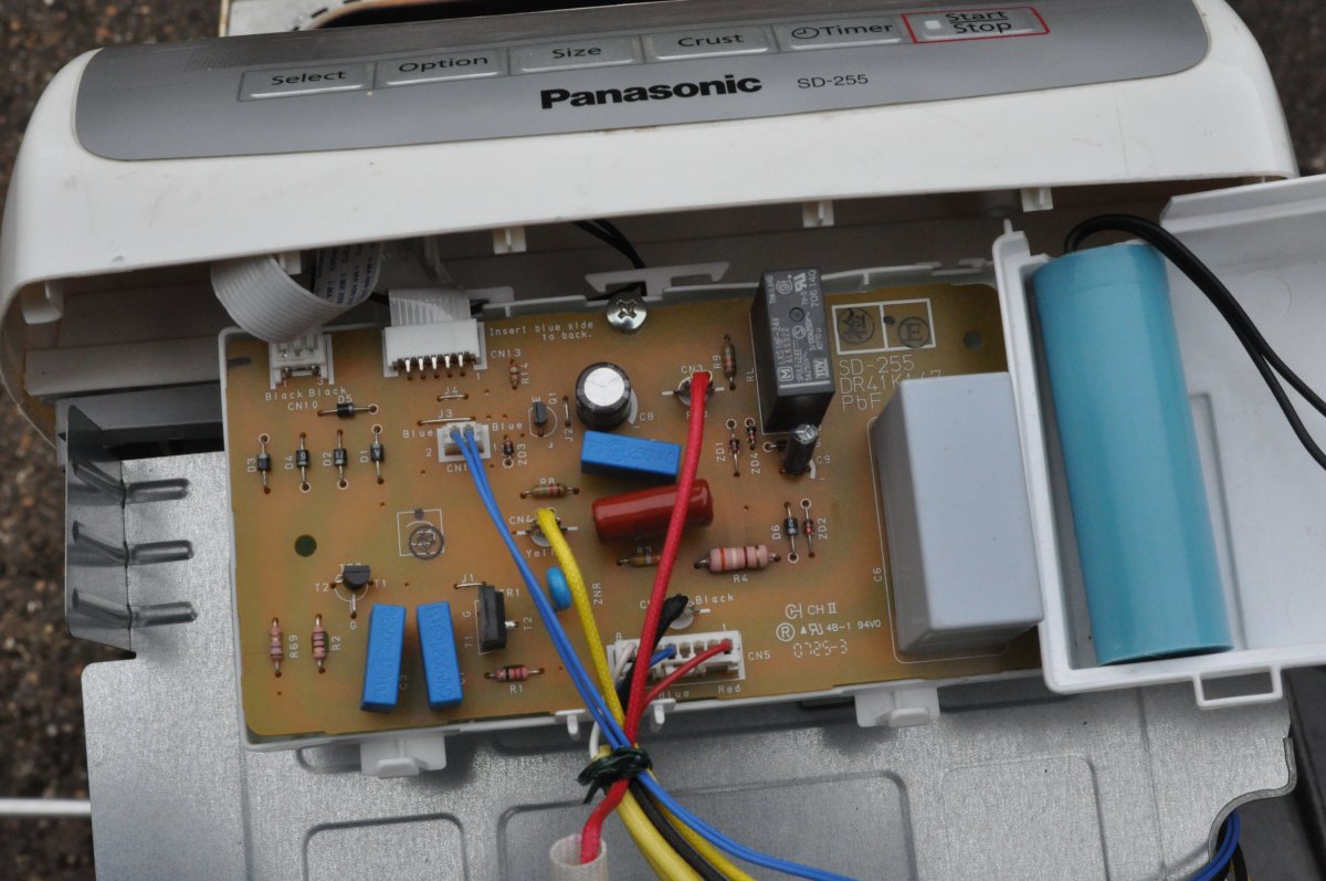

I see it was August 2014 I joined this thread so I thought I would update how things are going with my Panasonic SD255 and the leaky shaft seal in the pan just in case anyone is still around wanting to know. Two things have happened:-
Firstly I bought another bread maker – an SD254 for £5 in a sale. The bread pan was good and fitted my SD255. The SD254 was also good and the 550 grm whole meal/white flour mixture rose so high it stuck to the lid. Same result at the time with my old one as long as I kept the shaft clean.
Secondly the old one is causing problems again with dense loaves despite keeping the shaft clean. I even premix the mixture by hand in a bowl and tip it in the pan when the paddle starts (this reduces the amount of water and flour getting into the shaft as the seal is so bad it spins around). I have now taken the machine apart to check the belt. As far as I can tell it looks OK and should turn the paddle faster than it does. It’s definitely slower than the other one.
Reading further on with this thread r765 from Bournemouth mentioned on 30th May 2015 the motor capacitor on the pcb was the cause of his motor struggling to turn the paddle. I am not into capacitors and measuring uFs etc but am capable of doing some soldering so am going off to Maplins to get a capacitor for £3.69.
The only concern I have is that the Maplins capacitor is a cylindrical one and I am not sure about where to fit it if it doesn’t go in the pcb box. R765 suggests a stud mounted capacitor and fix it to the lower flange which sounds good but not sure the Maplins one is of the stud mounting type. We’ll give it a go.

I have just come home from Maplins with cylindrical capacitor with two wires attached. I am hoping I will get it into the PCB box but it's a tight fit. By enlarging the hole at the top of the box there is just enough room to take the wires out of the top and then by bending them over they can come back into the box through the same hole. I then hope to be able to solder them in place.
There was an alternative capacitor that was stud mounted. I considered this but I would have to drill a hole in the motor plate and as it had no wires I would have to acquire some and fit them. It was only 240 volts compared to the 440 volts which is the same as the original. I hope my planned method will work.

I have just fitted the Maplin's capacitor to my SD255 bread maker and the paddle turned nicely so it's now under test with some ingredients.
The new capacitor is the blue one on the right of the photo and the old one is the grey one beside it. To remove this I had to hold the soldering iron to the back of the connections on the PCB and pull at the same time to release one side at a time. The first decided to move a little and then re-solder itself but it eventually gave up.
Once removed just push the wires from the new capacitor into the holes and solder from back. Once soldered in place I pushed it into the top cover and replaced cover. As you can see it was a bit of a tight fit.
Whooa. The paddle is spinning like a top. No more tired grunting and deciding whether to go or not. I also have the £5 SD254 going beside it as well and the SD255 with the new capacitor may even have a stronger/faster spin. Two loaves should be ready this afternoon.
I would like to thank all you electronic experts who pointed me in the direction of the capacitor as without you I wouldn't have a clue about this. My ten year old SD255 hopefully now has an extended life.
