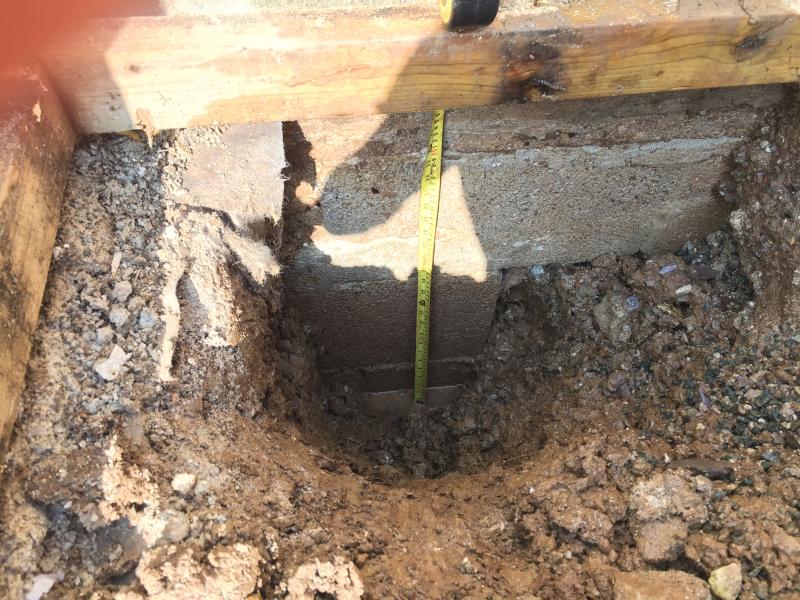

Anyway, I have today dug a test hole as recommended. I have some photo's and would appreciate your input.
The distance from the top of the existing concrete footing to the finished floor level internally is approx 800mm, or 750mm to the ground level outside. Am I right in syaing the 900mm is trench depth prior to concrete, and from what point?
Presuming the concrete in 100mm + deep, am I right in saying the existing footings (and subsequently the terrace neighbours footings) are not going to be an issue with regards to digging below for new single storey extension footings?
Thanks in advance
Just what you wanted to find. Your new extension needs to be minimum 900mm deep and either the same depth as your house or deeper. It would have been an issue if your house foundation was shallow - i.e. 600 or 700mm - because your extension would have been deeper and therefore deeper than the adjoining house, which would then have required a party wall notice.
But it isn't. The extension foundation can be the same depth as your house - and adjoining house - without having to go deeper and without having to serve party wall notices. So crack on.

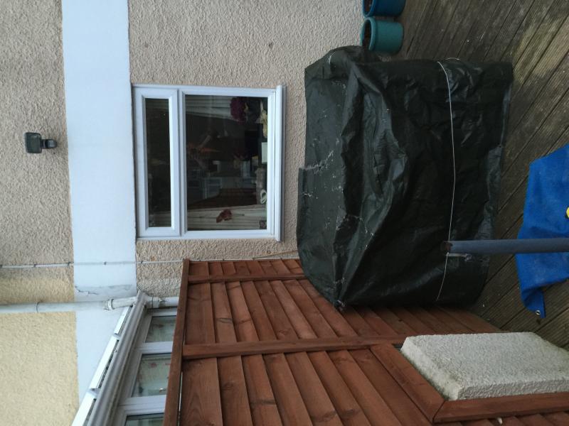

The party fence wall issue still lingers as the existing wall with the troublesome neighbour may cause issues. Currently, behind the femce I put up is a 1000mm high singe block boundary wall sat on an existing concrete path from the council build. You can see the pier on my side.
How close can I build up to this existing wall? Ideally I would like to knock it down and build a new wall which also makes the boundary, but I suspect I won't get them to accept.
My next best alternative is to build as close to the wall as possible.
