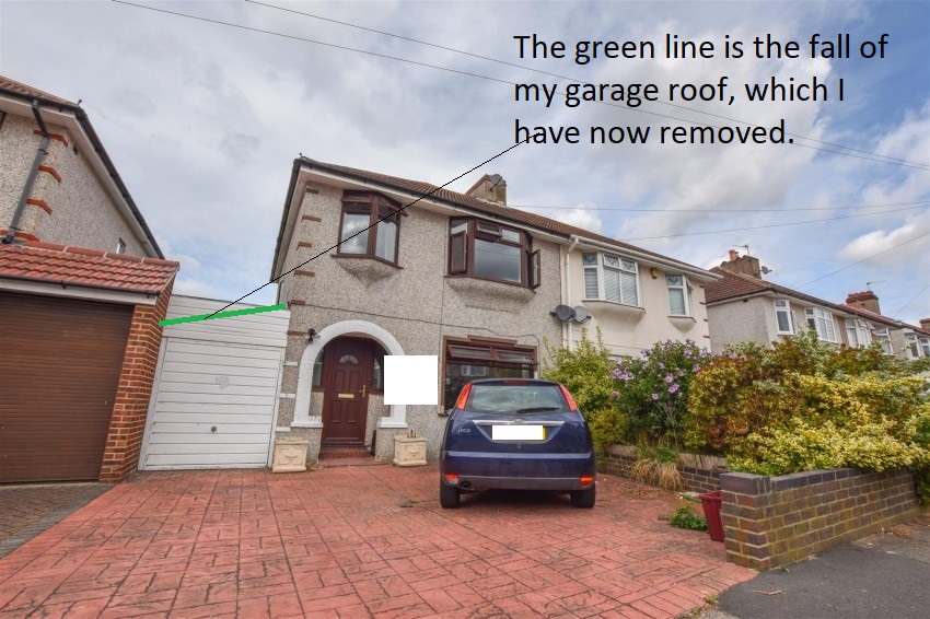

Hi All.
I am doing some major works at my house, which involves a rear extension and also a garage conversion as well.
Below is a timeline of what happened.
  1. When we bought the place, we spoke to the neighbour to talk about our plans.
  2. They didnt have any objections.
  3. Neighbor asked me if we could knock down the party wall and rebuild it. I agreed to do this at my cost, just for them to pay for the cost of redoing thier felt roof, but I agreed to pay for the wall. At the time, I didnt understand the issue and the fact that the 2 roof fall into my side, and I downplayed the issue and said I would build a wall, thinking that was the only solution, I didnt realise at the time that the neighbor would also need to raise the height of thier roof as well and make it fall to thier existing kitchen flat roof.
  4. I sent the neighbor a party wall agreement, 2 agreements one for digging within 3m and the other for the party wall.
  5. Neighbour signed the oen within 3m, but changed thier mind on the garage on the advise of the wife who is against it.
  6. Neighbor apologised and said it was his wife, which I completely understand.
  7. My architect then came up with another proposal, which is not to build a party wall, but instead use 3/4 coaches ofclass 2 bricks, and then have a timber frame wall, I also agreed this with building control, the only issue is that the existing party wall is not high enough, and the fact that the neighbors garage roof falls towards mine, which means whenever it rains, it will go towards my wall and damage it.
  8. The neighbor did this drainage years ago when they had water ingress into thier house, and decided to put a funny drain between the 2 houses and make it go into mine. Now, that might be fine with the previous owners, but i am not Ok with it now and I need it removed.
  9. I approached the neighbor this week to inform them that I now understand the issue properly and the only solution is to raise the party wall, and the fall done properly because if it stays as is, the water is coming towards my side. The wife was against this, even though the husband was in favour. They asked me how much my builder would charge, of which I didnt know at the time, as I had not spoken to my builder.
  10. They were arguing amost each other, and I said the best thing was for them to call other roofers and get a 2nd & 3rd opinion about it, and I would also get them a cost to redo thier roof which is what they pay for, I pay for raising the height of the party wall and to do my roof obviously.
  11. To my suprise 2 days after, I get a letter in the post saying based on our last conversation a dispute as arisen and they would like to appoint a surveyor.
Now, I would like to know where I stand legally on this. Its really spiteful, especially after we have been cordial before this, and just because the wife doesnt want to move the fridge/freezer and have the garage without a roof for 3/5 days, whilst the issue is resolved, they are thinking going to the surveyor is the solution.
I have since removed my garage roof this week, so its only thier roof draining into my garden, a friend of mine has asked me to tell them to sort that out first, since its encroaching on my land and is also tresspassing. I wanted to get the opinion of folks before I make a move.
Thanks in advance.

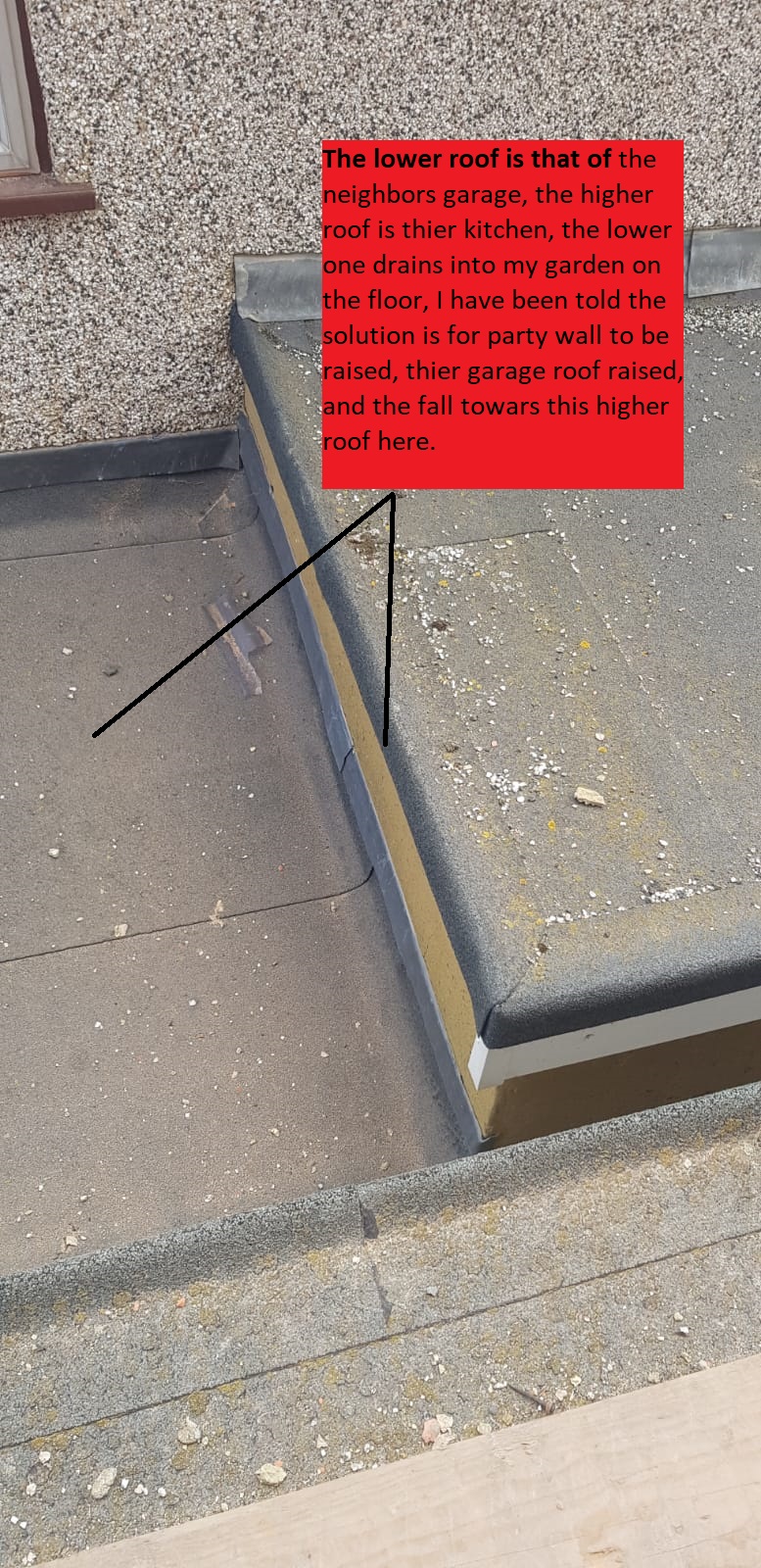

  2. The second issue is that, now that my roof has been removed its their roof that is draining into my property, now that cannot be right. The only solution to this is point 1 which I have summarised above.
I have been reasonable, I will pay for the wall to be raised to the required height. What is unreasonable is for me to pay for covering their roof, not that I cannot afford it. I just think they are taking the ****. Look at it like this, If I sued for encroachment/trespass/nuisance that their roof is causing by draining into my garden (without my approval), would they not then be paying for raising the wall, sorting out the fall towards thier side.

There is normally an express or implied easement or right to drain roof water across a neighbour's attached roof and gutters. One neighbour can’t just block it off and expect the other to alter his roof.
If the PW Act applies to raising the party wall, then that will deal with the required roof alterations to the neighbour's roof.

Also altering my roof is not the issue, its theirs which falls towards mine. Unfortunately, what makes it complicated is the party wall. If I however built a new wall, then they would have to sort out this problem by themselves, because at that point, it wouldn't stop my work, because I no longer have to deal with a party wall issue, and I can sue for damages.
