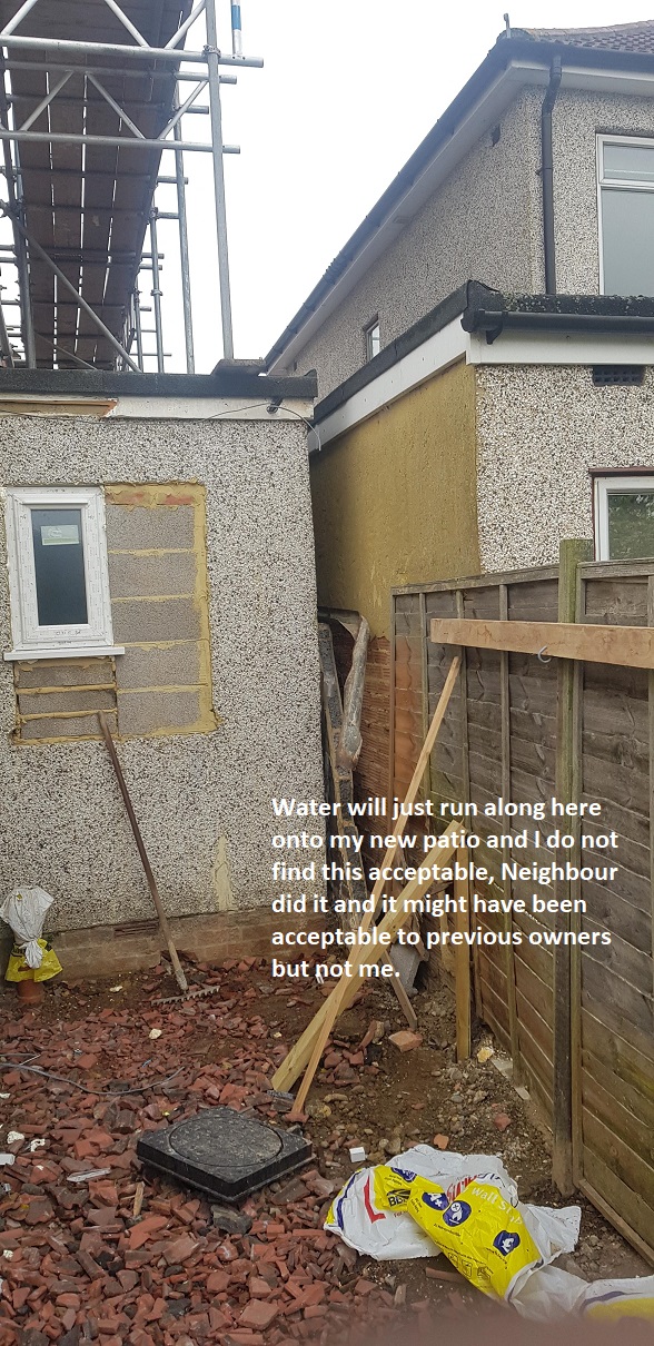

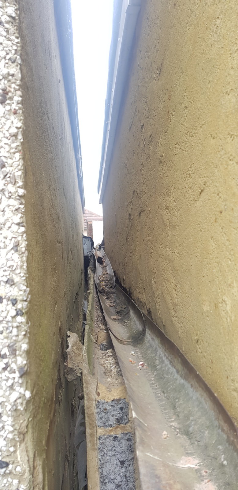

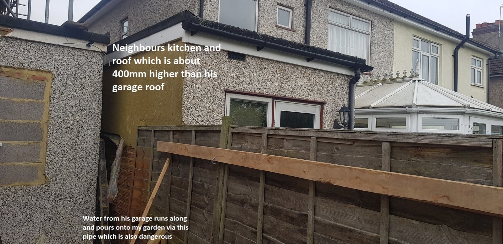

Can I ask, where did your garage roof drain to, before you removed it?
Please look at some of the pictures I put up and also the one attached.
It was joined together and then linked with felt to drop into the tiny space between the 2 houses and then onto my garden.
I have videos, it's the best way to describe the issue, please see the picture below.

Looking at the photos - has somebody actually 'designed ' ( using the term loosely ) all this ,what is going on :?:
I know right !
This is how I met it, and whilst its unfortunate that my attitude may come across on this thread. This is what I met when I bought the place.
How can this be acceptable ?
Lets forget the wall business, the drainage issue is a biggie for me.
A raised dividing wall + new garage roof with the correct fall will sort out this drainage issue, albeit with some inconvinience to my neighbours.
