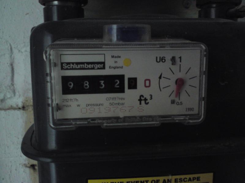

I've been on a mission to prove to myself how inefficient my 43kw Potterton Osprey boiler is (I've posted on it recently) and I'd appreciate thoughts on my latest detective work.
Over a 12 hour period of no boiler activity, the pilot light notched up 0.4 units on my imperial meter. This scales up to an impressive(!) 146 units pa or just under 4600kWh (this is about 300kWh more than my entire year's higher rate amount and would equate to £160 p.a. at the winter month's rate).
I'm staggered to be honest!
This all contributes to my annual usage of 37,500kWh - a 4 bed house (15 rads) that's kept at 19 degrees from 07:30 to 20:30, with a fairly average size hot water cylinder that's heated to 55 degs three times a day for 30 mins each time.
Are you sure you have measured it correctly? When you say that 0.4 units were used over 12 hours,which numbers were you reading?
Imperial meters measure in cubic ft. There are usually four black numbers, two red and a dial. The right hand black number goes up in units of 100ft³ and the right hand red number moves in units of 1ft and the dial rotates once for each ft³. So if it reads 123456 it means 123,456 cubic ft. When meters are read only the black figures are recorded, so a reading of 1234 means 1234 hundred cubic feet.
It's a cubic feet meter and has 4 black digits and 2 red (though the second red one is '0' all the time i.e. it doesn't move).
The reading at 8pm last night was 9830.80.
The reading at 8am this morning was 9831.00.
In a 12 hour period then I reckoned this is a usage of 0.20 units.
Have I read it correctly?

You seem to be reading it correctly, but it is strange that in your first post you said it used 0.4 units in 12 hours and now you say it used 0.2 units. Do you have a gas hob or gas oven? Strange that the second red dial never moves - have you watched it to make sure it never moves?

Apologies...the actual reading was 0.2 over 12 hours and extrapolated to 0.4 over 24 hours. My calculations though were based on the correct readings so the £s are all still correct.
The second red dial isn't even a dial..it's a graphic .I've taken a piccy:

Your calculations are correct and you are reading the meter correctly. So the question now is why so much gas? Are you sure the boiler never lit over the 12 hours?
Turn the boiler right off, including the pilot light and watch the dial on the right to see if it moves at all - you may have to leave it for an hour or so. If there is any movement, there is a gas leak somewhere - time for Transco.
If no gas leak, relight the boiler but leave the HW and CH off at the timer. Then check the pilot consumption again.
OK, as of 12:30 a everything (including pilot) is off.
Meter shows:
The red dial is at '9'
See you at 13:30!

One hour in and no movement in the meter:
Pilot light now lit and CH/HW both off!
OK...half an hour in and the clock face-type dial (on the right) has now rotated 180 degs and is pointing at the '.1' position (i.e. the first mark after the 12 o'clock position).
Pic added for completeness:
Can anyone tell me how the clock face dial relates to the numbered dials?
