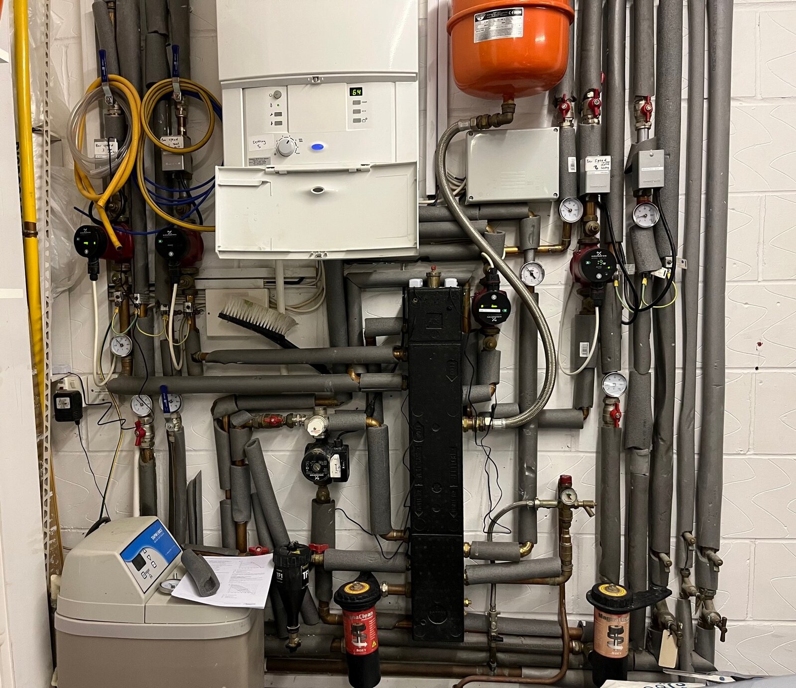

Hmm. Do you have any pics of the JG blending valve fitted (it sounds like) at the LLH?
And was this valve part of the original install or a retrofit? If it was a retrofit, what was in place originally to regulate the water temperature in the UFH setup?
The 'usual' setup with UFH (as I'm sure you've discovered) is for the supply pipes to be at system temperature (55 upwards), at the UFH manifold there'd be a separate pump (circulating within the UFH pipework only) and a blending valve which keeps the UFH tubes at temperature by bleeding in heat as needed from the main loop.
EDIT I'm starting to think you might be onto something with your theory. If the blending valve is at the LLH there'll be a comparatively large (20-30 litres maybe) of low temperature water heading to the UFH and returning to the LLH and thus the boiler. If the blending valve is at the manifold, that 20-30 litres in the pipes of hot system water becomes part of your thermal buffer which will keep the UFH warm without firing the boiler incessantly.
I've attached a picture, you can see the little white valve above the black underfloor pump below the boiler in the middle. It has the flow and return connected to the valve.
This valve was connected as part of the boiler installation (retrofit) about 10 years ago now. I think originally the Geminox boiler would regulate the output to the heating circuits - and both the radiators and underfloor were getting the same output temperature. There are no blending valves on the underfloor manifolds.
Yes, this is not the usual setup as we had to install a separate underfloor pump from the LLH when we installed the new boiler.
