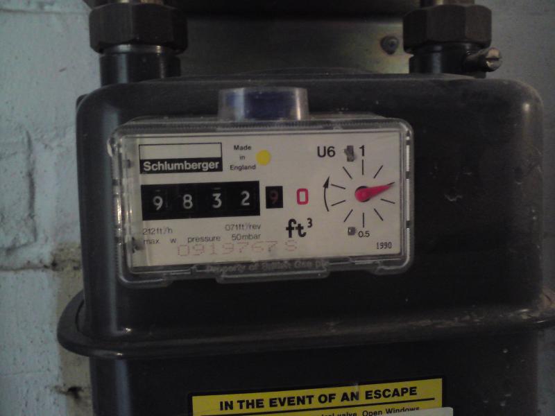

One hour in and no movement in the meter:
Pilot light now lit and CH/HW both off!
OK...half an hour in and the clock face-type dial (on the right) has now rotated 180 degs and is pointing at the '.1' position (i.e. the first mark after the 12 o'clock position).
Pic added for completeness:
Can anyone tell me how the clock face dial relates to the numbered dials?
ok..that's one hour give or take a few mins and the clock face dial has made just over one complete rotation from just keeping the pilot light going. Can I calculate consumption and cost based on that stat?
So there is no leakage, which is very good. ;)
The dial rotates once for each cubic feet of gas, so it has used 1.1-0.55 cubic feet = 0.55 ft³ in half an hour or 26.4 ft³ per day. this is equal to 0.264 units of gas (a unit is 100ft³) or 3028kWH per year, which is close to your figure of 4589, as the odometer may only click over in whole numbers.
The red dial has to rotate ten times for the red number to change by one digit.
Your boiler is certainly wasting a lot of gas and as it is seriously oversized a replacement may be worthwhile. Have a look at the Broag-Remeha range of System or Heating boilers.
