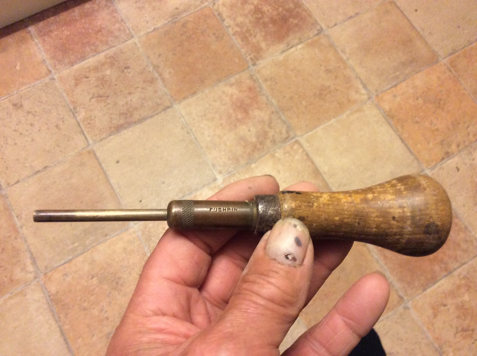

I still use my late Fathers. It dates back from the late 1950’s B493E156-C1B7-44AE-B888-2E43ACF04816.jpeg
I still use my late Fathers. It dates back from the late 1950’sView attachment 208101
I'd bet you can pass that on to your kids too and it will be working in another hundred years.
