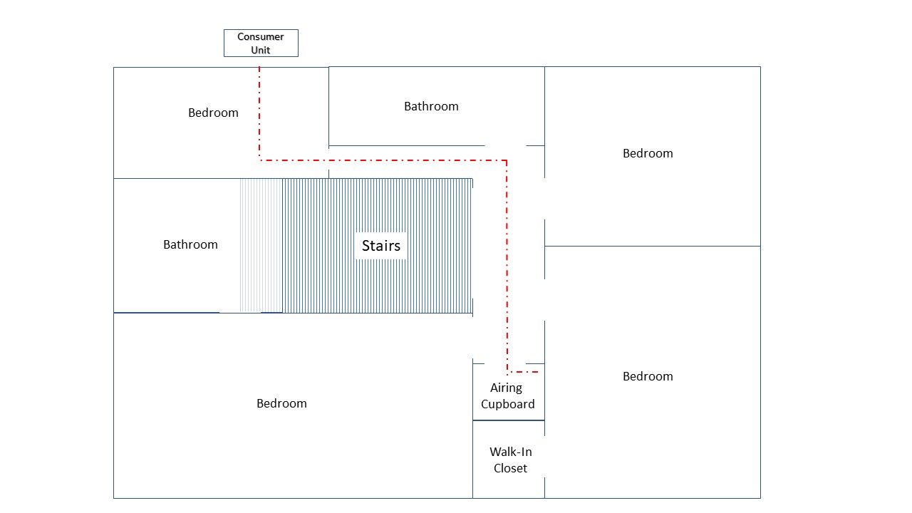

One other bit of advice i'd like is the proposed route of the wiring. I've mocked up how I think it will go and mindful of safe zones. I've drawn where the CU sits on ground floor and the route under the floor boards and then up to the loft via the airing cupboard. The airing cupboard is a tricky one, as the wires will most likely have to sit on the drywall in a safe zone and enclosed in the some trunking. I will also place the Immersion heater switch in the airing cupboard.
Could anyone advise if this is suitable given the type of cables I will be running through there? Lastly, is there a minimum distance that should separate central heating pipes from the wires under the floorboards?

Not sure exactly what you mean about safe zones in the airing cupboard. Visible wiring or wiring in visible trunking does not need to be in a safe zone.

oh ok, I was trying to explain that the wiring will be in the corner :LOL:
Normally there will be an existing cable route from the CU upto the loft (e.g for lights cable). It maybe worth exploring this first. (could be less effort - I dunno)
Doesn't help with you wanting the switch in the airing cupboard. You could always run a T&E down from the loft for switch. or put the immersion switch next to the CU
Mine seam to run near a bedroom light switch. (kinda in a safe zone).
Looking in the loft, you can sometimes get an idea of where a chunk of cables go down
Thank you for the input. I have considered the existing route but it would involve a lot of destruction to locate and feed cables through, which is not an option for me. Previosuly the cylinder was in the airing cupboard but it was recently moved to the loft, so my filling loop, pressure guage, honeywell control unit and hive receiver still remain within the airing cupboard, hence the rationale for keeping the immersion switch there. Also if I'm not mistaken, some cabling would be required to run the full length either way from the CU to the immersion heater irrespective of where the switch is located, just the proportion of flex vs 4.5mm TE would change?
