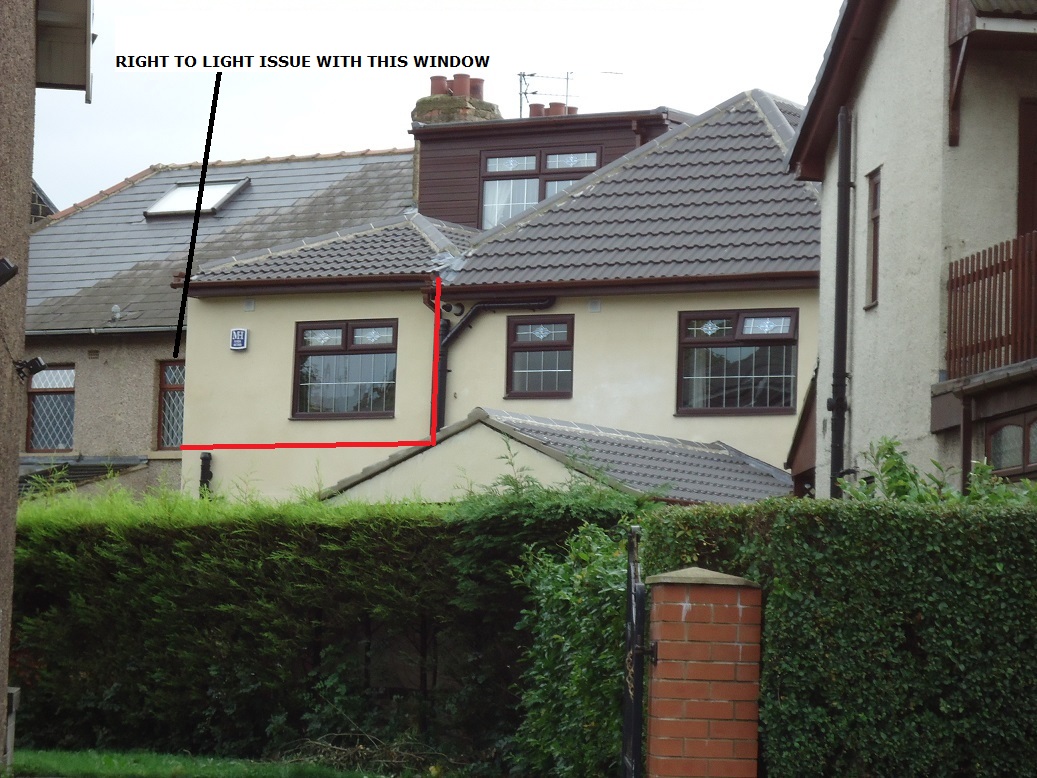

So the neighbor that complained, is it the same one who's garden your stood in taking the photo?

With regards to the extension it clearly breaches the 45/25 degree rule, but there are ways around that depending on other factors also looking at it a decent planning consultant might have been able to negotiate an amendment to the building such as maybe forming a mansard roof to the neighbours side allowing more light in maybe combined with stepping the extension in.
should have been more considered at the design stage. I know you say your Arch said it was going to be Ok but he should have been more cautious knowing that it contravened such basic principals.
Don't post the planning details, but what were the reasons given for denying permission? Verbatim please
It's not clear to me that there is such a rule, that it does breach any rule that we don't know exists, that the room is a relevant room to which any rule applies, and that the centre of that window is know so as to denote the position of the reference line.

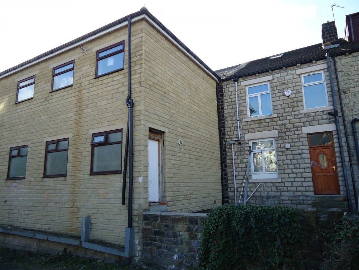

to give you a better idea ive added a few more pictures
the community centre extension comes out approx 5 meteres ours is only 3 meteres
Looking at your first picture - you've extended across the full width of your property, ground floor and first floor, you've extended up into the roof and you've extended back into the garden at right angles to the rear wall of your property? Anything at the side or front that we haven't seen?
the 2 storey extension was done on the side of the existing drive (planning approved), which is the right part of the main roof which is new, and then the left side (small roof) is what the enforcement is for, we had added a dormer in the loft (planning approved) , on the front side nothing had been done.
