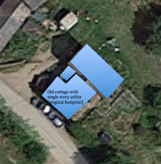

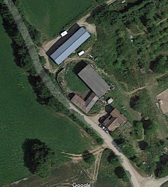

This is the layout from above, Hopefully my (rubbish!) additions in word make sense.....
Pictures-

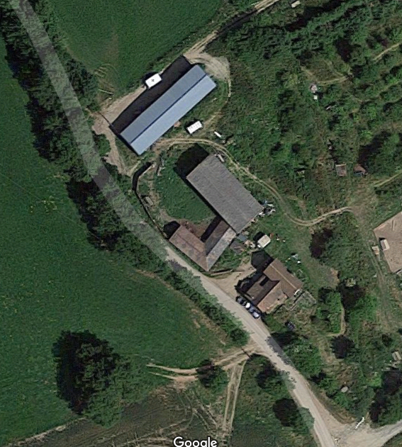

House1 - The two big rectangle grey buildings are dutch barns (open-sided) straw barns, the L shaped brown roofed barn is an unrenovated cow byre (also straw) the smallest brown roof is our house.
House2 - the house without my annotation!

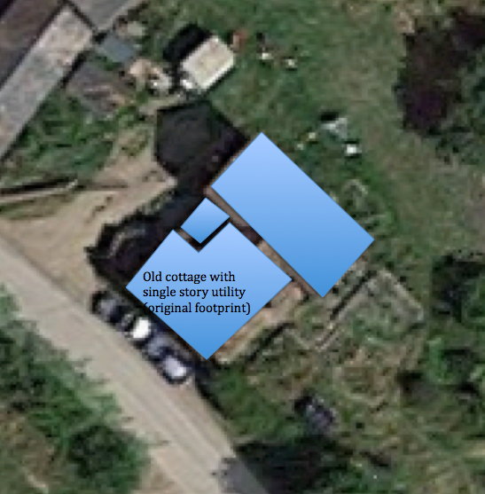

House3 - the 3 blue boxes are obviously joined together to make the house but I couldn't change the colour of the shapes so left a gap to distinguish them. The box nearest the road is the original 2 up 2 down cottage with an original footprint single story utility at the back. The other big block is the '79 extension and the smallest block is a back hall/porch (single story, flat roof) also added in '79.
Our plan is to build onto the bug '79 block, making it more of a square (from above).

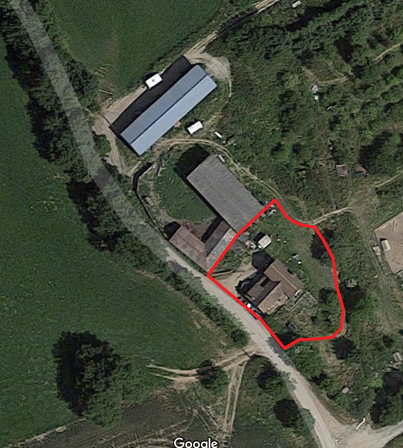

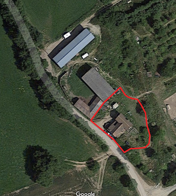

Is there a way I can find out how much of our land is the curtilage and how much is agricultural? Would it be as simple as taking off the land that used to be eligible for rural payments?
For the purposes of the GPDO, there is no hard-and-fast interpretation of 'curtilage'. There are appeal decisions going both ways concerning extensions to houses in large grounds. It seems to depend on individual inspectors' opinions.
While this opinion carries no legal weight, I think it would be reasonable to consider something like the area shown within the red boundary on the attached image as 'curtilage'
