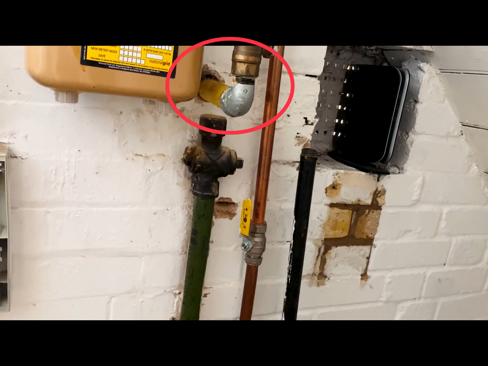

That reminds me:
In 2 of my flats the annual gas check lists earth bond as 'missing or incorrectly fitted'. with both the bond is after the first tee...
Because the same fitter installed a new tee so close to the meter there is no space for it before.
But of course the good tenants read their copy and panic. I have sent reports and pics to gas safe but it made no difference.

Nice.
That reminds me:

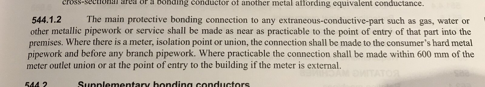

I’ve just reread the regulation, and it’s a strange one.
It seems to be saying that the 600mm rule should be applied where possible but common sense may be applied if site conditions dictate, but the connection must be before the tee with no exceptions.
I have also seen gas meters where a tee is soldered directly to the meter union. For me a connection just past the tee but still at the meter is no problem at all. Maybe this is where the regs prove they can not possibly cover every single real world scenario.
Yes that's the situation, one has the tee directly on the union and the other has an elbow directly on the union and the tee.
My agent doesn't understand so it's me gets to explain to the tenants.
I have even photocopied and laminated the reg with a photo of the fitting for both properties and anotated which is part of the 'flat pack' left in the flat for the tenant.
