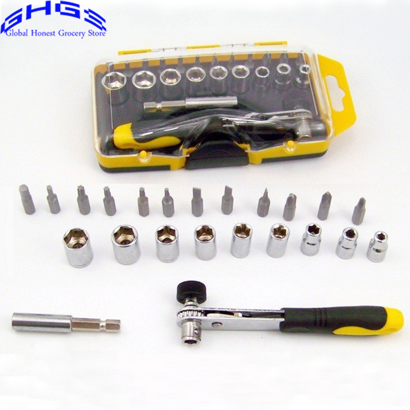

Do you have a small socket set?
Looks like you 'may' be able to get a socket on the hexagonal outer!
I have one of these...
