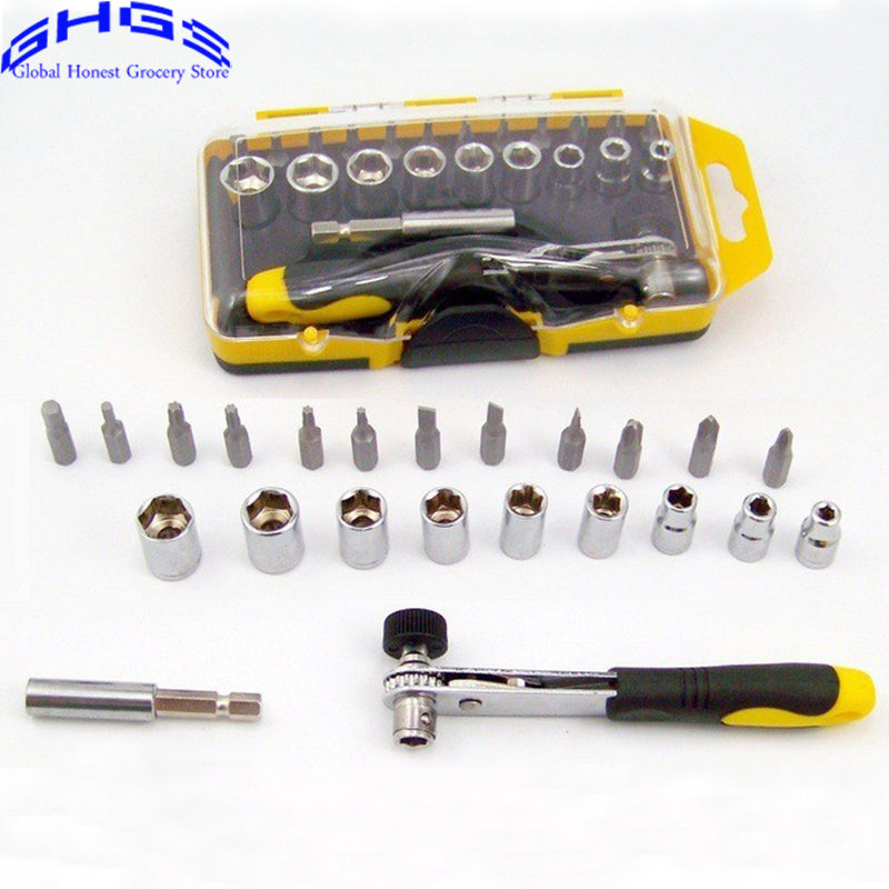

Do you have a small socket set?
Looks like you 'may' be able to get a socket on the hexagonal outer!
I have one of these...
I've got one too mate. But I'm not sure if the ratshit is that good?
It was just over 2 quid in Maplins.
Mine's a decent branded one (in fact I have a couple of them - different designs) but I know what you're saying, just thought he might have a better chance, getting one on than an ordinary socket wrench, due to space restrictions! Worth a try with normal one first though!
Yes I did try this but the screw head is flash with the brass part of the boiler if not slightly under it so there is no room at all to use a small socket set there. Unfortunatly I don't heve a dremel. In few ocassions I need one but always a bit expensive to get a good one to use only occasionally.
