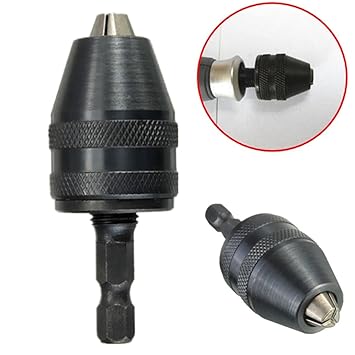

However, I am totally bewildered as to how fix a drill bit in it if it only accepts a hexagonal tool holder? Are there drill bit holders which are hexagonal at one end and accepts various diamter drill bits at the other end??
If there are, please advice what they are called? etc.

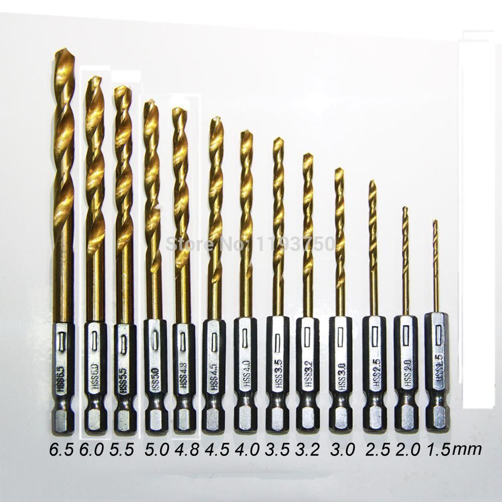

There are drill bits with a quarter inch "hex shank", AKA "quick chuck", "lock'n'load", Trend's "snappy" range and various other names...
e.g...
Milwaukee HSS shockwave...
remote.axd
Addax flat wood bit...
Masonry bits, too...
And if you're really stuck, a hex shank chuck adapter (usually only for small sizes though)...
a whole new world to me :D ))) Thanks a lot rsgaz!
hex shank chuck adapter looks good but I worry it might a bit heavy and lead to conical (rather than purely centralised) drill movement. I notice this conical movement even on hexagonal screwdriver bits, which is not crucial for screwing, but might be crucial (bad) for drilling.
Yeah, they all wiggle a bit, there has to be some play/movement or you'd never get the bits in and out. Fine for drilling wood/plastic or thin sheet metals though.

I thought the first pic (Milwaukee HSS shockwave) was a drill bit in a holder (cos chuck colour and drill bit end are of different colours - silverish and dark grey (or black)), but I now figure that it's just a drill bit, meaning that for every hole diameter I will need to get a different drill bit (or buy a set of them).
I actually wanted to use standard (circular) drill bits, of which I have plenty, and just buy a single universal holder that would fit into the drill driver. Now I realise that for this purpose hex shank chuck adapter is the only solution.
Yep, it's a single piece of steel, milled into shape, which is why they're strong and good quality (and therefore expensive, of course).
Whereas, look at the rectangular indent on these cheap made-in-China ones, they have taken ordinary drill bits and crimped them into the hex part. They are weak and will break very quickly, so don't buy them unless you literally only drill plastic or softwood. Just get the chuck adapter like you say.

I've bought one of those hex shank chuck adapter on ebay and tried a 6mm drill bit in it - it wiggles like hell and the wiggling diameter is more than twice as large as the drill bit size. I haven't trying drilling yet (just in 'open air'), but hope that touching a "to be drilled object" will reduce the wiggle, otherwise the chuck is useless.
It might centre up ok but there's a slight chance of a reamer effect occurring. What is it you're looking to drill and how accurate do you need to be?
Most often I will need to drill holes for plugs in brick/concrete wall, 6 to 8 mm, so if I drill M6.0 I would need the hole to be nore more than 7-8mm (probably more like <=7)
