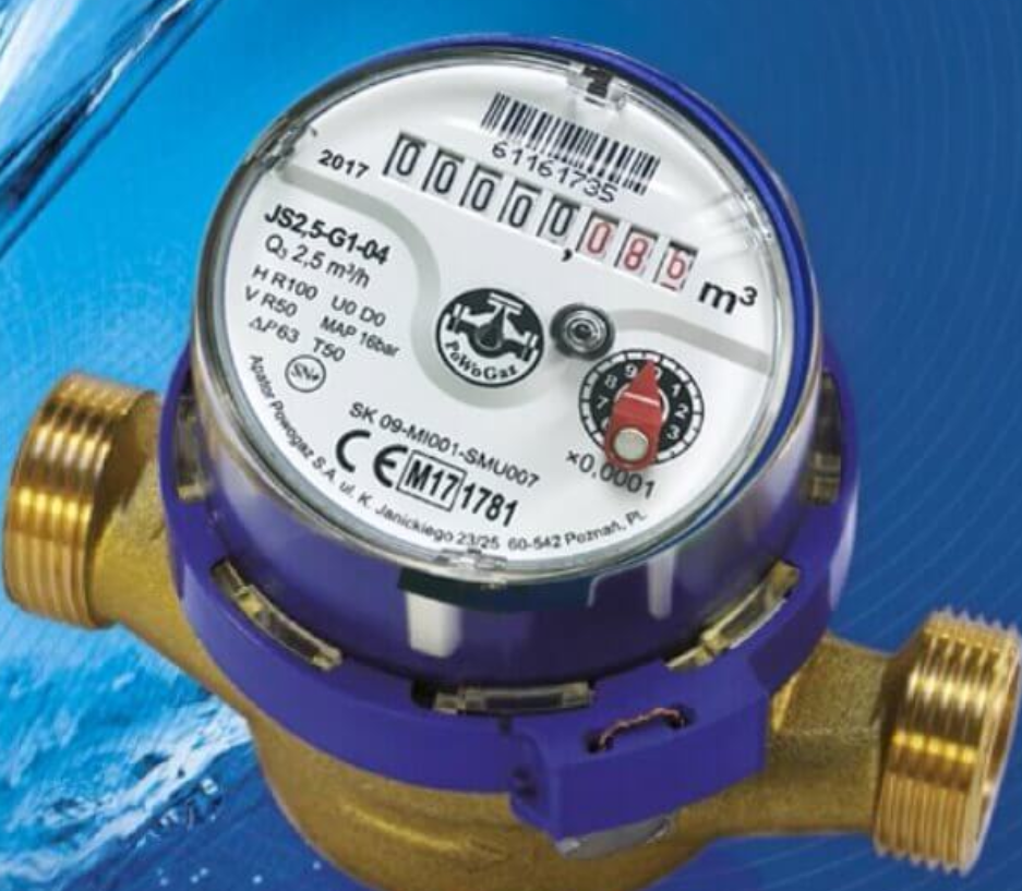

I did wonder as our water bill is a touch more than other people I know, but I did the test back in the summer with the meter and there didn't appear to be an issue. That being said, perhaps it's smaller enough not to register on the meter.
Is it the type with a little bubble spinning under a glass window?
A bit like this.
