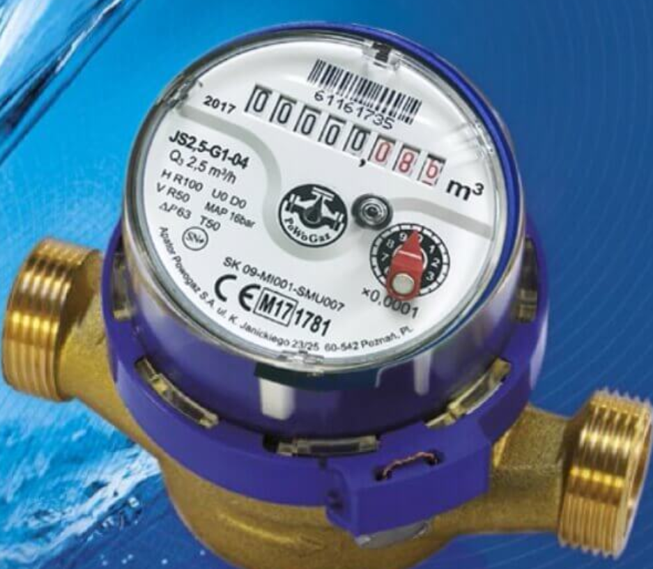

I haven't used that type, but the little red indicator looks pretty sensitive. I can't see a bubble.
The objective is to search for almost imperceptible flow, not easily detectable on the digital counter, that does not stop even when everything is turned off, no cisterns refilling.
Turning the inside stopcock off will tell you if a leak is upstream or downstream of it. Turning off the stopcock on the meter will verify if a leak exists. Even a slow drip will cause damp, if it is 24 hours a day 365 days a year. Some leaks are not noticeable as they evaporate into the air (but leave green stain or limescale crust behind). If you see any marks, polish them off and watch to see if they return
