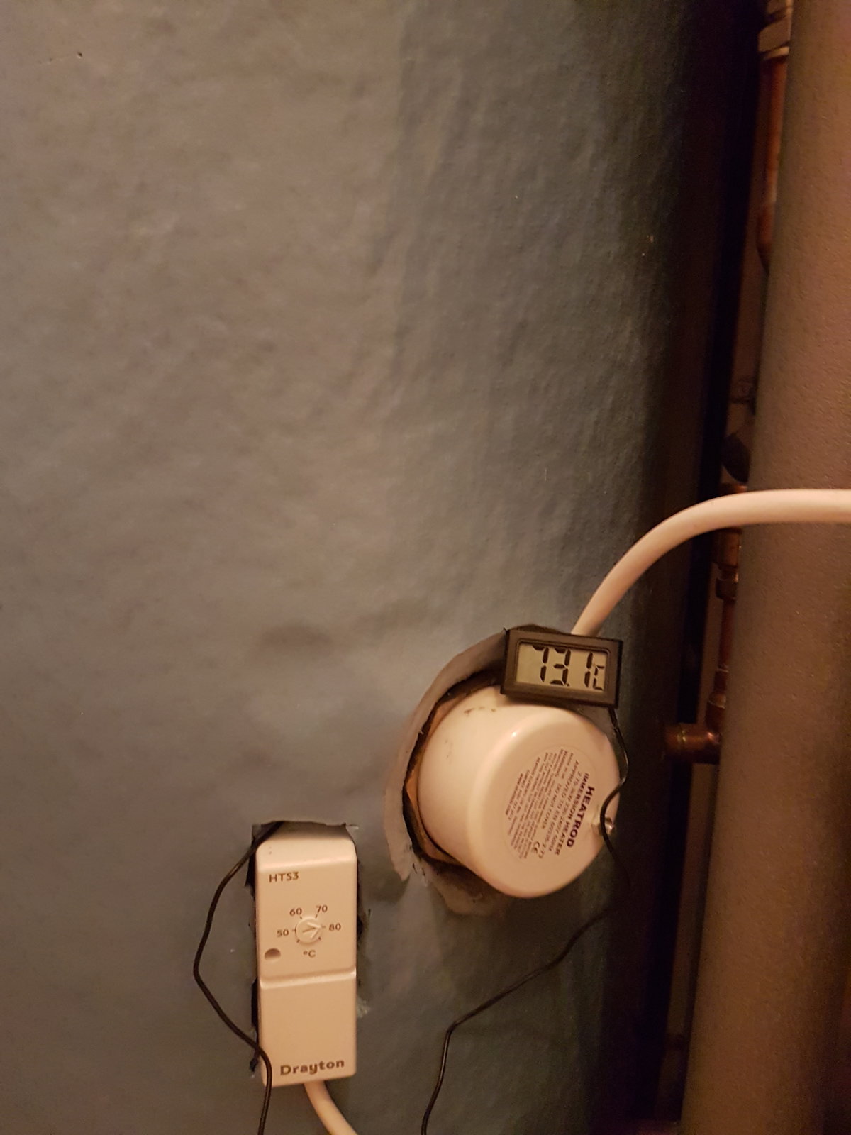

Ok an update for anyone interested.
First of all my plumber did a runner on me. I had lost my patience after waiting 7 weeks and paying him 95 percent of his money up front he didn't like it when I said I wanted it finished this week. Walked away with a badly leaking bottom connector caused by him attempting to fix a leaking compression joint which in turn twisted the solderered joint. And left us with no heating as we ran out of oil as he was paid to move the tank also.
Anyway a very professional local plumber stepped in and fixed this issue foc and will help me rectify the other issues.
The thing is I shouldn't be on here trying to understand what takes people like you lot years to master but my plumber just instilled me with zero confidence esp when he was plumbing the heat leak circuit he had no idea about and was using ptfe on the compression joints to the Log burner :( and until prompted running the pipes from log burner downards to skirting first.Luckily it was picked up on and corrected. So I'm in the process of trying to reclaim some money as it transpired he wired it as a conventional system not a hybrid as I requested and when I started to realise this and raise the issue he did a runner.
Moving on now I've fitted a small thermometer to measure the heat store temps just to check it's not going to 'kettle' and all is good. I had a few comments my log burner was too small too big heat store too small. But I've found so far..
With Log burner running i observed the following:
Thermal store max temp about 83-85deg c.
Running a Bath drops by about 10degrees c
Running a Shower about 5 degrees c
Fired up central heating pump which basically pumps pressurised circuit through secondary coil in heat store. Temps held ok hovering around 72 degrees without falling. So in essence all looks good.
This little 3quid thermometer of Amazon has been a revelation demonstrating how well my store is functioning despite how it was all left for example see attached pic no strap to the stat thermometer I found it on the floor not even pushed into the hacked hole looks like he used a spoon to cut it out.
So we just need to tweak the system to work as a hybrid and I'm almost there.
