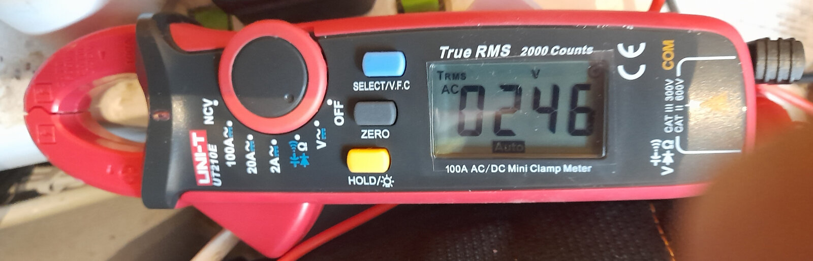

To hire around £50 as they need re-calibrating on return, to buy around £300. A multi meter to measure down to 0.001 amp AC and DC non contact is around £35, the same for a insulation tester, Testing voltage.jpgVC60B.jpg but to measure low ohms using the required 200 mA, the loop impedance, or the RCD tripping times means spending out a lot more money, likely best option is to hire?

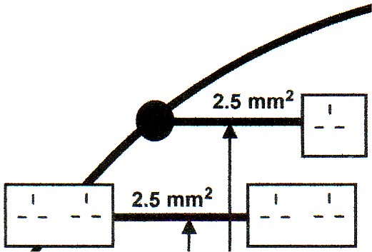

I have looked for where it says only one device allowed on an un-fused spur. APPENDIX 15 (Informative) seems to be only place. 1692444339904.jpeg
Unfused spur:- An unfused spur should feed on single or one twin socket-outlet only. An unfused spur may be connected to the origin of the circuit in the distribution board
since this is "Informative" not sure if can be regarded as a regulation?
I think this may put the pidgins where the cat is? Now I can sit back and watch the sparks fly, pun intended.
No. The guidance needs to simply say a single accessory is the spur.
That's effectively what the guidance says - one single socket or one double socket or one FCU. What other accessories did you have in mind?
As it stands is far to open to interpretation
Eh?? - see above
However, as I've said, this is only guidance. The regs say nothing about any restriction but seem to imply that (any number of) "accessories to BS1363" may be connected to a ring final "with or without unfused spurs".
As I've just written, the regulations do not say that anywhere. As you go on to say, that suggestion only exists in the 'informative guidance' of Appendix 15 - and, as I've also just written, 433.1.204 (which has a different number in the obsolete version of BS 7671 which you quoted) certainly seems to imply that any number of accessories to BS1363 can be connected to an unfused spur.
