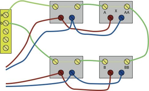

Here b-B is the cpc for one circuit, but b-B-BB-AA is a PE (oops, protective conductor). So part of the PE (oops, protective conductor) b-B-BB-AA is also the cpc for one of the radials - not the radial it's a PE (oops, protective conductor) for.
So the length of conductors a-A and b-B are 3 things each :
The cpc for it's respective circuit, a protective conductor (PE) for it's own circuit, AND a protective conductor for the other circuit.
The conductor AA-BB is part of the protective conductor for each circuit, but not a cpc.
Again, I see no reason a single piece of wire cannot perform two functions at the same time - in this case acting as the cpc for protection against shock as a result of faults, and as a protective conductor (i.a.w. 543.7) for protection against shock due to earth leakage.
