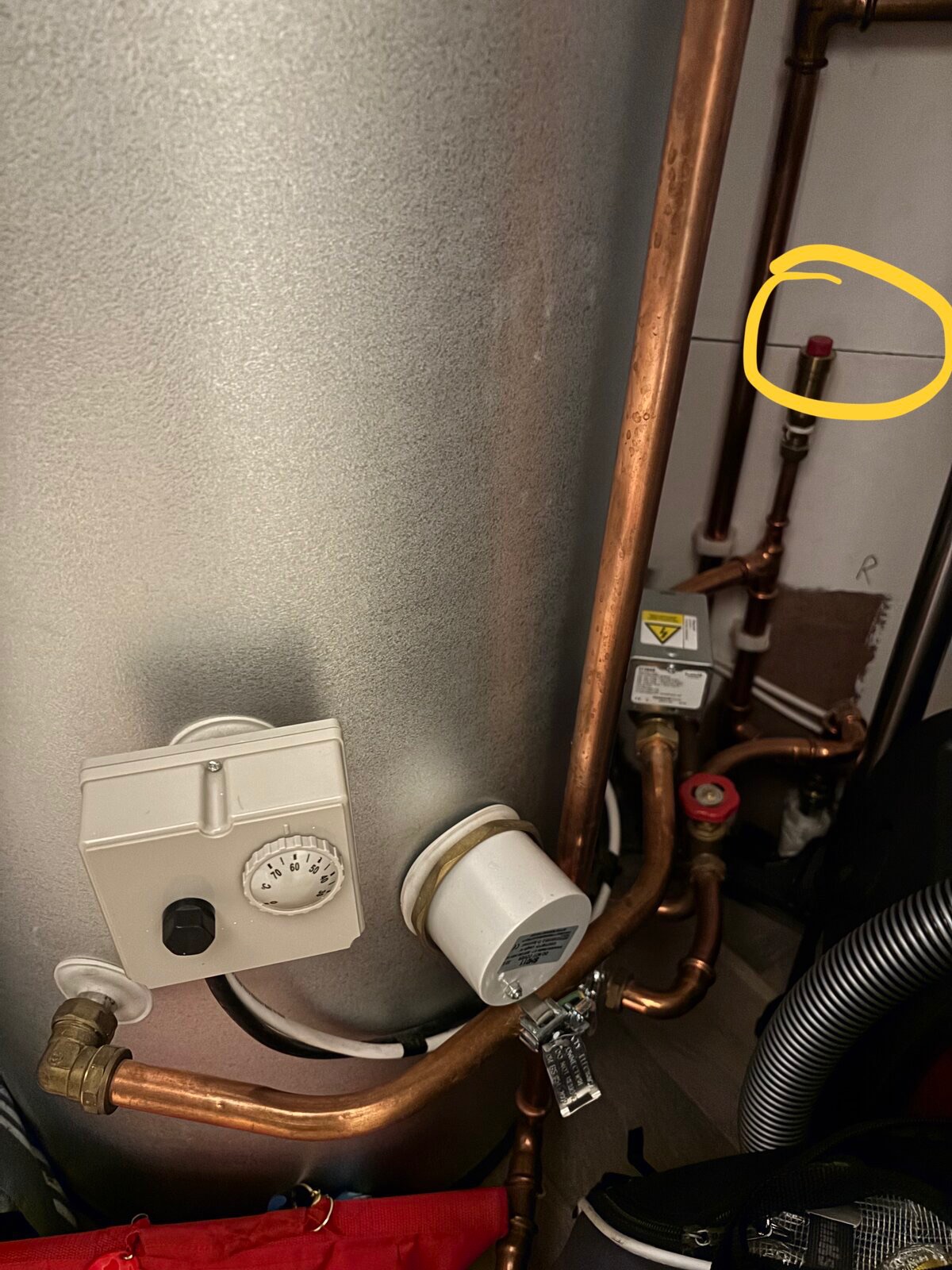

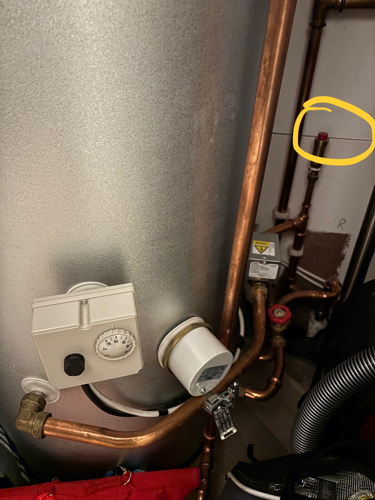

We’ve bled the radiators but no vents on any pipes. We’ve been a bit reluctant to do much with the pipework around the hot water tank / underfloor heating manifolds in case we muck anything up (complete novices but off the back of all this I’ll be moonlighting as a plumber fairly soon!) will take a look around the diverter valve… what sort of thing should we be looking for to bleed?
Using a cloth, towel or similar, This (circled yellow) and any other air vents should be turned counter clockwise to open and should expel air, if you get water then there’s no air trapped. Turn clockwise again to close.

Ok, identified the automatic bleed valve on the pipe near the diverter valve, unscrewed it, some water came out, screwed it back on. I assume this counts as bleeding it? Will see if that makes any difference.
Didn’t see your most recent reply, yes that’s the valve we unscrewed, so seems like that’s all fine! Thank you

Just to (hopefully) round out this saga - I think we finally got the problem fixed.
We managed to get the plumber over who originally fitted the system for our builders. He was only here about half an hour and identified that one of the valves on the boiler was closed. Not sure how that happened, possibly my husband accidentally moved it when he was increasing the water pressure after changing the radiator. Anyway, plumber said that with that valve being closed the water wasn’t getting away from the boiler quickly enough. He reckons that’s caused all the issues.
