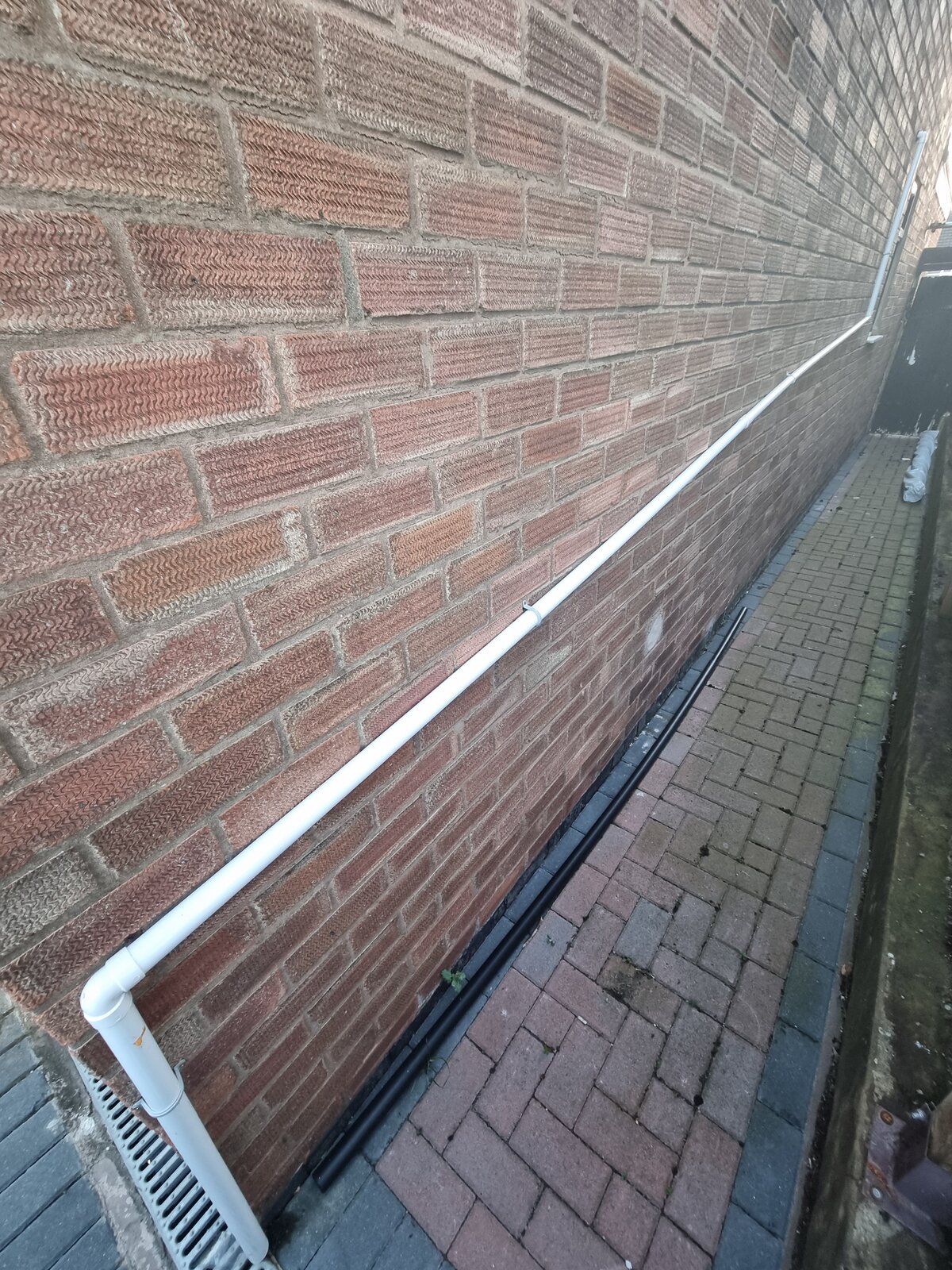

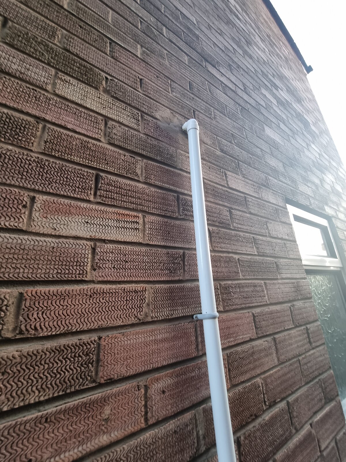

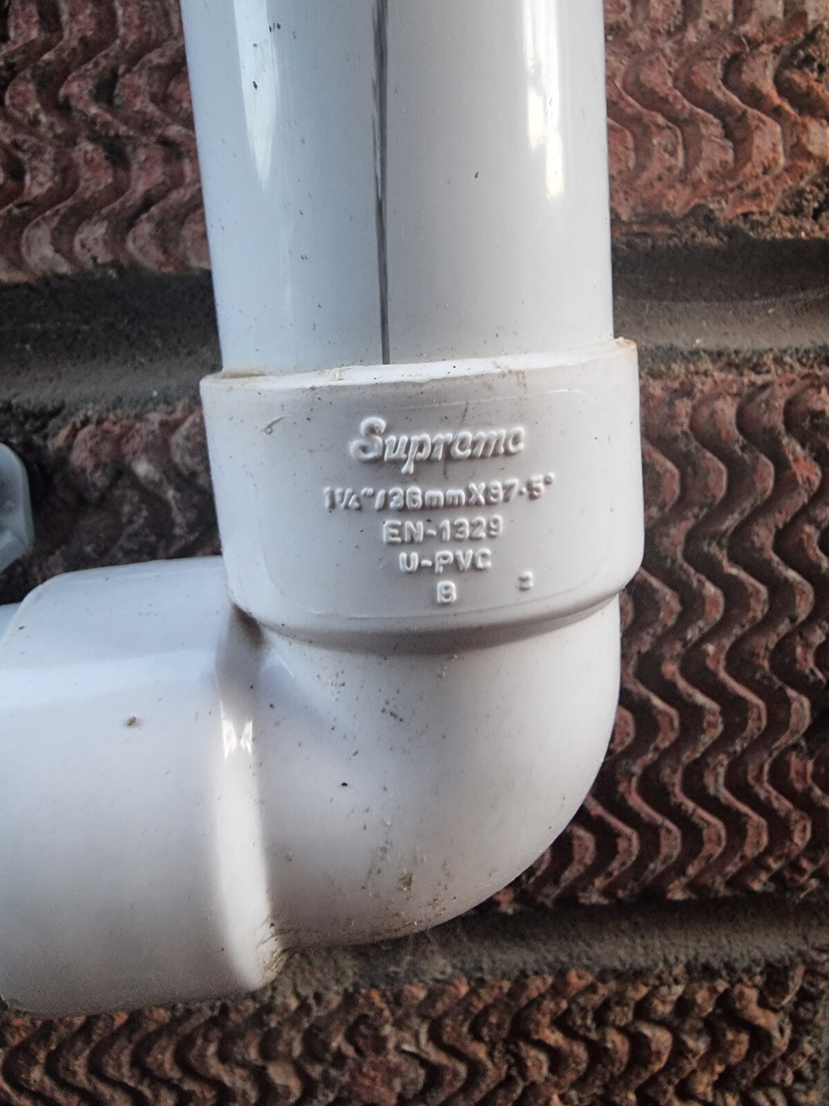

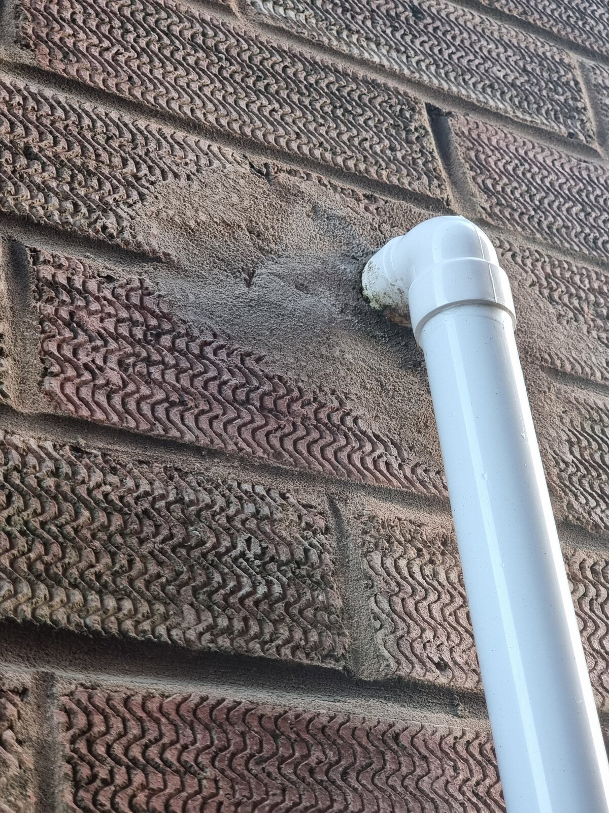

The previous picture of the condensate pipe was (unhelpfully nightime picture) from the outside, they'd left it like this and not patched it up. Below pictures are more cenent since they cemented/ filled in over the brick.

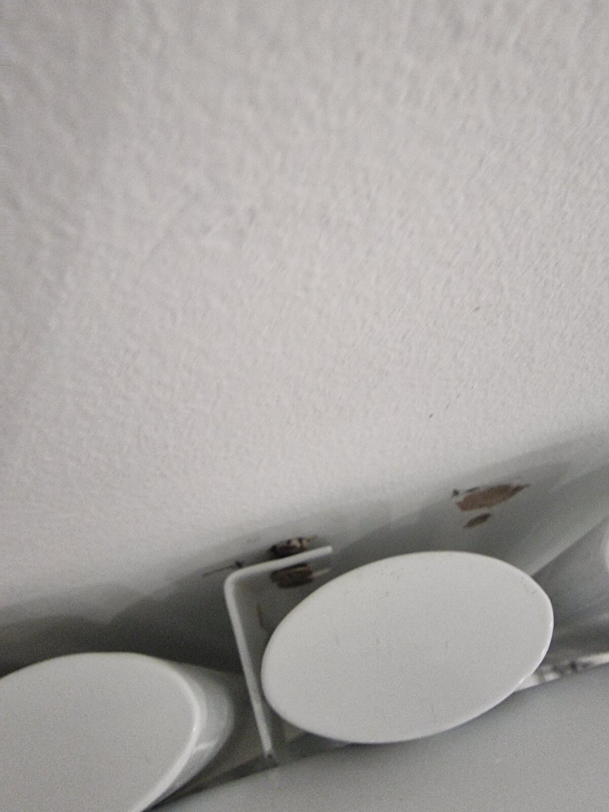

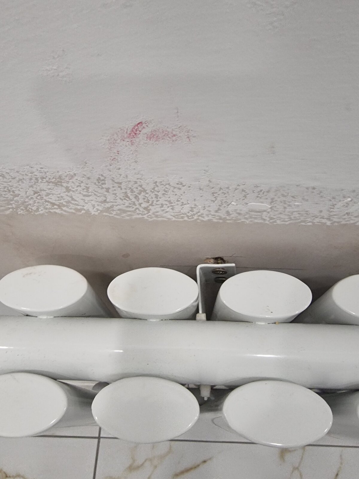

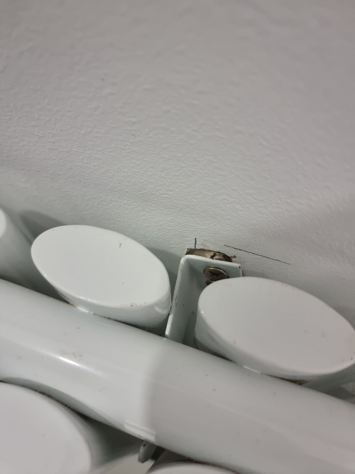

The pictures of the radiator coming away from the wall are after being charged an additional £375 to have them reinstalled, they were left in this state, and that work was done by another engineer at the same installer firm. We felt a bit cheated by this as some of the work in this job was left over from the install that was already agreed in the original quote too.
To his credit the third engineer that came last week reinstalled them really well and was here for roughly 6-7 hours, it took an hour to drain the system each time. Drained twice, once put cleaner in and then inhibitor. He set the boiler flow temp on CH to 75 from the original 62 from installation said it's better for these types of radiators to heat up faster. He said previous engineer only used small plugs not suitable for plasterboard, so used deep plugs that go past plasterboard into the brick wall behind.

Can I say the condensate pipe looks horrible on the side of the house would be nice if we had any other options.

From what you have described, you need to be 'going after them', for that, and very much more, including paying someone to deal with that flue install, as well as the damage to that joint, plus the other minor points you raised.
