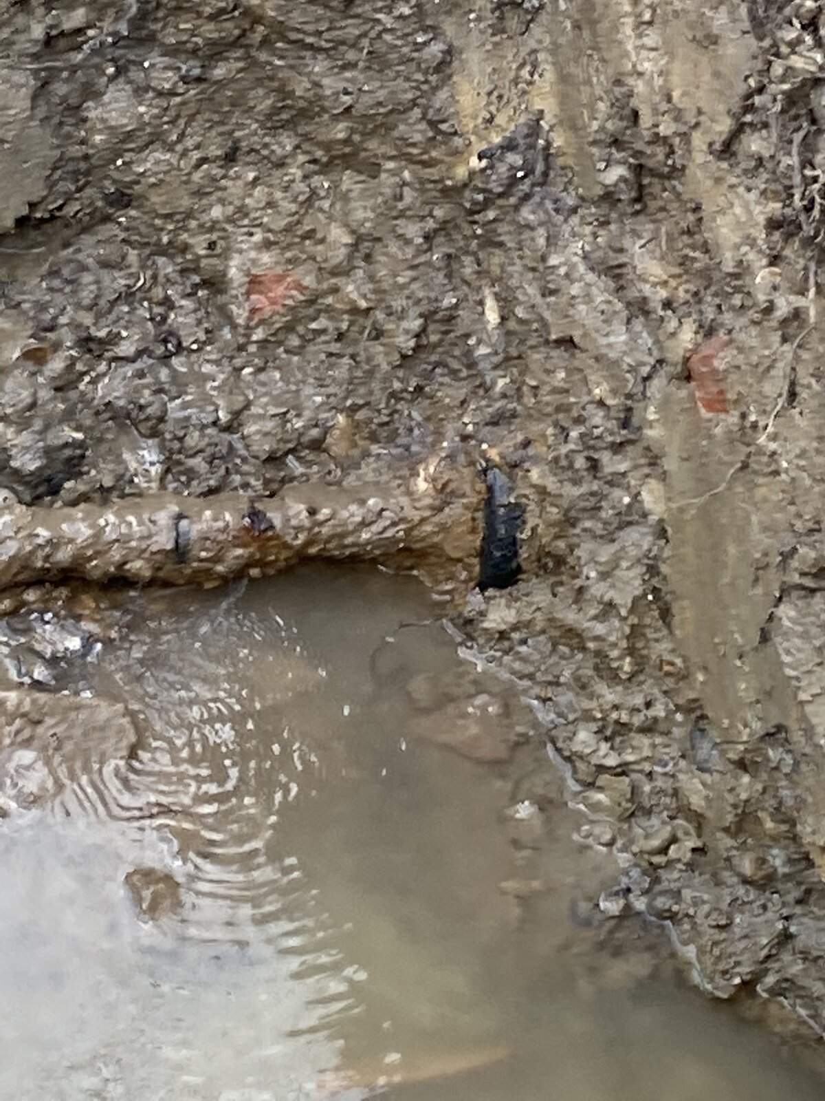

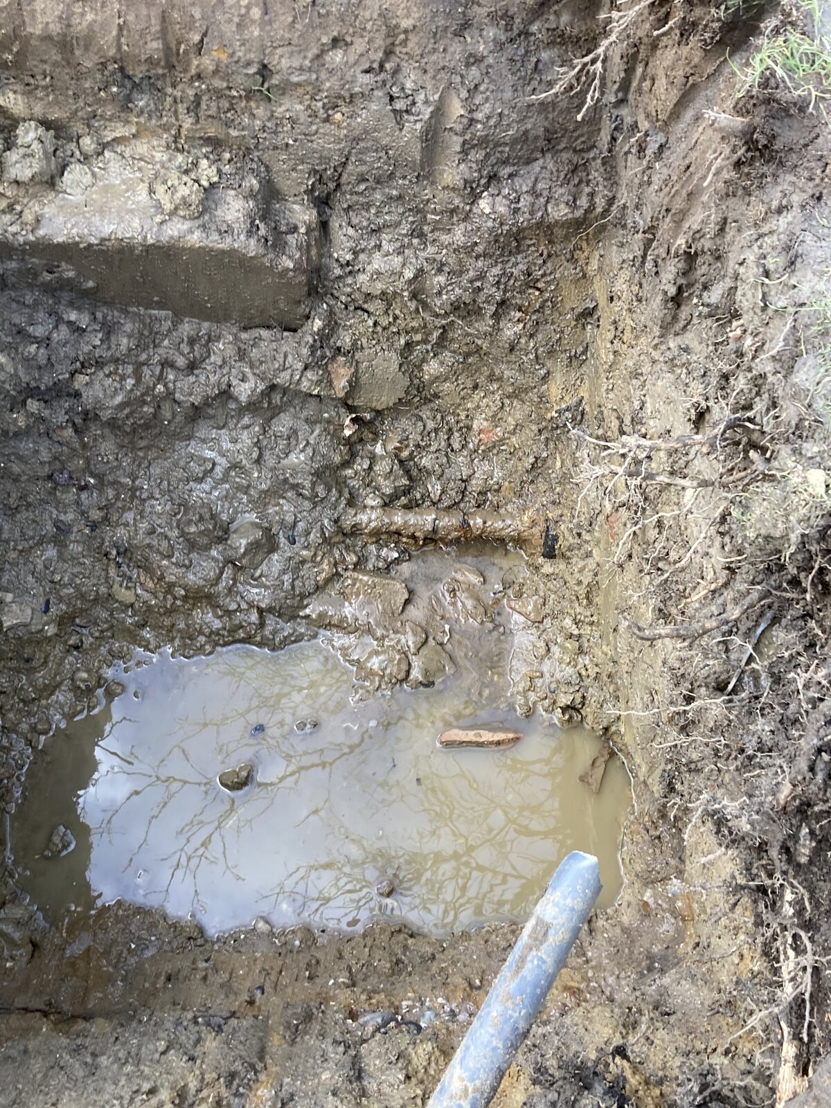

Found the leak but not fixed yet. Heavily pitted iron is a nightmare to work on.
You know that course don’t you Andy?

TBJ. You locate the suspect area & just dig. I pump the water out as I go. When you get to a reasonable depth, you allow it to pool with water, stir the water up so that it’s muddy then study the water carefully looking for little trails of clean water appearing through the muddy water.
Follow the trails!

So how do you go about repairing iron pipes, or do you?
I'm thinking if it's rusted through in one place it will be almost rusted through everywhere?
That's what I was thinking!
