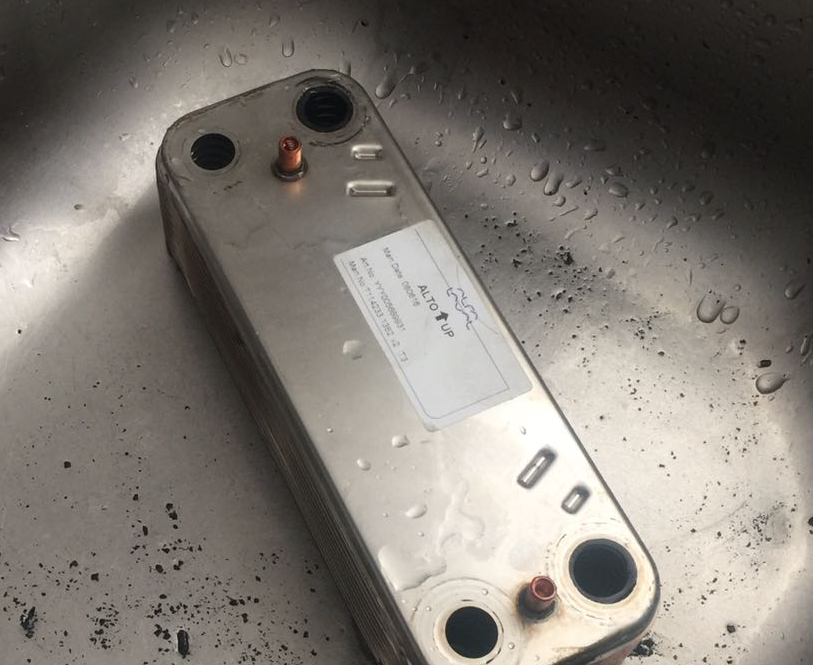

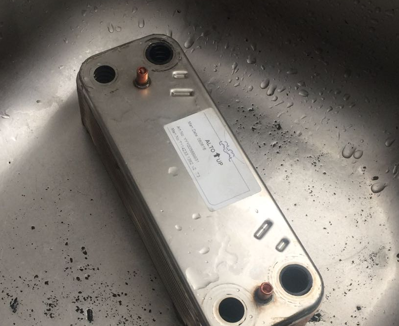

I have a micro-bore system on a potterton promax combi he plus boiler. i've got a protection plan with baxi and they send out engineer if something is wrong. recently, the hot water started fluctuating and kept going cold and hot even though that was the only running tap, and also the boiler pressure kept dropping.
So I called Baxi and they sent an engineer, regarding the pressure dropping he said that there is a safety mechanism and because of that the pressure is dropping he topped up that part in the boiler with air with his pump, i have no idea exactly what that is. But in regards to the hot water problem he changed the part in the attached picture and also wrote an advisory note which is also attached in a picture. He said that we need to get the system flushed and cleaned and a filter installed otherwise if sludge related problem happens again they will not fix it.

the filter is as you thought magnetic ,and gets fitted on the central heating pipework near the boiler on return side. the part fitted is the domestic hot water heat exchanger ,which when sludged up inside don't work well. chemical cleaning involves adding the cleanser into the c/heating ( radiators) side. you run CH as normal for a week or so, drain and flush and do it again if need be.then add inhibitor into newly introduced water. p.s this is the basic version.

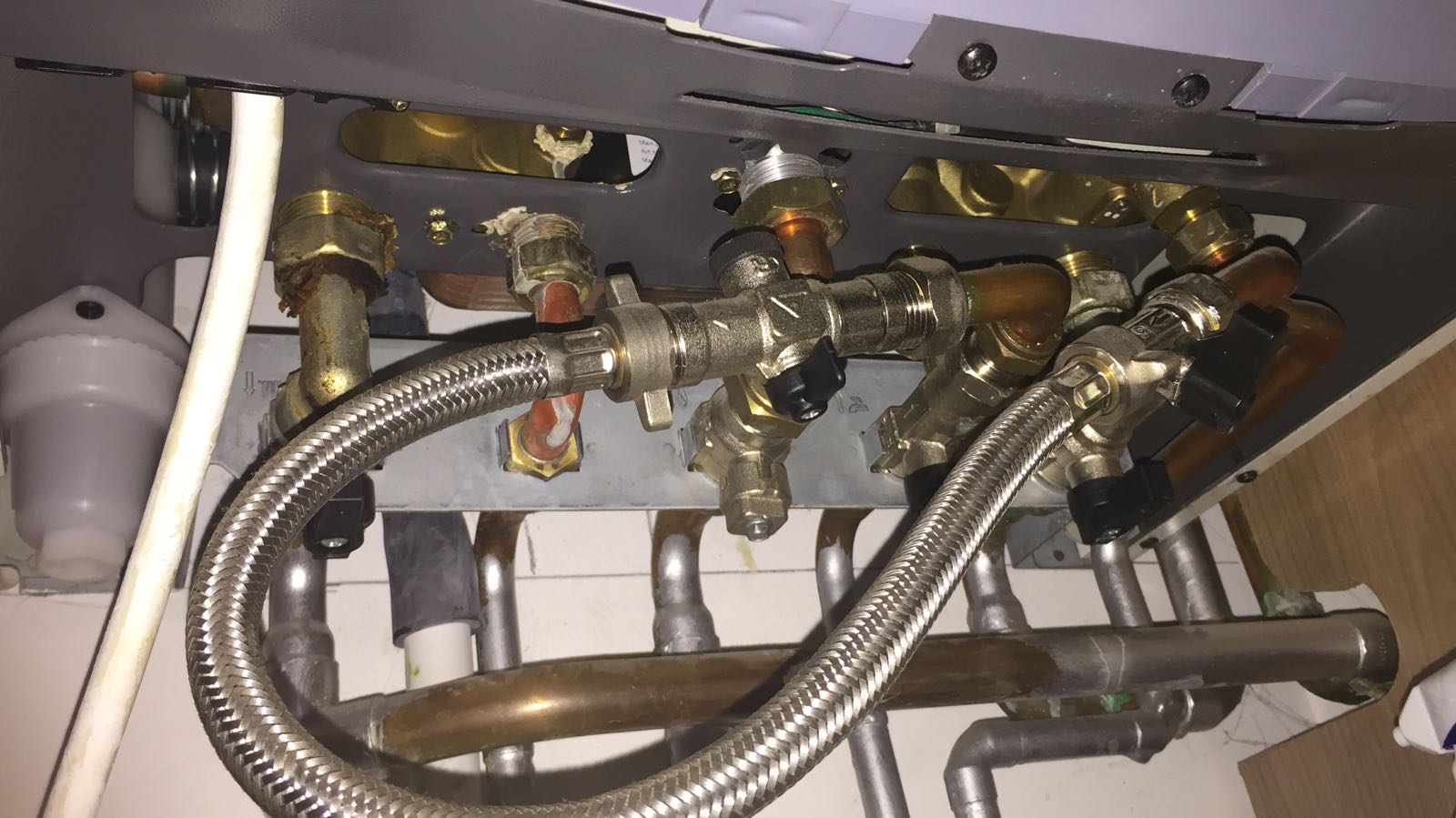

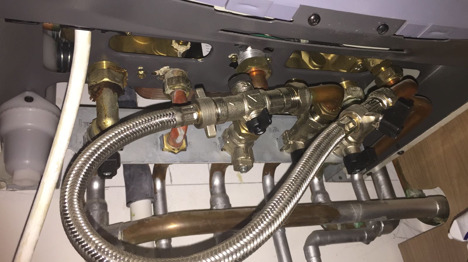

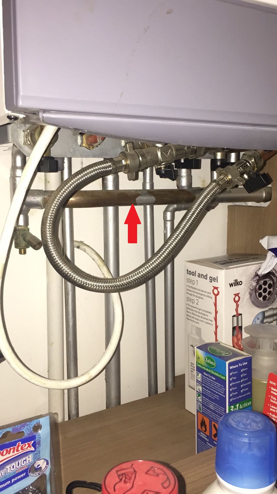

Also, can someone help me identify which pipe under the boiler I need to cut and install this magnaclean on to? I have attached a pic of the pipework under the boiler. I will drain the CH system using the lowest possible radiator. I have drawn a red arrow on on of the pictures showing which pipe gets hot when CH is on.
f56adae8-0ac9-4208-a0c2-2e7265528ba3.jpg 4c1616c2-f314-4095-89e3-a4e3a133f152.jpg
The cheaper one is the old version, I'm surprised SF are still selling it. You want the Pro 2. You'll find it for £83 on a popular auction site.
The Magnaclean should be fitted as close as possible to the boiler on the return pipe. Pull out the manual for your boiler and locate the return pipe. Make sure that you leave enough room to lift the cap off the magnaclean for maintenance.
You may also want to double check that your pipes are 22mm to the boiler. Can't quite tell from the pic.
