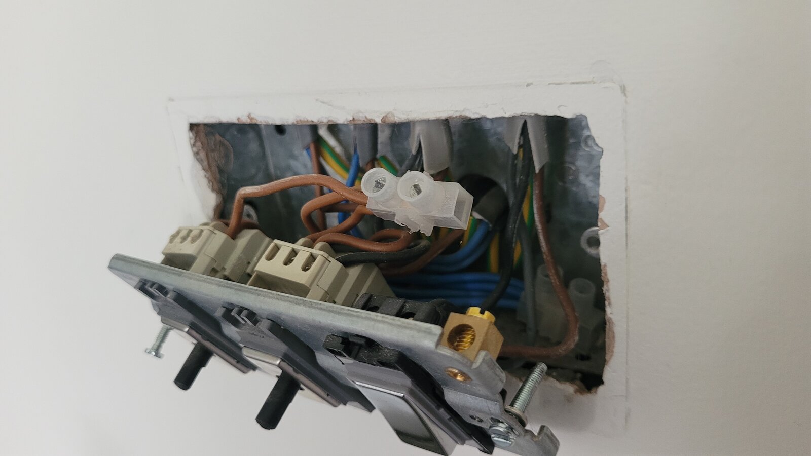

We have a largish empty shelf 40cm above the sink in our bathroom where the wife wants to have an illumintated LED mirror. The mirror is planned to be 1200mm wide and the power ratings for various styles vary between 36W and 60W.
The closest power source I've found is a light switch on the other side of wall where the mirror is supposed to go. As its just behind the wall, it would be the neatest installation.
The switch is a 3-gang one with 2-way dimmers and a 2 way switch, looks like this:
Would it be OK to take power from these switches for the mirror?
Thanks for your reply folks. The neutral is there as seen in the pic.
So it would be a quick connection by clubbing the mirror cables with neutral/blue and permanent live/brown connecting strips in the switch?
Looks ok but the metal grid needs an earth connection. Depending on what the switch contro!s you could switch the mirror from it
Can I not use the connector strips (for live and neutral) as a permanent connection without a switch?
The mirrors we are looking at come with either an internal switch in the cabinet or motion switch or touch sensor.
I doubt if the mirror cable will come with an earth but if it does, I will connect earth to the back box and/or the current earth connections within the switch.
Yes take a permanent supply from the live and neutral, taking a switched supply was only a suggestion in case it was needed to switch the mirror on from the wall switch
