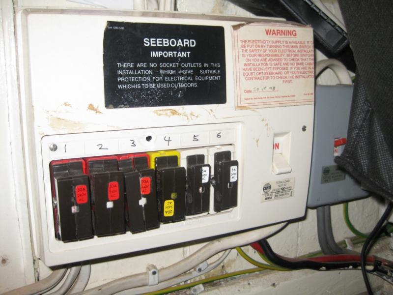

However I was kindof hoping someone on the forum could answer my first question, i.e. is it permitted to run a new circuit in to my old CU with it's old style cartridge fuses? Or do I need a 17th Edition CU.
Maybe electricans read this forum or is just DIY peeps?
PB
I personally do not like adding new circuits to re-wirable fuses. New circuits are required to be RCD protected unless certain conditions are met, like in a previous post where SWA was mentioned but even then, you will be going outside of the property so RCD's will come into play.
How many spare slots do you have on your existing fuse board?
Is the bonding and Earthing up to standards?
When was the last time that you had an condition report carried out on the property?
Have any alteration been done on the electrical installation?
Could you take a picture of you fuse board and post it here? may give us a better idear.
Hi
Photo attached.
Its a 6-way, I have at least 1 unused way.
Its got a installation sticker dated 1993, I dont imagine its been looked at since then.
No alteration have been done on the electrical installation and on that basis I would say I believe the bonding and Earthing up to standards.
Regards
PB
The big black sticker on the fuse board answers your questions. I would of preferred if it said "Electrical equipment outside of the property".
Thanks.
Do I need to replace the whole board or is there way of taking a feed off the single unsed way in to a "mini RCD", Just seeking the cheapest solution, Thanks
Yes.
It is also permitted to install a new fusebox containing cartridge fuses. Or even rewireable ones.
The point is - whether it is permitted or not depends on the circuit which is being installed, not the type of protective device.
A circuit being installed outside does not automatically mean an RCD is required either.
As for building regulations, you can legally build an entire house and install all of the services and equipment contained within - provided you are competent to do so and follow the relevant procedures for notification.
Why would a permanently fixed air conditioning unit fed by SWA cable need an RCD? The fact that it is outside is irrelevant?
Regulations aside, I would personally have thought it wise to have RCD protection for an item of electrical equipment that could possibly fill up with rain water.
