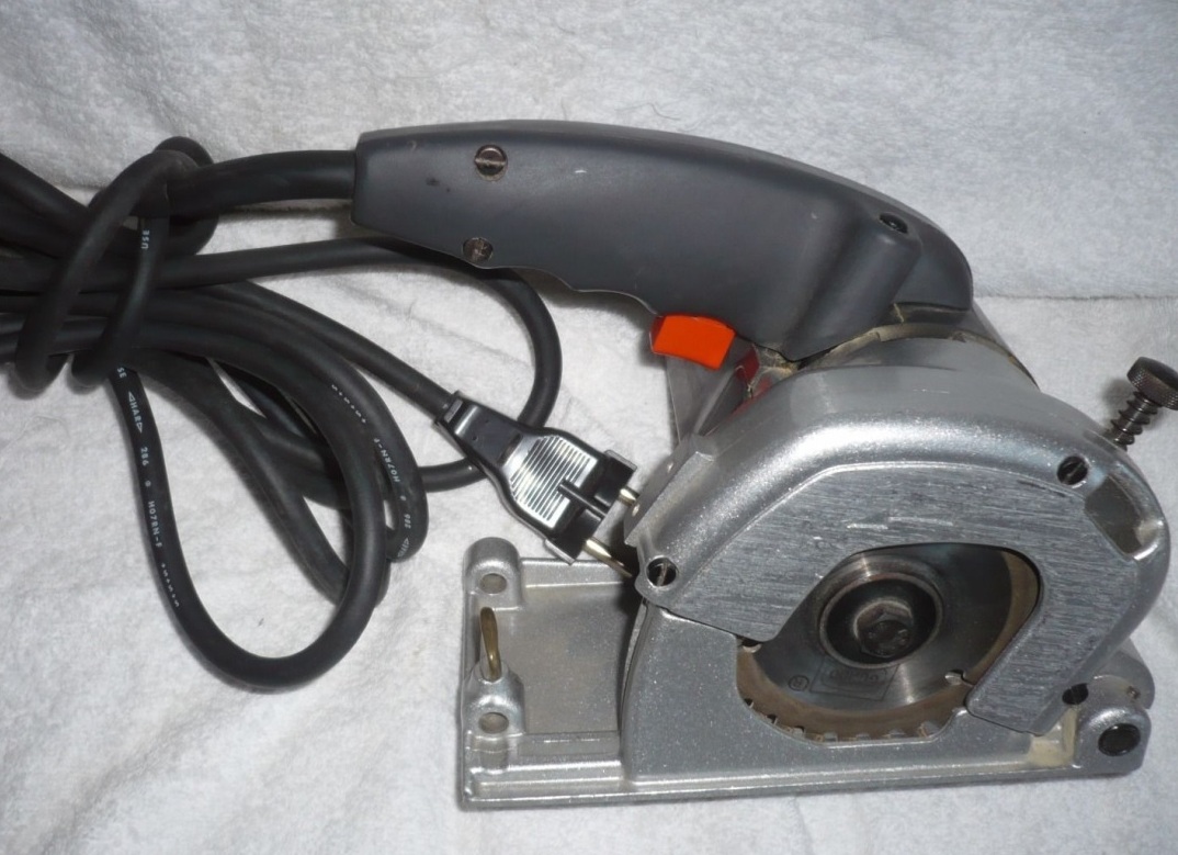

Yes, the Mosquito was a plunge saw and later ones (late 1990s) even had a track system available for them. They weren't the only ones, though. Elu were manufacturing a small 25mm depth of cut plunge saw in the mid- to late-1960s, as indeed were Mafell (there may have been others, not sure). These were primarily sold for rapid breaking-down of sheet stock on site, cutting shadow details on ceilings (the Germans liked planked ceilings back then, apparently), etc
This one is missing the 2-arm side fence you need to cut shadow gap details, but you get the drift, I'm sure
