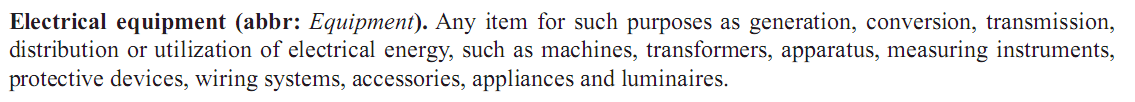

But surely a Soundbar isn't designed to be fastened to a support, or secured in a specific location. I would have thought that it was a portable piece of Electrical Equipment that had the option of being wall mounted.
I had always assumed that 'Fixed installation' was everything up until Socket face plates, and that if something was plugged in to a socket then it was 'Portable'.
If it has keyhole slots, or brackets etc, then clearly it is designed to be fastened to something.
No. Having Key Slots or brackets in this situation means that the Soundbar is designed so that it can be fitted to a wall if the end user chooses to; and that is different to 'Designed to be a component part of a fixed (Read: Permanent) installation'.
Just because something can be attached to a wall, does not mean that it becomes part of a fixed installation if it is.
The Soundbar in question is likely to have a flat base so that it could alternatively be placed on a cabinet or shelf. Therefore, it is not a fixed appliance. It is a Portable Appliance that can be attached to a wall, or placed on a shelf.
Regardless of that though... To quote from www.pat.org.uk "For the purpose of legislation, portable appliances include all equipment that is not part of a fixed installation but is meant to be connected to a fixed installation or generator. Any appliance that uses a flexible cable or plug and socket qualifies as a portable appliance."
