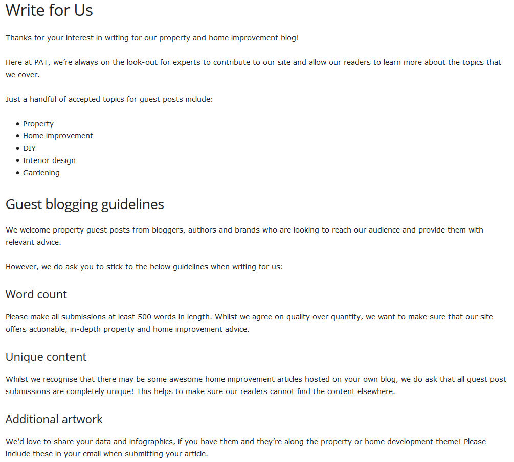

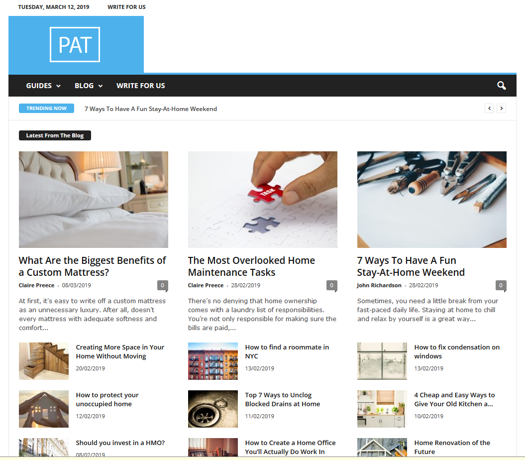

And who is pat.org.uk?
With a home page like this:
what makes you think it is a credible source of information on wiring regulations? Who are they? On what matters can they be reliably considered to be authoritative?
When you click on their "Write for us" link, this is what you get:
And they are a credible source of information on the Wiring Regulations?
