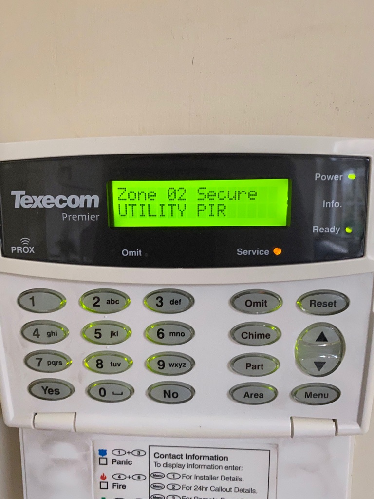

All 6 zones report as secure when system armed.
If I monitor Zone 2 and make movement keypad shows active and if Chime is on Panel gives audio advice.
ok so its changing state

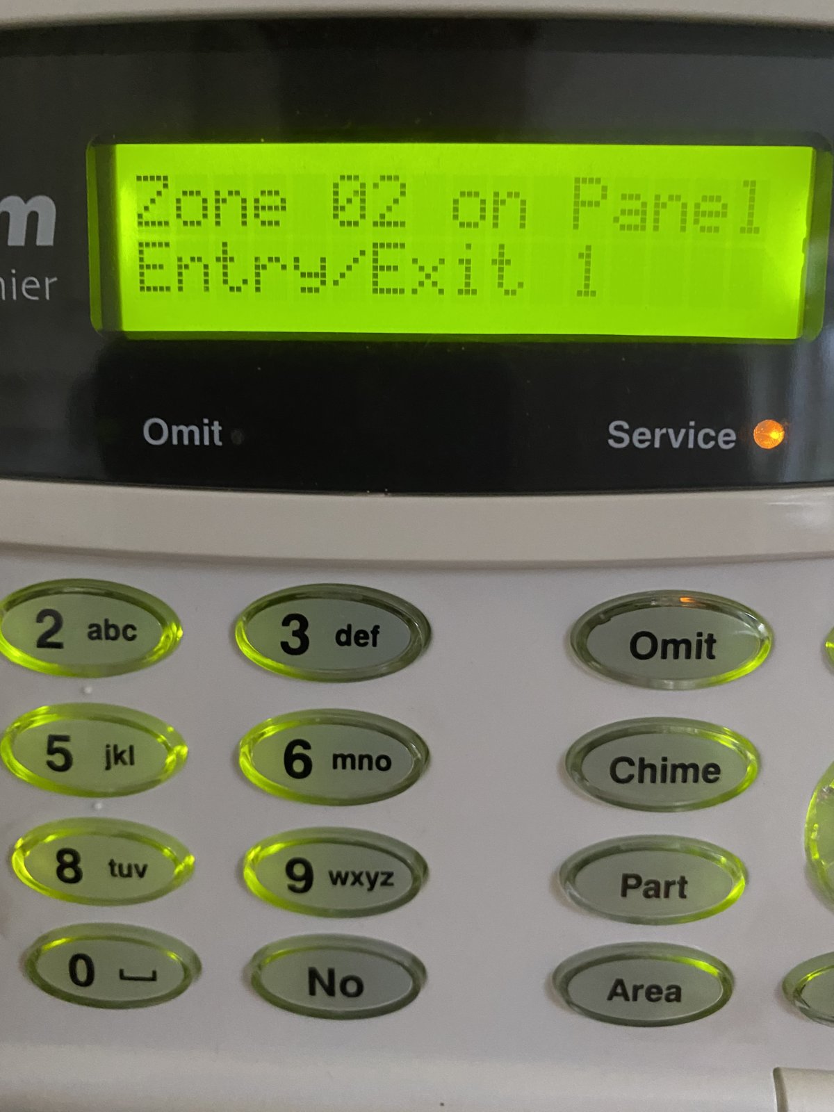

menu menu 1, (zone setup?)
go to zone 2, what does it say wiring type is , what area is assigned what is the zone type
Zones 2 and 6 say same as both entry/exit, other 4 show Guard but don't have number 1 at end. Does that answer question.
so entry exit zones wont cause an alarm until the timer has expired.
if the entry has started then this too affect how the alarm activates.
e/e should be for entry doors only on main entry route
guard access should be for hallway PIR covering keypad, or enroute from an e/e zone to a keypad
the rest should be on guard.
in areas set timer for entry delay to the shortest time you can to allow the slowest person to get there comfortably.
Set the Second Entry Delay to 0. (my mistake should not have included delay)
